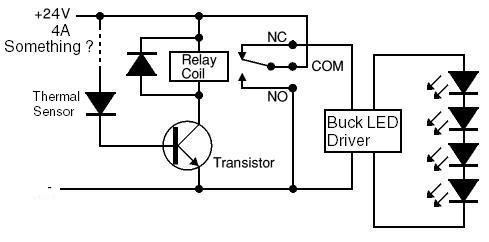

Anyways this is what I have with the relay plus transistor. I still need to limit the current to the temperature diode but that's later.... I can use another LED driver for it as a last resort.

A diode can be used in the configuration shown in the circuit (not as shown in the picture, but reverse-biased so leakage increases with temperature), it would work, but it's difficult to predict. You probably do a lot better with a thermistor instead as temperature sensor.

Your relay shorts your power supply in the NO position.

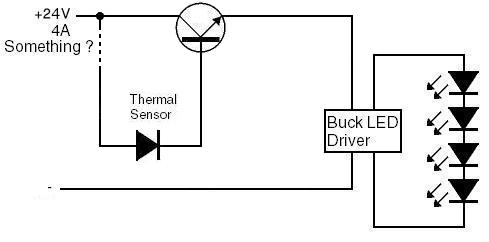

My diode at room temperature (yesterday was hot so about 28*C) had a forward voltage drop of .66V. Generically this device should have a linear change of 2.3 mV/°C. If the voltage is down instead of up then at say 100*C, it should have a forward voltage drop of .495V. In this case could I flip the transistor and use one such that when the voltage drops below .495 it shorts the LED circuit?

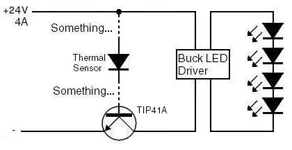

If I am reading the spec sheet correctly for the TIP41A, then I need at least 1.5V going to the base otherwise V(CE) will not be open all the way. So, I need to amplify the voltage from the diode to the TIP41A with another transistor? I revised my drawing again too. You guys have helped a lot so far. :p

Many buck LED drivers have an enable or shutdown pin. You may not have to switch the entire chip.
You really need a comparator like an LM393 for your temperature switching. You can adjust the temperature set point with a pot, and you can add some hysteresis so it doesn't "chatter" at the threshold.
I'm not too worried about accuracy so I think the embedded diode is fine. For example, the max operating temp for the device is 150*C. If the diode can turn off the lights at 120 +/- 20*C or so then I'm fine with that.
Do you mean like the LuxDrive 3021 - it has a ctrl and ref pin. From the datasheet:
https://www.leddynamics.com/LuxDrive/datasheets/3021-BuckPuck.pdf
Where a manual on/off control is desired, the potentiometer in figures 9 and 10 may be replaced by a pushbutton or toggle switch. The output current will be zero when the switch is closed.
I'm back to the first problem if I hook the diode to voltage and a transistor to the diode, ref and ctrl. The switch will be in the opposite position of what I want.
Use a comparator, e.g. the LM393 or LM311, to compare the voltage across the diode with a stable voltage reference.
