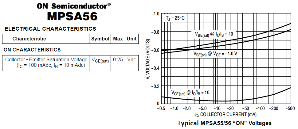

The graph for Base-Emitter Saturation Voltage and for Collector-Emitter Saturation Voltage shows the beta (hFE) is 10, not 100.
The spec's for hFE show that the transistor is a linear amplifier (not a saturated switch) with a collector-emitter voltage of 1V, not 0.05V.
Nearly every transistor needs a very high base current (10 times the hFE) to saturate but a much lower base current (the hFE) when not saturated.
hi agu,
This plot for Vce Sat if from the MPSA56 datasheet, it shows 0.25Vce for Ic=~200mA and a Beta of 10.
Where do you get the 1V from.?

hi agu,

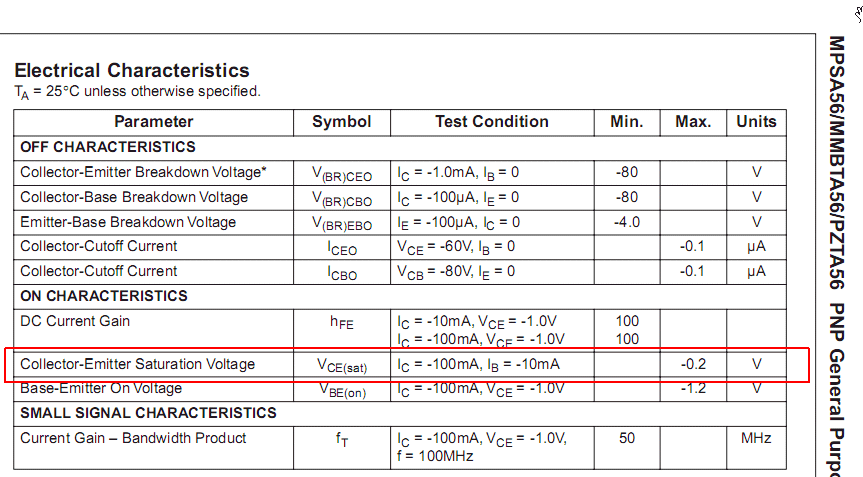

The written spec's say that the minimum hFE is 100 when the VCE is 1V. Many other transistor spec's show the hFE when the VCE is 10V.
the graph was from the fairchild version of the mpsA56, maths is not easy for me but i want to learn it and i want to be able to get correct information out of a datasheet for myself, but it takes time! at least i have great help here guiding me as there isnt any other way at my age to learn this stuff
Motorola invented the MPS line of transistors. Motorola Semi today is called ON Semi so I use their datasheet. Fairchild copied them but frequently a copy has errors in it.
What I don't understand is why take the Hfe of 100 at ~1v Vbe when that's taken from the lowest Temp of -55c. Shouldn't it be taken from 25c which is 150 Hfe ~1v Vbe ?

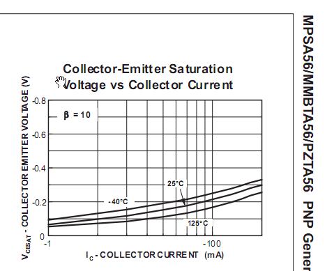

This clip from the MPSA56 datasheet shows 0.2Vce sat at 100mA, with an Ib= 10mA, so extrapolating for IC=150mA I would say Vce is 0.25V.

Never mind, I get it 1/4 of a Volt is equal to around 10-25 Hfe
Edit: So if I pick the lowest side of it to be safe at 10 Hfe when Calculating the Resistance you will still turn it on and keep the current down.

The written spec's say that the minimum hFE is 100 at 25 degrees C.
The graphs show "typical" (which is not minimum and not maximum) and the hFE is about 160 at 25 degrees C. The "typical" hFE at -55 degrees c is 100.
