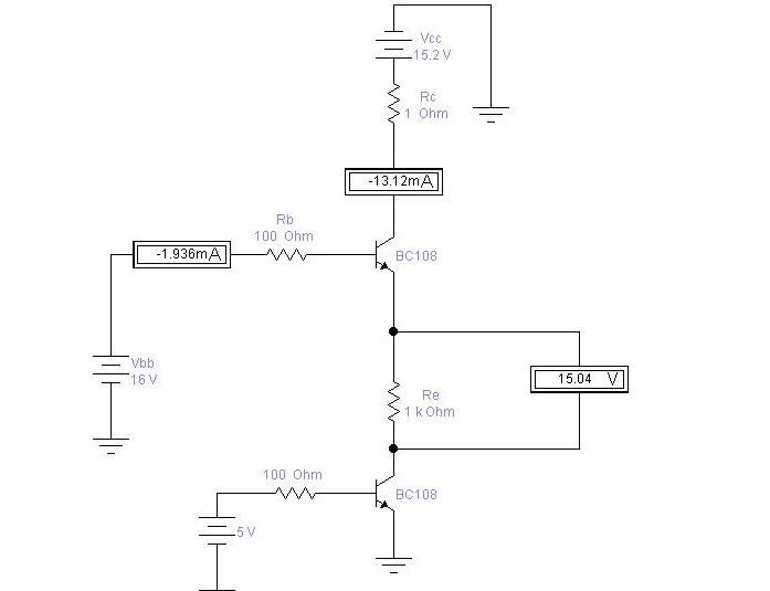

Moreover, mind looking at this circuit
How isit the Ib=1.936mA? From using the Ib=Vbb/Rb, shouldnt it be 160ma?
Im just testing the transistor saturation in this case. Furthermore, is the voltage at the Ve correct? If saturation do occur, shouldnt it be approximately the same as the Vcc?

actually Ib = ( Vbb - Vbe ) / Rb in base-biased amplifiers where Vbe is 0.7 for silicon transistors. but this is the case when the emitter is grounded which is not the case here.

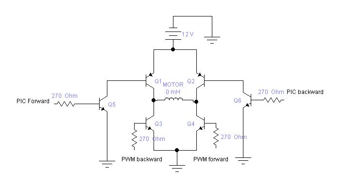

Im basically trying to make a H-bridge driver. The emitter resistor u see there is actually acting as my load(in other words motor). But to make this driver i need a thorough understanding on the transistor.

I just have one question, if i intend to OFF a PNP transistor, is it alright to leave the base-emitter junction floating?
I intend to use 2 PNP transistors at the top of the driver connecting it directly to the power supply. However, to turn off the PNP transistors, the base voltage has to match the emitter voltage. Obviously the PIC voltage to the base would be much lower than the power supply.
Therefore, just to confirm, leaving the base floating wouldnt cause any negative effects would it?

I don't really understand what you mean by this?.
You would normally have a resistor between base and emitter of the PNP transistor (to ensure the transistor turns OFF), with the base fed via a resistor from the collector of an NPN transistor - with it's emitter to 0V, and it's base fed from a PIC pin via a resistor. When the PIC pin goes high, it turns the NPN ON, this in turn pulls the base of the PNP low (through the resistor) and turns the PNP ON.
Actually i did read through the websites. Maybe my question was abit unclear. So what i was actually asking was about transistor Q1 and Q2. If Q5 and Q6 are OFF, wouldnt Q1 and Q2 base be connected to nothing(basically an open circuit)? Therfore, is it alright to leave it like that?
By the way, i require 4 inputs because i intend to use dynamic braking. IF i apply HIGH to Q5 and Q6 it that shold do the trick.
Anyway, just to reconfirm, is my circuit alright or did i left something out
