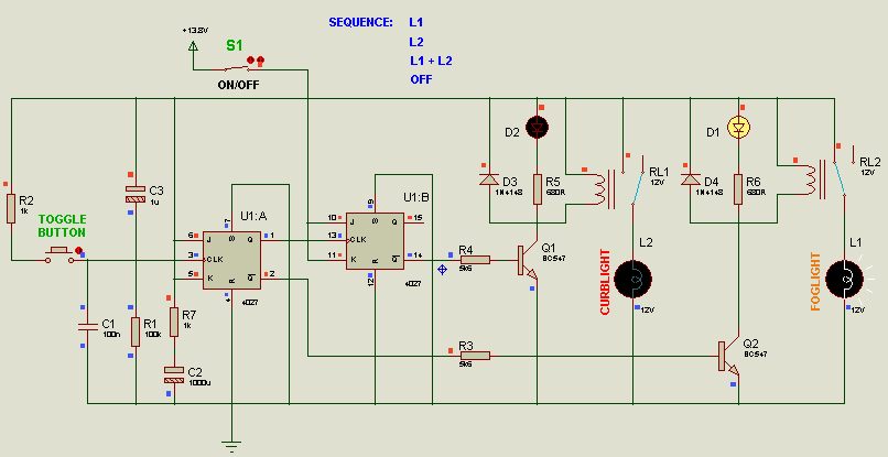

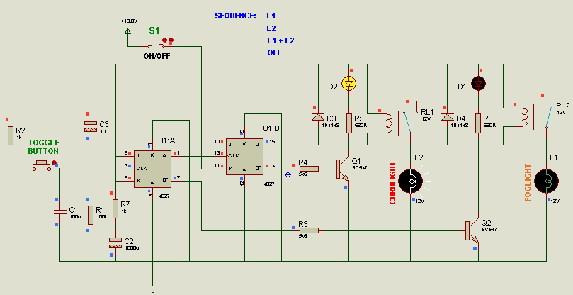

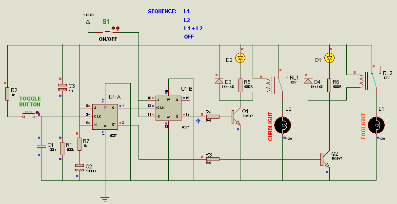

Here is a dual toggle circuit which will probably fit your needs.
Functions: Switch ON/OFF - nothing happens.
1st button push: Lamp1 (L1) - on
2nd button push: Lamp1 (L1) - off, Lamp2 (L2) - on
3rd button push: Lamp1 (L1) and Lamp2 (L2) - on
4th button push: both lamps off again.
Use a low drop voltage regulator (12V) and some means of filtering to protect the CMOS-IC from alternator spikes.
Connect the lamps directly to the relays which are also connected directly to the car power supply.
I guess using indicators (LEDs) is not a bad idea.
Attached are three possible switching conditions (Off is omitted).
Regards
Boncuk
Edit: power supply pins of the IC are not shown in schematic. Pin8 connects to ground and pin16 connects to +12 (13.8V).

Wow, Thank You Bonkcuk for the quick reply and thorough diagrams.
What you propose is very sophisticated and if I read the schematic correctly, still requires an additional switch (the toggle button) to be run through the firewall (something I'm attempting to avoid). Also, I apologize if I didn't make it sufficiently clear, but the fog light do not need to have an off state with the curb lights on.
