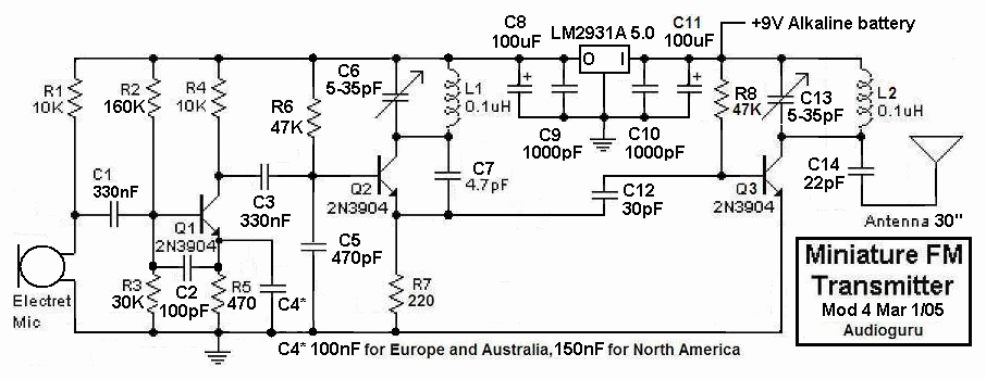

30 guage wire is awful darn small for a VHF inductor. I have never heard of using an iron core for such a high frequency.
I used 9 turns of 1mm enamelled wire tightly wound on a 3mm former. The end wires have exactly 0.4" spacing and I spaced these air-core inductors about 2mm above the board. Even though I used Veroboard, my layout was tight without any extra track lengths so my wiring was extremely short, like a pcb.
My Walkman radio usually works very well but overloads causing the transmitter to be all over its dial when closer than about 10m to this powerhouse FM transmitter unless I switch the radio's input attenuator to "local".
For Mod4, I reduced the gain of the preamp for even lower distortion, more pre-emphasis boost and simplicity. I added a low-dropout 5V regulator for powering the preamp and RF oscillator.
It works great, but sorry, it is still too cold outside to measure its range.

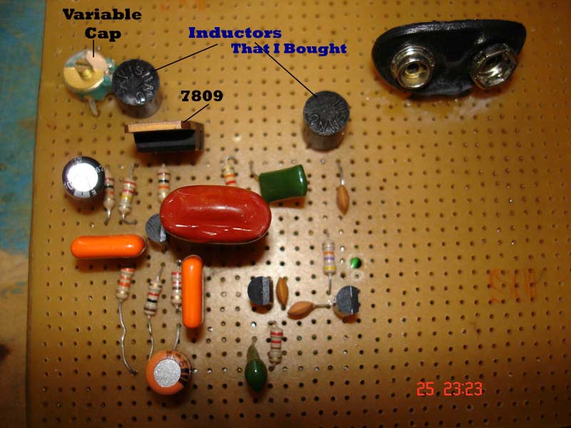

I found a place where they custom-make inductors of any desired value. So I got two .1 uH inductors made. So now I don't think I should have any problems with the inductors.

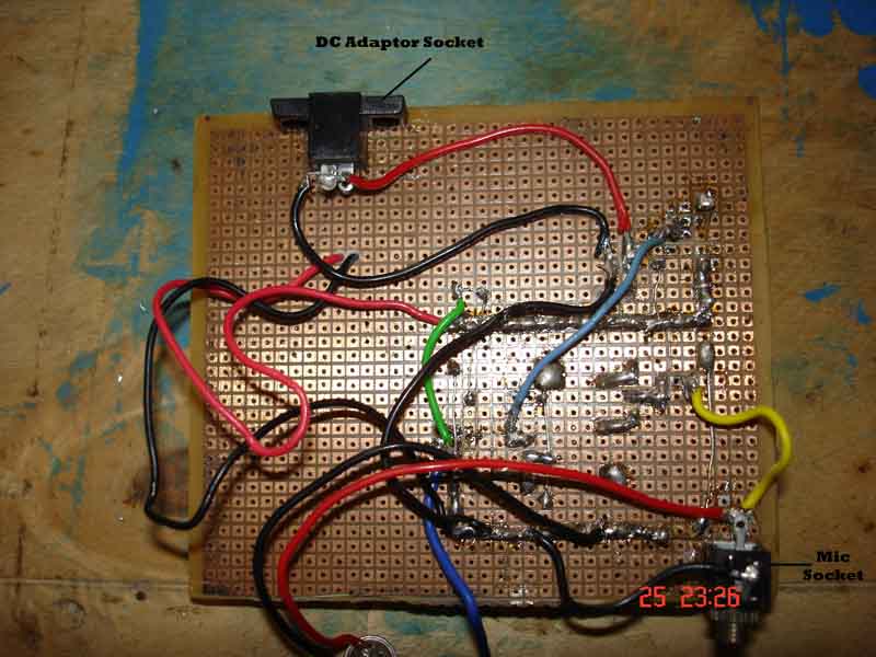

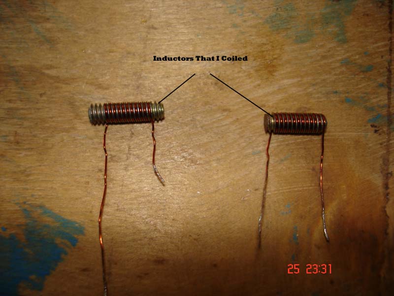

I've also posted a photo of the Inductors that I coiled and a photo of the electret mic and antenna. The antenna should have it's insulation on, right? And does the mic look OK? There r no ill effects of using the wall outlet for the supply, are there?
Just to clarify, on the solder side of the board, the wires that you see are the supply wires, mic and mic socket wires. Other than those most of the connections have been made on the board itself.
Audioguru, I built this circuit b4 u posted ur mod4 circuit. I'll make the changes that you have made from the mod3 version, but first, this circuit should also work, right?
The board doesn't work with the new inductors also. U say that I shouldn't use a Walkman to test the board? I don't have any attenuator setting on my Walkman.
Any suggestions?

I agree with everyone else, you shouldn't leave a core inside your coils, this will massively increase the inductance - they should be air-cored coils.
I'm also not suprised your board doesn't work, it's very badly laid out! - at VHF layout is critical, your design is spread all over the place. In particular the coils, they are no where near the transistors - this is probably the most critical part of the circuit!.
Actually, I just followed the layout of the circuit given, except for the L and C as they required a little more space. So I placed the L and C at a different place. I thought that only the L and C needed to be next to each other for proper resonance. I didn't know that the transistor needed to be close too. Could you please give me the reason for this?

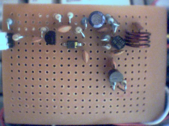

Place the components as close as possible. Avoid long wires. See component placeement in my varactor tuned FM transmitter below.
Have you checked whether the capacitors are of nearly same value that your want? If not check them using LCR meter or cap. meter in your multimeter (if present). Even polyester capacitors have large tolerance. Last week I got few 6.8nF polyester caps and when I measured their value, they were all measuring between 33nF to 46nF!!!! Thats no where near 6.8nF.
The case is even worse with ceramic capacitors. I once read tolerance that was mentioned on the packing bag of caramics. It was 80% !!!!!
So its always better to measure and then use capacitors when working with radio circuits.
Your circuit may not be working due to this also.

Thanx for the photo. It helps. As Nigel said, my reactive components are nowhere near the transistor. Yours is.
Because you are adding extra capacitance and inductance into the circuit with the long wires, this circuit is extemely crude, there are many components which affect it's operating frequency - not just the LC tuned circuit.
VHF inductors are so easy to make that I have never purchased any. Your purchased inductors might have built-in capacitance that is far too high.
Sorry, the 0.1uH value is not measured, just a value and construction recommendations stolen from another website's project.
Likewise, most of the small caps that I used weren't measured, but stolen from old radios. My cap that is marked "30" is probably somewhere near 30pF.
Your layout has parts so far apart that the capacitance and inductance of the wiring probably far exceeds the values in the circuit.
I'll try the inductors that I made, without the iron cores this time.

When you unscrew the core the enamel will be damaged and the turns are too far apart. Make new coils tightly wound on a smooth former. Use 1mm thick wire because it doesn't change its size when bumped and has lotsa surface area for very high frequencies to travel due to the "skin effect".

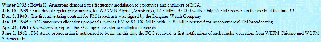

Hi Guys,
I have erased a lot of my old attachments on this site so now I am allowed more.
Here is the history of FM according to an American guy:
