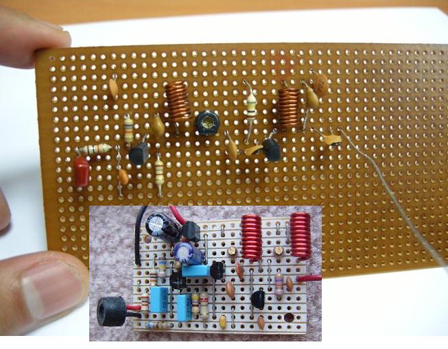

My FM transmitter works fine with a 9-turn closely wound coil made from 1mm enamelled wire on a 3mm former, and also this project from where I got the idea:
Hi, I am trying to build this circuit (project 54) using veroboard.
Can you give advice on the component layout and spacing :
Your parts are way too far apart. The traces connecting the parts have too much inductance when they are so long.
The traces must be cut to length so that extra length is not a capacitor to a trace beside it.
Mine has many more parts and is still much smaller than yours.

Thanks a lot for your comments!
Besides this problem, I concern about other things as well:
- How about relative position of the components ?
- Let's say we have to use wire to connect 2 points. The wire should be in the metal side,right ? (Veroboard has metal side and non-metal side). Then does the length of this wire affect the performance of the circuit)

At VHF layout is critical - everything will affect performance.
Normally wires are placed on the plain side of veroboard.
As Audioguru has posted (many times) a fully working example, why not simply copy that?.
Most resistors and capacitors jump from one copper trace to another, but jumper wires are used on the plain side of Veroboard (not on the copper side). Look at the jumper wires in my pic.
