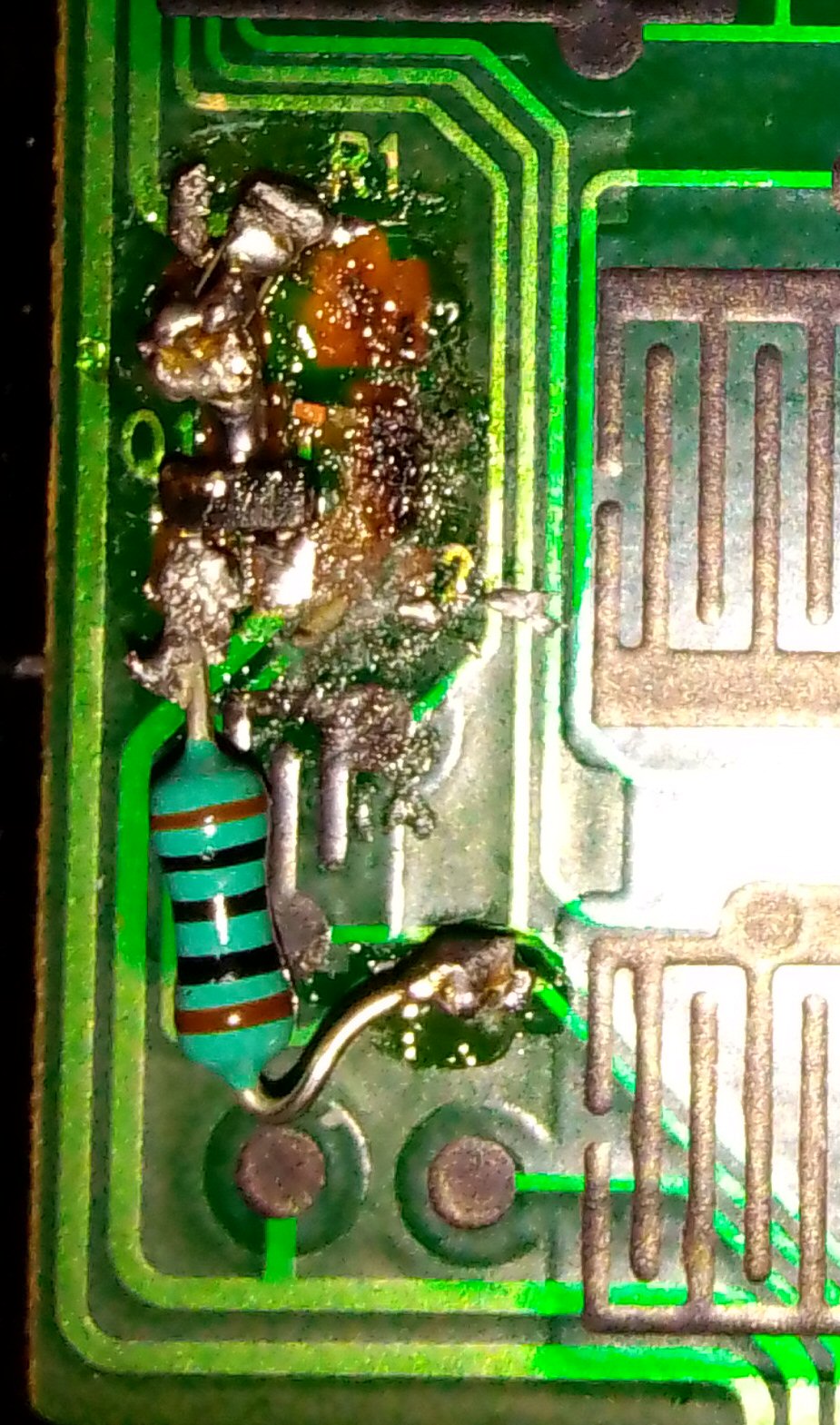

I have tried to solder copper tape to trace, but with no success. Tape came off beacuse of iron heat, and I couldn't hold it in place, it was just too small. Perhaps I should've used super glue.
I decided to use 1/4 watt resistor of 100 Ohms and I joined it from lower trace to left leg of transistor. Because of that I couldn't use mute button because resistor is over the button switch
You should have just used tiny wire ended resistors, as I suggested way back - 1/4 watt is far too large.

There wasn't any available in electronic shop.
Too bad I couldn't solder tape to trace, I would've easily solder SMD resistors, now I know how.
I did solder top SMD 2R70 though, but it seems like pad wasn't conducting, probably top layer lost conductivity or something.
I could've done this also: solder SMD resistor to left leg and solder jumper wire from resistor to trace, that would be better.

Definitely, I learned a lot from this remote.
I have found out what's wrong with it by myself, after some time spent learning how things work, and how to check components, traces...
Also, I've run into SMD soldering for the first time.
By the way, I was unlucky that my multimeter needle wire broke also, so I soldered that too also.
All in all, I have gain some valuable experience, and hopefully will be easier next time.
I am thankful for the support from the forum members, it's really a great place for looking help.

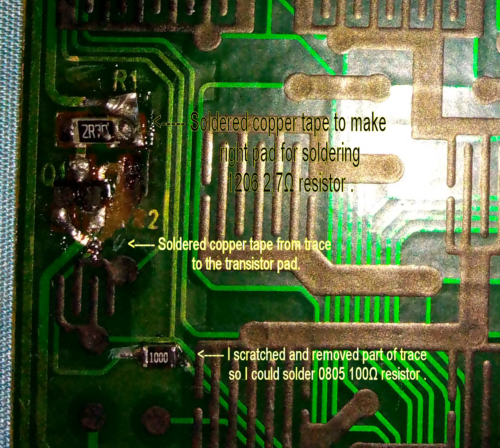

I have done rework of remote fix, and this time I have fixed it properly.
I didn't have proper tools for SMD before and I soldered resistor over the Mute button which I couldn't used then.
I have bought new soldering station ZD-99, 4 new tips, 0.5 mm solder wire, tweezers, flux for SMD and IPA.
These tools enabled me to do a much better soldering then before.
I can use now Mute button too on a remote.
This is the rework:
