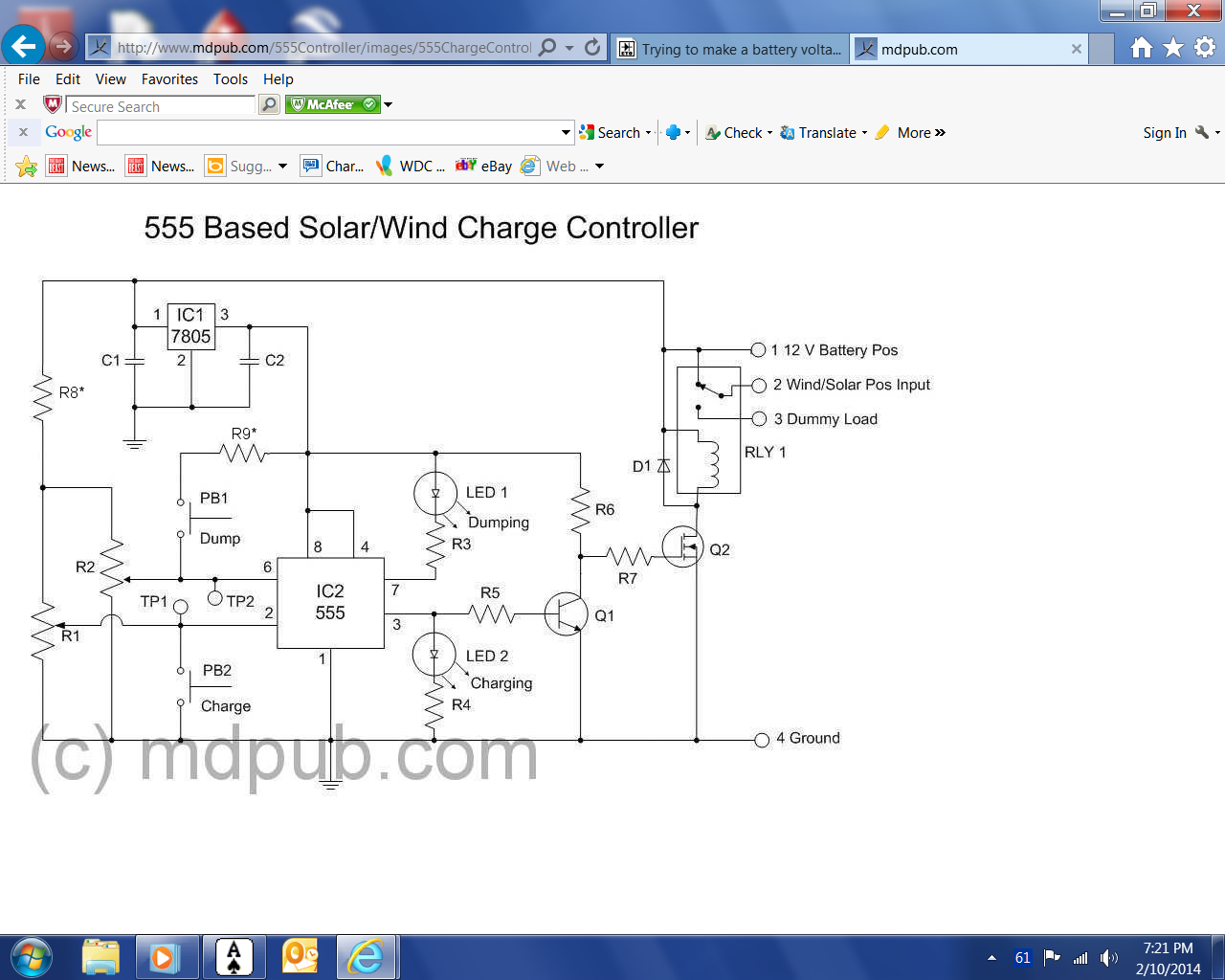

After a few different circuits which I could never quite understand I have settled on one at https://www.mdpub.com/555Controller/index.html.
It uses a 555timer so The flip flop on 1/3rd and 2/3rds voltage seems to work well.
I have some different needs though.
It is for 12 Volts . I want it to control 24 Volt systems with 30 volts in, and a 48 Volt system with a 80 Volt in ,from solar panel.
This circuit switches a relay on when it gets to its peak setting.
I want it to control a Mosfet and turn it off when it hits the top setting.
I am asking for help to firstly convert it to Mosfet switching off and also suggestions how I might change the circuit to control the higher voltages.The lm78l05 can only tale 15 volts max and a lm78l08 is limited to about 20V I think.so maybe a 317 which can take a 36V max might be used or maybe an entirely different approach might be warranted?
All help will be appreciated .Thanks

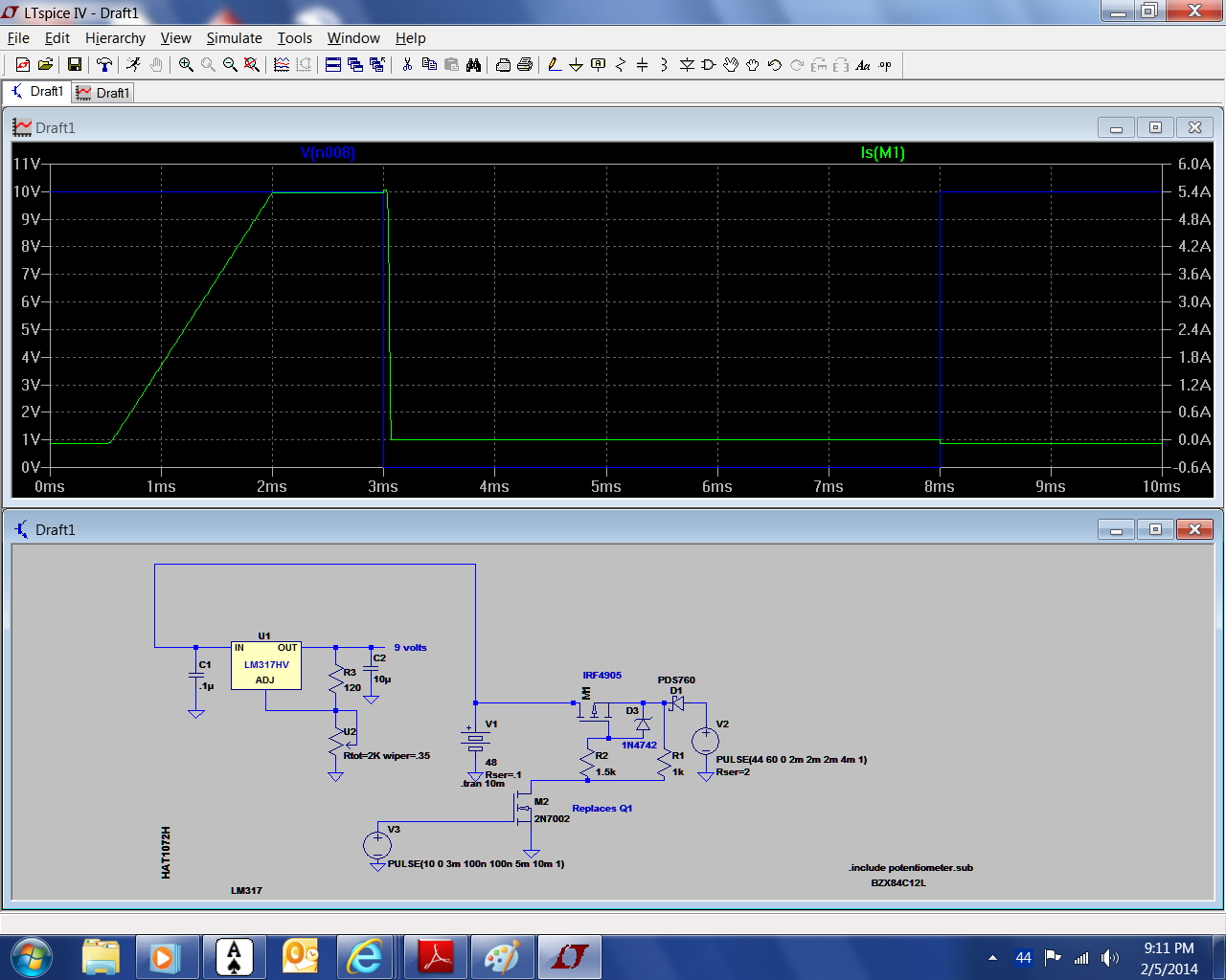

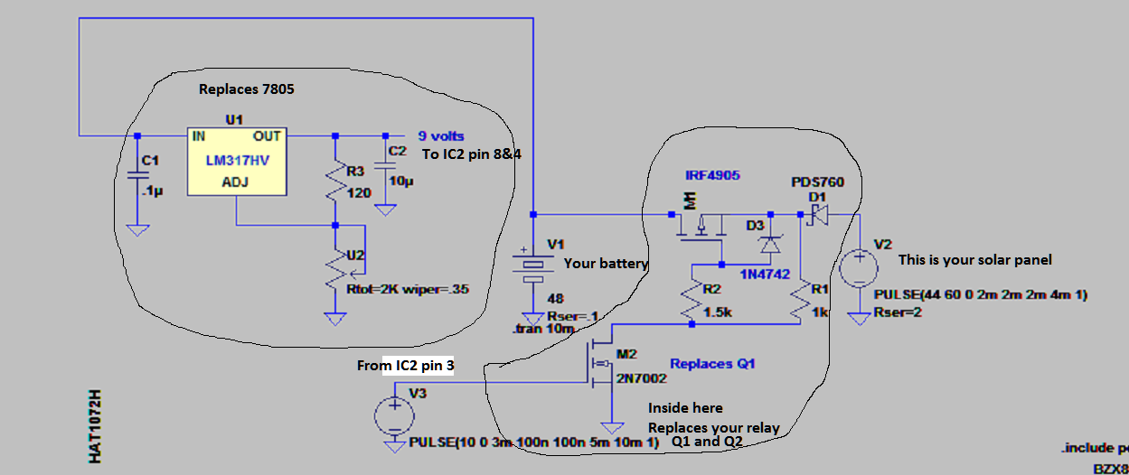

Here is one I think will work. You can use the LM317HV for the regulator. Make sure it is HV. I raised the voltage to 9 volts as the regulator is only specified for 60 volts input to output. So you will need to make your adjustments a little different than in the write up. 9/5 higher.

I had a lot of trouble understanding this . Is it possible to get a complete circuit showing where the 9 volts and other voltages are connected?
I'm not sure if I have made it better or worse, but lets see.
There are 2 parts: The 317 replaces your regulator (7805)
The rest replaces the relay Q! and Q2.
Hope the bigger picture helps.

OK thanks that is more understandable I think so the 317HV can accept a higher input voltage and feed 9 Volts to the circuit .The Solar panel then feeds through a MOSFET to the battery with a blocking diode ?.
Pin3 goes high and turns the transistor 2n7002 on which turns the MOSFET on . Is that how it goes? or is the 3 pin going low that activates the rest ?

I have not used LTSpice for years but it seems that you have it set to 44V? or is that 60?
Yes, the 317HV can take 60 volts max from input to output. I figured maximum battery voltage of about 58.4. So there should be 10 volt safety margin.
Pin 3 going high turns it all on as it was before.
The 555 can take up to 15V input voltage so maybe I could adjust that to !5V
The solar panel is putting out 80Volts !
You could. Or maybe 10 volts would be an easy number to work with.
I missed the open circuit voltage of 80 volts on the panel. You will need to change the 7002 to a 100 volt FET-say an FQU13N10LTU.
[quote[I have not used LTSpice for years but it seems that you have it set to 44V? or is that 60?
I set the battery at 48 and ran the panel from 44 to 60. The battery will clamp the panel below the set point of the circuit.

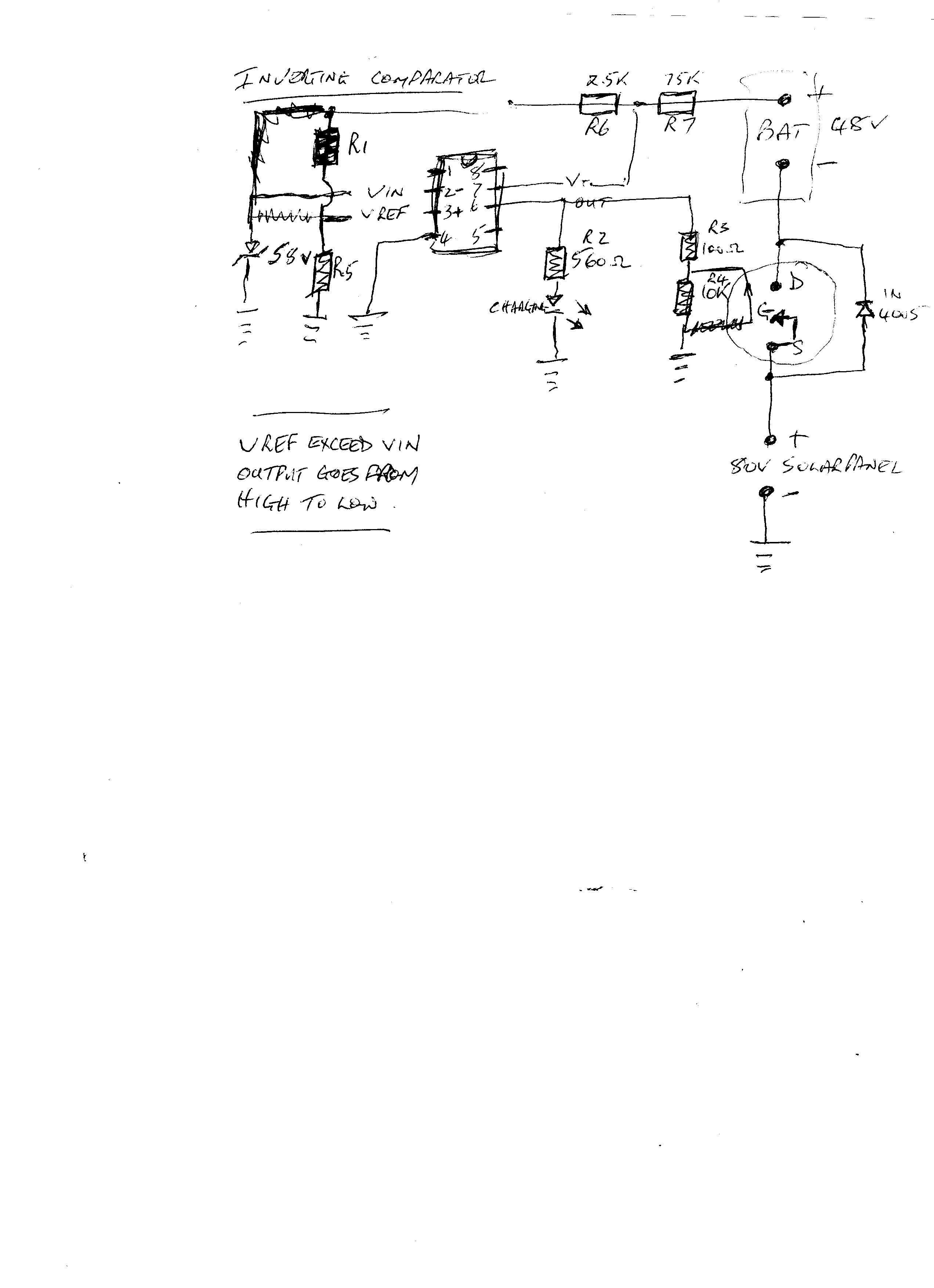

Sure its stuck i am now trying to get a comparator circuit going i am ending up with a more complicated circuit than a 555 timer based circuit.
I attach a sketch so far and any comments would help thanks
I would first try connecting the panel directly to batteries and see if you like the results. If you don't, then I would do the circuit.
You certainly need to connect + of the panel to + of the battery, not other way around. I think you had the correct schematics of this part earlier in your posts.
It would be nice to have some sort of voltage regulator for the comparator. I would feed it from the bottom 12V battery rather than from the whole bank. This way, a 7805 or 7809 regulator will work.
The R1/R5 divider will drop the battery voltage to some 0-5V levels, say 20 times, so the voltage reference needs to be translated to this level too - say 2.9V instead of 58V.
A hysteresis resistor from the +in of the comarator to the out of the comarator is needed. Something around 1M perhaps. It will prevent fast switching at transitions.

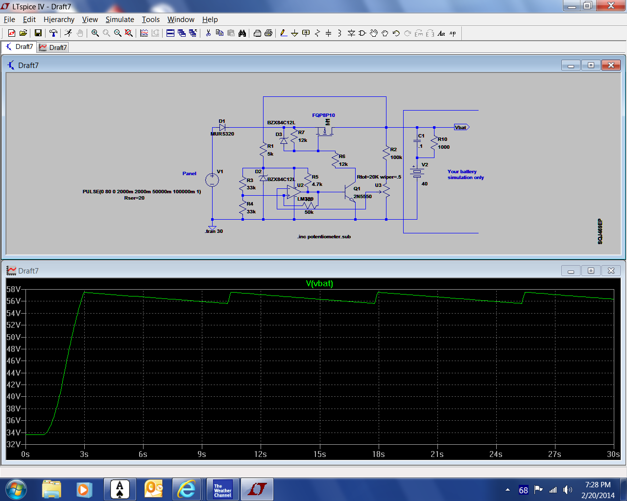

I'm attaching a schematics of my micro charger. It probably has more parts than necessary. And this is totally different scale, but it can give you an idea.
Here is another without any temperature compensation.
Uses a little zener regulator so now worries about the voltage.
Where it is set now it turns off at about 58 volts and back on at about 56. You can adjust the pot to set the trip point to about 57 volts or so.... Just under the gassing voltage.
