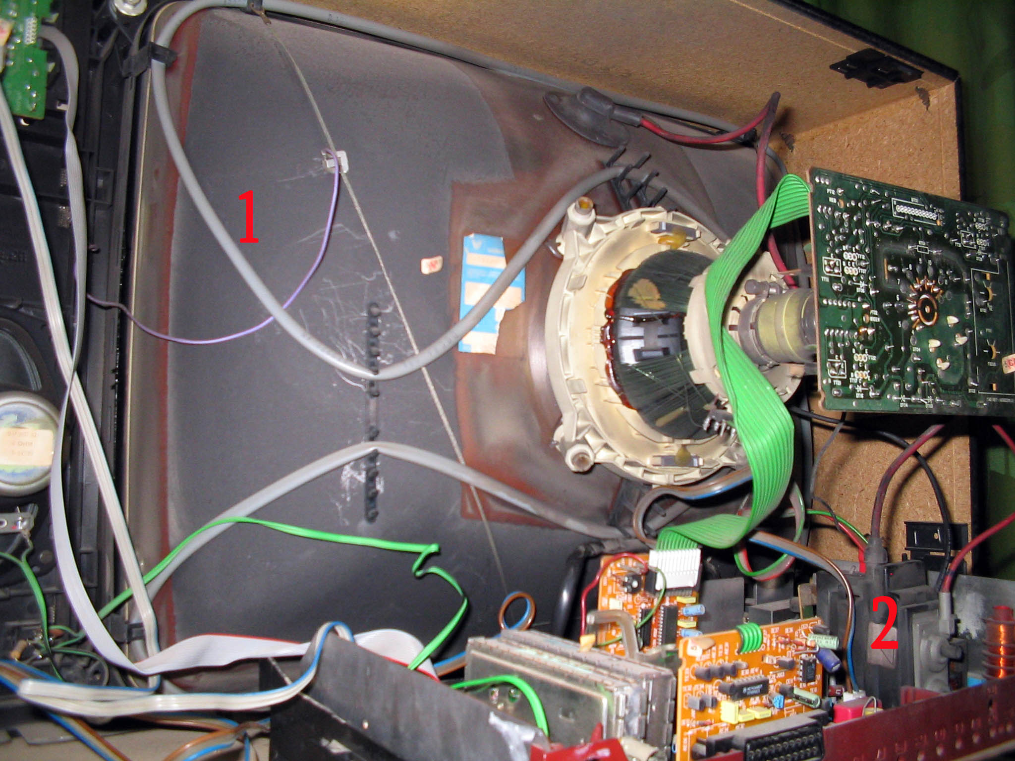

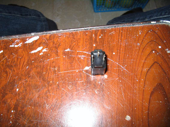

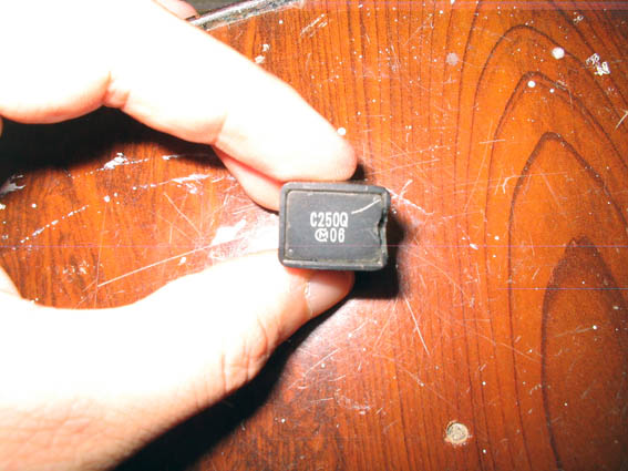

I have TV that don't work. when I turn it on the black component get worm, what is this component? should it get worm? this componnent take a place after LP before diode bridge.
around the screen there wire (number 1), this wire connected throught the black component, what is this wire? who needs it? what is it's role?

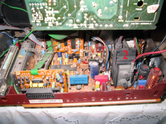

number 2: what is it? what can I adj with thus 2 pots???

It's a posistor, it's only function is to deguass the CRT at switch-on, and it's meant to get HOT - not just warm, HOT!. The set will work without it.
It's the deguass coil.
Presumably you mean the LOPTX? (Line Output Transformer), the top one is the focus, and the bottom one the first anode - you shouldn't adjust ANYTHING unless you know what you're doing.
As Audioguru says, there are high voltages present, and it's no place for random 'fumbling' by complete amateurs.
From the picture, the set looks to be a Thomson chassis?, these are generally badly thought of and very unreliable sets.
