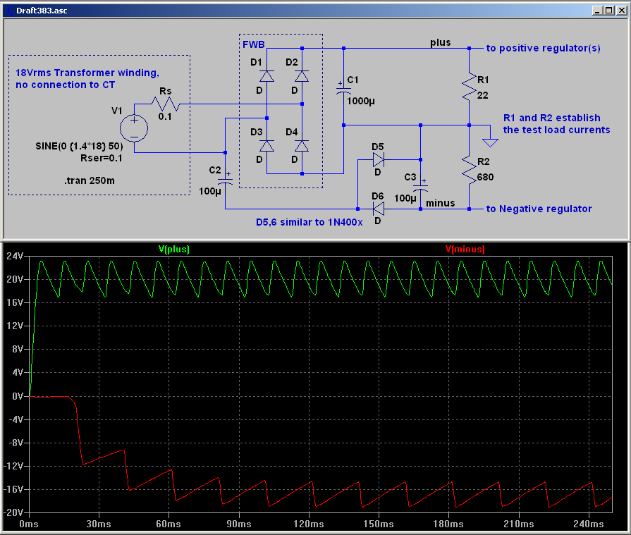

Here is another way you can still use your existing 18V transformer. This uses full-wave rectification for the high-current 12V output that drives the PA. Half-wave rectification (charge pump) is used to get the unregulated negative voltage. As long as the -9V is lightly loaded, this should work... Watch the power dissipation in the 7812. It will have to mounted on a big heatsink...
Plenty of head-room for all three regulators...

Mike,
Rs (0.1R) and R1 (22R) are pure speculation: you do not know what the equivalent source resistance of the transformer is, nor current load on the 12V supply line. ...
Not pure speculation. I have been around the block before, so I can make a reasonable guess for the effective source resistance of a "small" transformer...
Besides, the specific value is not that critical.
As to the expected load current, I am assuming that the +-9V supplies are lightly loaded (<50mA), but the +12V supply runs an audio amp connected to a speaker, so requires at least a few hundred mA...
Here is a sim of the half-wave approach. Note how I connected the FWB. At the test currents shown and with C1=1000uF and C3=100uF, there is just enough head room to keep the regulators from dropping out. If Andrew can tell us what the load currents are, then we can come up with the required minimum values...
Making them bigger than required just increases the heat dissipation in the regulators with no benefit...
Not pure speculation. I have been around the block before, so I can make a reasonable guess for the effective source resistance of a "small" transformer...Besides, the specific value is not that critical...
Here is the sim repeated for different values of Rs = 10mΩ, 20mΩ, 40mΩ, ..., 320mΩ. Doesn't have much effect on V(plus), eh?
