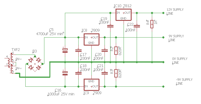

Here is a circuit to overcome the low voltage of the transformer.
The two lower diodes in the bridge rectifier are not used and can be removed if you have a discrete bridge.
What bridge rectifier are you using?
Make sure that the reservoir capacitors are at least 25V working voltage.
You can make C5 1000uF to try the circuit, and it could be that a 1000uF reservoir capacitor will do when your amp is connected to the 12V supply (you still haven't told us what the amplifier is, or is it a secret.:))

Hi Spec I am building this. Those 330nf if polytene caps ok? Cause I don't have ceramic.
Thanks for your help.
Today I finished the circuit +9v/-9v were ok but on the 12v side only 4.6v is coming.
Is this maybe cause I used a 1000uf cap instead 4700uf?
Any help please?
Is that with the amplifier connected to the 12V supply?
Does the 12V regulator produce 12V off load?

There is something in the transformer cause when I tested voltage only 2v was coming from red to blue wire and from 9v the center wire.
Time for a different transformer I think. Get a nice toroid.:)

Today I connected the circuit as it should be and at one time it worked ok but after a while the 1000uf cap got very hot and got swallen releasing a very nasty smell.
did you happen to check the temperature of you lm78xx chips
Hi kinarfi I did not notice that 78xx were getting hot.
You need a high ripple current reservoir capacitor. Also change the value of the 12V capacitor to at least 4,700 uF and at least 28V. This would be a good choice: https://www.digikey.co.uk/product-d...onics-cde/SLPX682M035A7P3/338-1645-ND/1882122
spec
I changed the cap to a 50v one but when I switched on no voltage was coming to 12v now maybe 7812 burned. I try to change the chip and as you told me put a 4700uf instead of 1000uf.
As well as the working voltage, the ripple current rating of the 12V reservoir capacitor is also very important . Special heavy duty (big and heavy) capacitors are made to handle the high ripple currents found in power supplies. The ripple current rating of the -9V reservoir capacitor is not a problem because the current drain on the -9V supply is very low.
I suspect that there may be a thermal fuse built into your transformer and that the fuse is cutting in and out. Is the transformer getting hot?
The 7812 will not get damaged by over-temperature because it has built-in temperature protection. It will merely limit its output current. I would get the power supply working without a load to start with.
In the final power supply the 12V regulator will need to be mounted on a substantial heatsink using a TO220 mounting kit (but use an aluminum oxide insulating washer rather than mica or plastic) to keep the 7812 cooler. You do not necessarily need a dedicated heatsink: often the metal case of an equipment can be used.
Also, a power resistor may need to be connected between the positive terminal of the 12V reservoir capacitor and the input to the 7812.

You mean If I don't put a power resistor the readings would be false? What resistance and power should I put? Thanks
