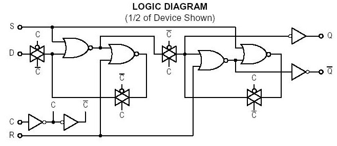

hello,
I have looked at ten or twenty different data sheets for the 4013 Dual "D" flip-flop and none of them show EXACTLY how they work. Specifically, I need to know how "set" and "reset" are accomplished. Every data sheet I looked at just shows a strange symbol I'm not familiar with. I tried following the truth tables, but I get confused too easily. Is there a complete NAND gate equivalent circuit I could follow? Anyone have anything else that will help? Thanks.
Check out the truth table in this datasheet: https://www.fairchildsemi.com/ds/CD/CD4013BC.pdf
If Set is asserted (high) and Reset is not, then Q is high and Qnot is low.
If Reset is asserted and Set is not, then Q is low and Qnot is high.
If both Set and Reset are asserted, both Q and Qnot will be high.
Set and Reset work independently of the other inputs, i.e. they don't care what's on the Data pin and they don't need the Clock.
Maybe this help for You...
