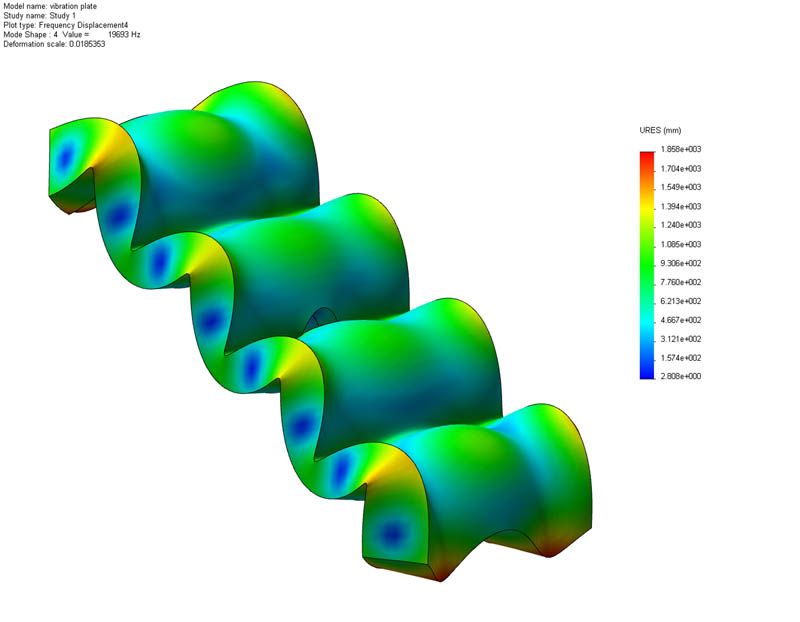

I was under the impression that Chladni plates needed a sine wave to reduce the other harmonics...
If I'm wrong, that would be great....
The plate... It's not exactly thin... (~310mm x 140mm x 18mm)... almost 2 cm thick aluminum...
And here is the FEA sim @ ~19,650 Hz ...
Michael

Well, I'm not sure about that. The frequencies are in the audible range though, at least for the less complex patterns. Here is a youtube clip of the effect.
https://www.youtube.com/watch?v=MPcJbb5Qfj0
It seems to me that a square wave would do the same that a sine wave would do in this circumstance because essentially you are just hitting the plate with a large compression wave. 18mm seems really thick to me, might dampen the wave a bit.

Goldsphere.... I'll have to do some homework on that... I assumed that if I was driving extra harmonics the total power at the specific frequency would be lower... I'll find out and post my conclusions...
