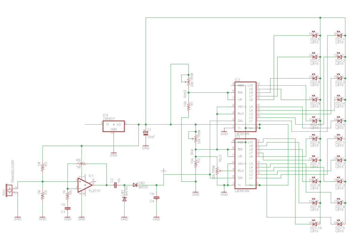

OK, What about something along these lines?
I'm not 100% on how to rectify it, and obviously no idea on voltages yet so every value (including how much to amplify it) is open for adjustment. I've added two LM3914's to give more resolution to the output and tied the low of the second to the high of the first, both with their own reference high's trimable (again trim values are open to change). The amp is a basic LM386 with a Amplifier Gain of 20 as per the doco.
Let me know your thoughts.
Cheers

You don't use an LM386, that's a power amplifier - not an opamp.

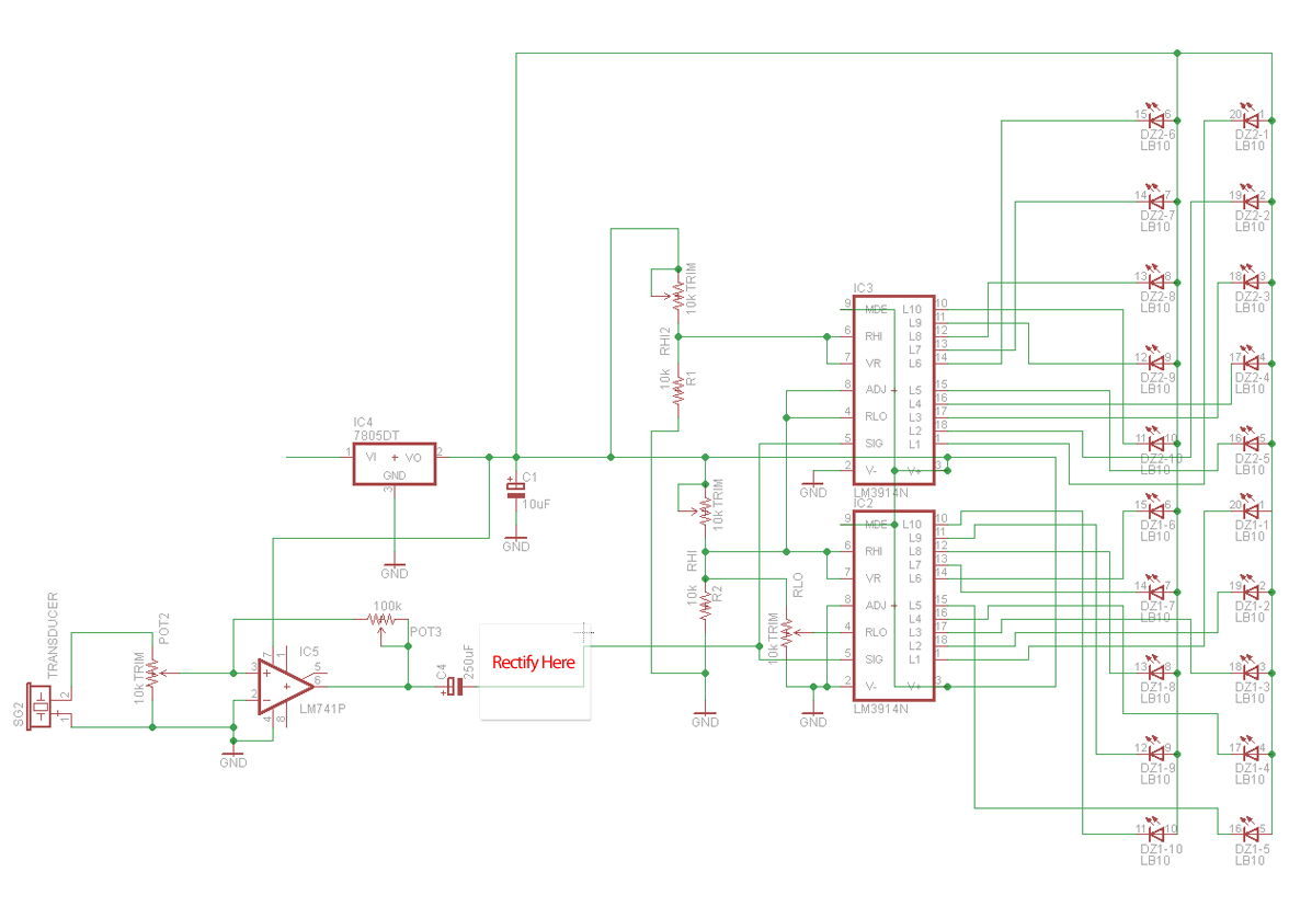

Ok, What about something like this? Updated with the LM741, I am not very used to using a LM741 for this purpose, so please let me know if the "gain boost" circuit I've done is suitable or will even work at all :| . Also what sort of rectifying do you think would be suitable here?

Before we worry about amplification and rectification it would be wise to know what it is that we are going to amplify. You mentioned a DSO so when time allows take a good look at the signal you get from the transducer. Once you know what you have (in detail) then we can worry about amplification and rectification. While the 741 may work the op amps like the TL081 would be a much, much better choice. It offers a nice high impedance J FET input and if the transducer is typical low impedance out they could make a nice marriage. :)
The 741 is an antique low-spec device, the main problems for this application are it's low input impedance, and it's low gain bandwidth. Your circuit also is compeltely wrong for wiring an opamp - try checking the opamp 'sticky' at the top of the General Electronics Chat forum.

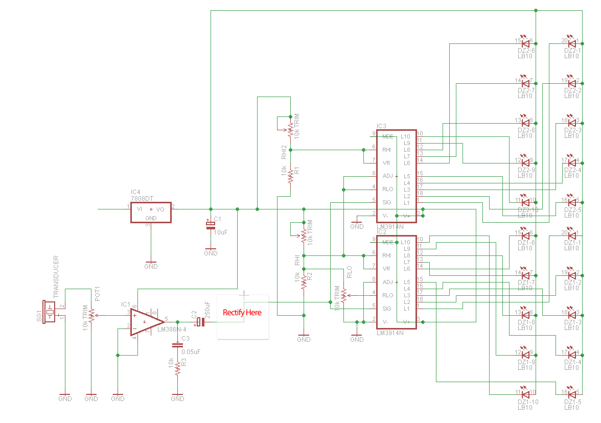

Ok so here is the latest, as I haven't got the specifics on the strength of the signal from the transducer as yet we can't be sure that this will all work as planned perfectly however it's a good starting point. What do you think? Any issues you can see here?
I will have to meassure the output voltages from the TL071 on the signal to figure out what the ranges should be set to on the LM391 chips and no doubt that will mean pot and resistor changes there, but other than that it all should work?

Per Nigel you can reduce the 1 Meg resistor to reduce gain. However, if you have a 1 Meg pot you could place it in series with a 1 K resistor then adjust the gain once you see how the transducer behaves.
Ron
The 741 opamp is 43 or 44 years old and was designed to operate ONLY from a plus and minis 15V supply (30V total). Yours has a 5V supply.
Your circuit operates near 40kHz but a 741 opamp has trouble above only 9kHz. Most good opamps work well up to 100kHz.
The input bias voltage of a 741 opamp must be near half its supply voltage but yours is at 0V where it will not work.

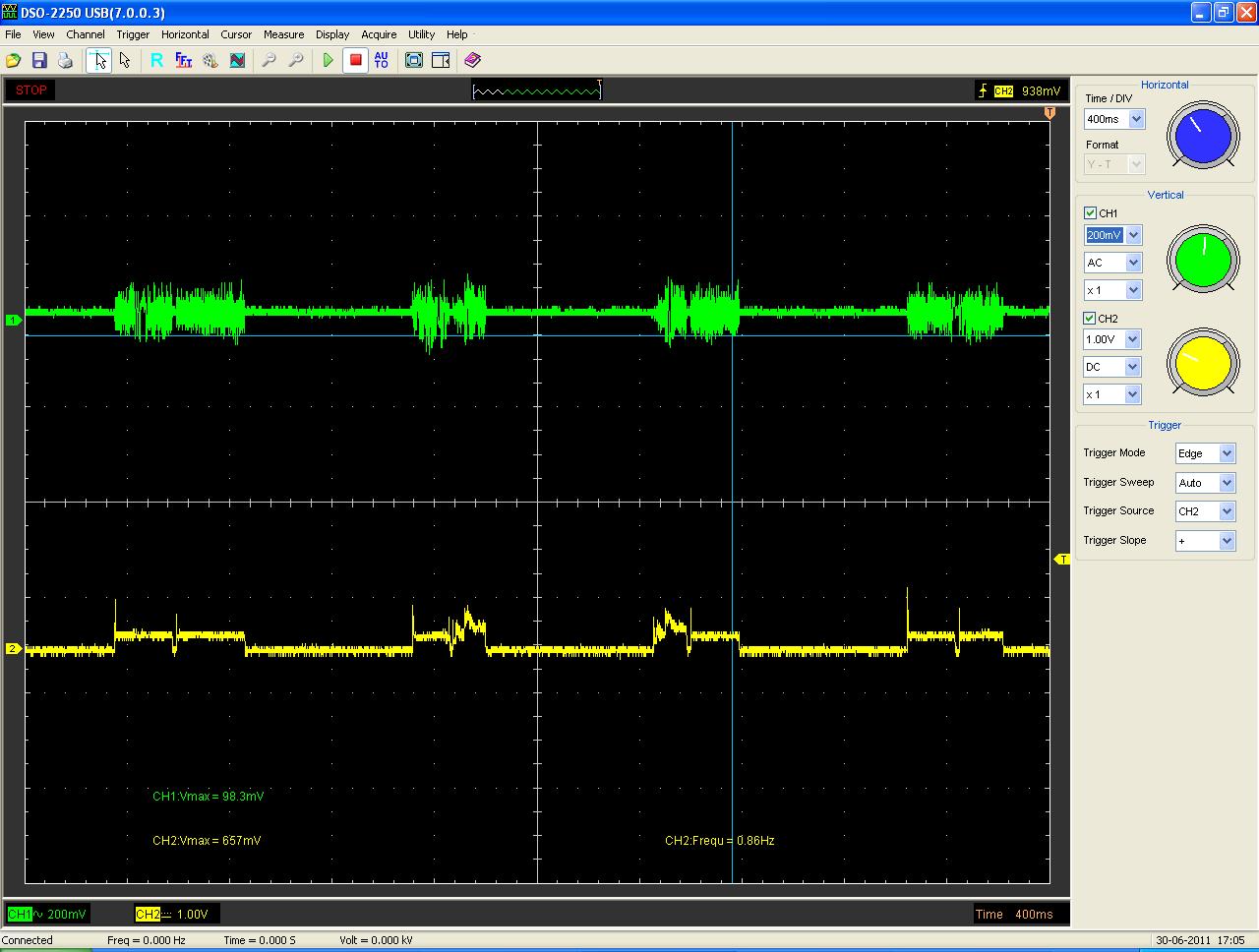

Hey guys, I produced the circuit and the op amp worked perfectly. Here is an output from the DSO Green is before op amp in AC yellow is after opamp in DC. I think I may need to increase the gain of the TL071, what is the highest it can go?

The gain of the opamp is set for 1M/1k= 1000 times.
The datasheet of the TL071 shows a typical max gain of a little less than 100 at 40kHz. Two opamps in series and each with a gain of 32 will have a total gain of 1024 times.
ahh, ok so a second TL071 will take it from 1000 times up to 1024 times? Sorry this is the first time I've used a TL071 chip, bit of a newb
