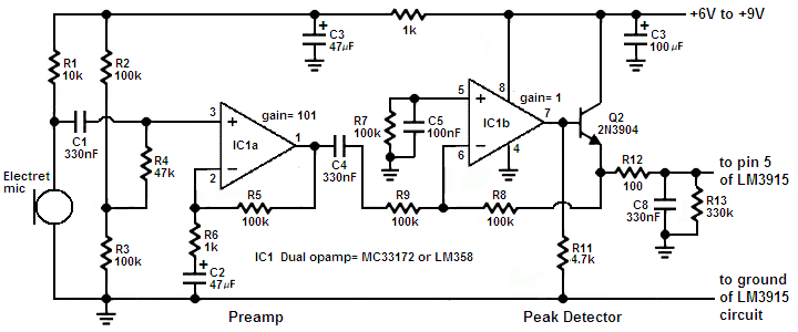

Ahh, I get you, yes I was only thinking about the LM741 as I have a heap of them handy. But I have the TL071 chips now and they are working well. I have made some changes to the Bar Graph circuit, switching to the LM3915 and am going to try out the very basic "vibration sensor" from the chips doco. I will use the op amp to boost it once and raise the sensitivity of the LM3915. There is also a peak detector circuit using an LF351 (should substitute the TL071 fine there) that I'll be adding also given the duty cycle as you would have seen on the DSO screen grab.
I've removed the rectification as apparently it's not needed. Let me know if you see any flaws in this.
Cheers
*EDIT* the two Caps on the boost circuit are supposed to be 1N not 1uF

Your second TL071 (the rectifier) is not biased properly so it will not work.
The supply is only 5V but the minumum supply for a TL071 IS 7V.
Really? buggar, that circuit schematic is straight out of the tech doco from the LM3915. voltage I will just increase, no problem. What needs to change for the second TL071 to work? It is a peak detector for the LM3915 so it holds the peaks for a short period as they only exist for a limited amount of time (a couple of ms).

The circuit assumes that you know that most opamps using it need a dual-polarity supply but your supply is missing the negative voltage.
I designed a similar circuit as yours but I used a MC33171 or MC34071 single-supply opamp that works perfectly when its inputs are at the negative supply voltage which is 0V in this circuit.
Here is my circuit:

Dougy, thanks for that mate. Yes I opted for a shift to the LM3915 pretty soon on after discovering the logarithmic output of it. Audioguru's boost and peak hold circuit above worked great, while the intensity of the output is still pretty low I manage to simply increase the sensitivity of the Lm3915 and it seems to be working ok.
thanks heaps for your help guys!
