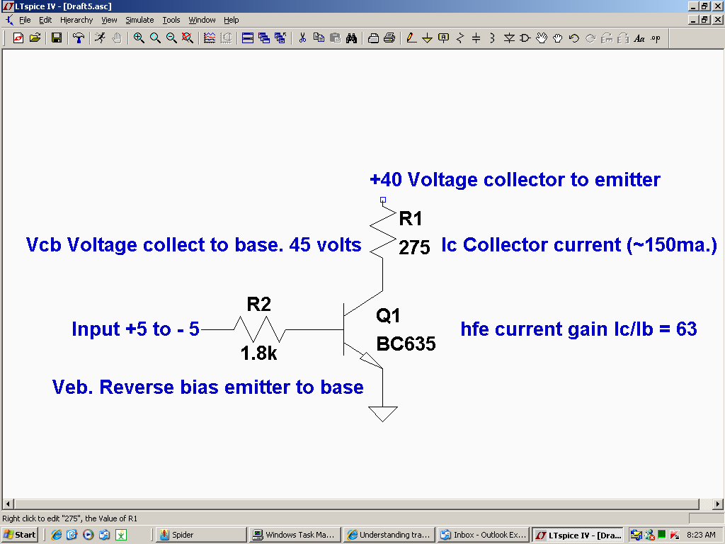

Hi, i'm new to the forum, so hello :)
My electronics knowledge is getting better, i have been reading a lot, but i have lots of gaps and lack some basic knowledge, which im trying to pick up.
Anyway, i understand the concept of a transistor, how it can be used for switching and i have tried it on a breadboard and wow i got it working etc. So thats great, but i dont really understand the datasheet information and what are the important bits. I have the following transistor:
Device_Name: BC635
VCEmaxV: 45 - maximum voltage between the collector-emitter junction
VCBmaxV: 45 - the maximum voltage between the collector-base
VEBmaxV: 5 - the maximum voltage between the emitter-base junction
IcMax: 1 - the maximum current in milliampers you can put through the transistor
A PtotW: 0.83 - power the transistor can dissipate in milliwats
hFE@IcmA: 63@150 - current gain
But how do i actually use this information, what does it all mean? I have been searching for an example on the internet where they actually have a real example with power supply etc, but i havent found one which uses this information and explains it.
If anyone could help, that would be much appreciated :)
Thanks.
Transistors
Here is a picture with some examples.
I forgot power dissipation which can be calculated using collector current X voltage from collector to emitter. In this case about .3 watts. (2x.150). Often in switching designs saturation is used instead of hfe. It is usually defined as Ic/Ib = 10. This gives the lowest collect emitter voltage and reduces the power in the transistor. In this case the power could be reduced to about .05 watts. Many designs don't reverse bias the base emitter junction to turn the transistor off. The reverse bias (-5 volts here) will speed up the turn off over just making the off voltage 0.
Tx
Forgot the picture.

ronv thanks for the image, that helped. Just one question, the resistor before the base, is that used to keep below the 5v?
The base emitter junction looks like a diode, thus a resistor is required to limit the current when a forward voltage is applied (the normal transistor "on" condition).
The 5V limit is for the reverse direction which is not significantly affected by the resistor. You must never apply a reverse base-emitter voltage larger than 5V or you can break down the junction and damage the transistor.
The spec sheet shows Veb which is not the same as Vbe.
Veb is the max positive voltage that can be applied across the E-B junction with current flowing from E- B.
Vbe is the voltage across the B-E junction with current flowing from B-E. This is the P-N junction voltage drop which is fixed at approximately 0.7V for a silicon transistor and 1.4 volts for a Darlington transistor
