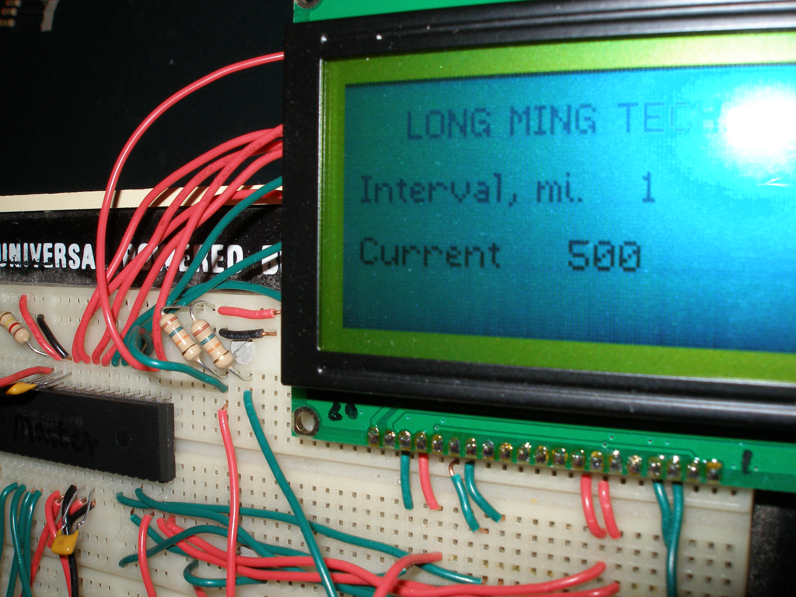

Unicorn GLCD demo.
ok finally the GLCD is working but i still get some glitches init. It seems that when ever i plug out power, then plug it back again after like 20 sec, the GLCD doesn't show anything, however, continuously pressing and releasing the reset button sometimes shows the display. Can this be a timing issue? I am using 4MHz external crystal

All right, I finally make it working. Thanks guys, for all of your posts, which guide me through this.
