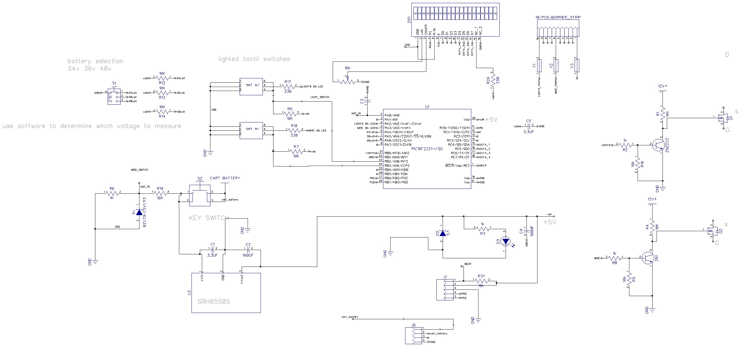

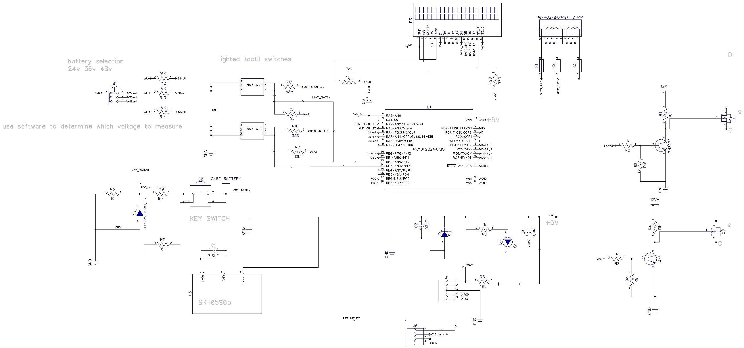

MADE CHANGES AS SUGGESTED
MrDEB, you have outdone yourself this time! You have re-introduced EVERY ERROR addressed since your first post! MOSFETS, bypass caps, LCD connections. The SINGLE thing you got right in your post #56 sketch was the correct values for the ADC voltage divider resistors. (Post #56 sketch)
In your most recent sketch, why do you have R11 preceding the DC/DC converter input? Have you understood nothing about trying to power the voltage regulator via a voltage divider? The same comments apply to that resistor. What do you expect to accomplish with the zener D2? C1 & C2 should be located adjacent to the DC-DC coverter. ALL of the errors in the first paragraph still exist in your revised sketch*.
*sketch, because what you've drawn is so poorly drawn and laid out without proper symbols that calling it a schematic would be a far stretch.
edited schematic. I forgot to remove R11
D2 thinking as a safe guard against voltage error?
Your choice of an 18F2221 micro is odd, and it's lacking a feature you may want: a FVR (Fixed Voltage Reference). This gives you an accurate voltage reference to determine ADC voltage. Without an internal or external voltage reference, your ADC measurements use the PIC's 5 volt supply as the reference. Fortunately, the SRH05S05 DC-DC converter has a tight 1% tolerance on output voltage, so even if you do use +5v as the reference, you should get good results.
Looking at the availability of 18F micros, I'm pretty shocked at all the zero quantity availables I see in Octopart. I'd suggest using an 18F43k22 or 18F44k22 in a pdip package. More micro than you need, but there's availability (for now) at US suppliers. These micros feature a FVR.
Here's a suggestion before everybody who is trying to help puts you on ignore. Instead of putting out an endless stream of sketches where you change one thing and ignore everything else up to this point, how about making a clean schematic with ALL of the changes? That means ALL CONNECTIONS shown, with proper symbols and all lines drawn, and no assumptions about what people will understand that you meant?
What voltage error?
If the voltage is greater than the zener voltage of D2, how long do you expect D2 to last?
Make sure you have all the polarized caps installed the correct way.
D2 is on the output of the dc-dc converter.
I suggested adding one to the ADC_IN since it could see a large voltage at one point.
It may not be needed anymore now that the input is different.
Ahhh, didn't spot that, sorry. It doesn't help that some components haven't got a designator such as the zener on the ADC pin.
How could you miss it? There are only 8+ versions of schematics where various features come and go without explanation.

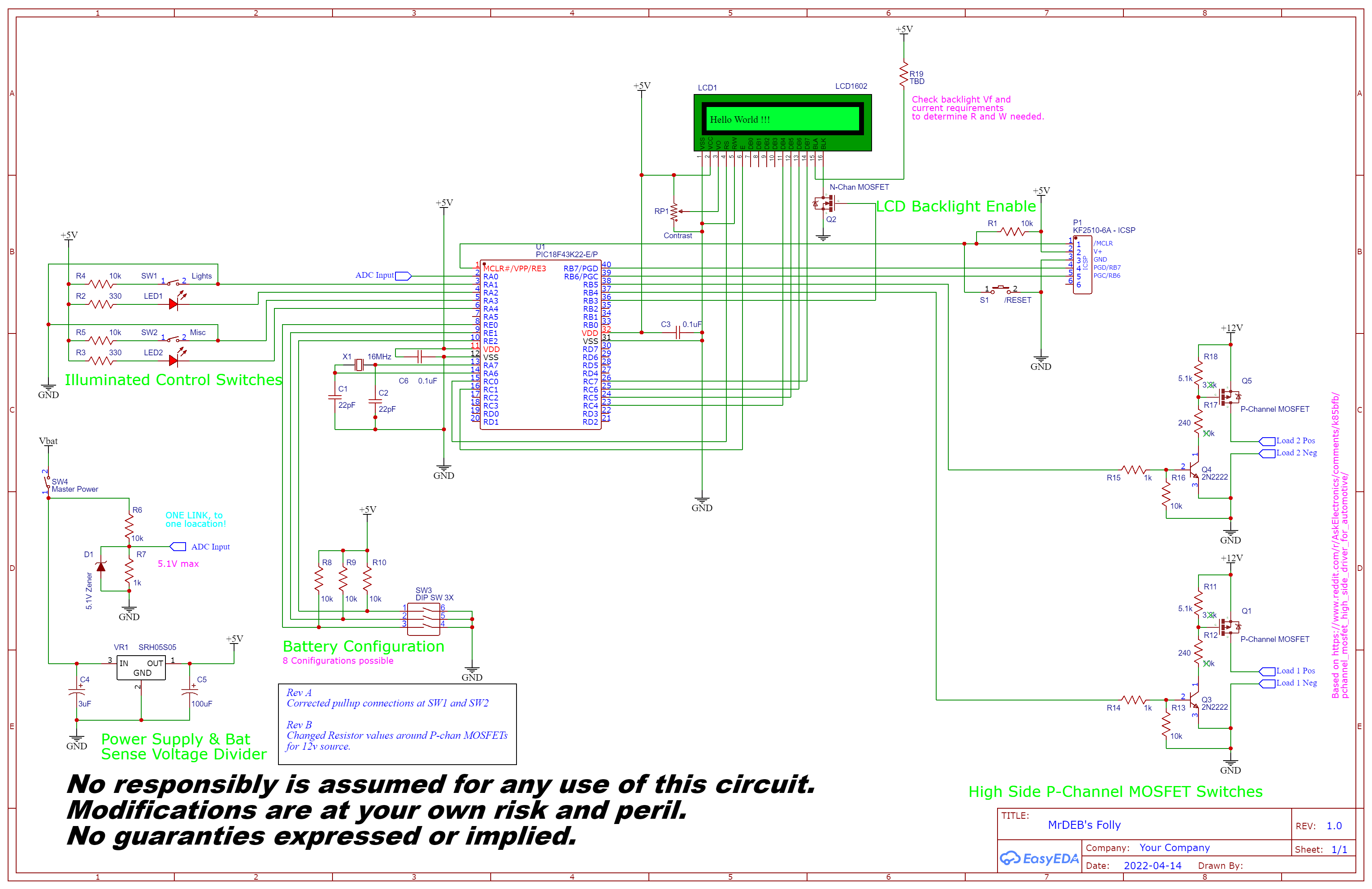

Perhaps this will shortcut this painful tedious process. This schematic is based on 18F43k22 or 18F44k22 micros which have the desirable FVR and are in stock at US suppliers.
No guaranties, use at your own risk, yada, yada, yada. This schematic has been made using standard symbols, etc., as schematics should be made. Take note MrDeb - you should be good at it; you get enough practice.
Edit: fixed pullup connections at SW1 and SW2.
Edit: changed resistor values on P-channel MOSFET gates to better suit the 12 volt supply
Edit: I made a mess of the pullup resistors around SW1 and SW2. See the revised schematic in post #89.

I see "visitor" switched back to P channel. No part number?
I like the layout of the schematic thus will redraw my schematic.
the ADC_IN has suggested zener connected to R6 and R19. Yes my schematic is kinda convluted at best.
I like the use of Q2 mosfet for the backlight if needed but no switch to control Q2?
Will redraw and odmit the zener D2
It's done in your software, it's up to you how you want to activate it - there's plenty of spare I/O pins to add a separate switch if you want. You could also remove the contrast pot, and run that from the PIC via PWM, and set it via buttons on the PIC - in one of our commercial products I use a 1K resistor and a 10uF capacitor - and as it's only got three buttons, I access it via a 'secret' service menu :D
Switching the backlight could also be done direct from the PIC, no need for the FET, as long as you keep the backlight current below 30mA or so. The display we use in the product I mentioned above was upgraded by the manufacturer a couple of years ago, and the new version has far brighter backlights, so I was able to increase the value of the limiting resistor and lower the current.
You can get rid of that zener now too.
At one point you were switching voltage dividers into the ADC_IN pin and it was possible to do an "oops", select the wrong setting, and over-voltage the uC pin by a LOT.
With the 10K/1K divider on the ADC_IN you should be ok with a CART_BATTERY voltage up to almost 58V.
As long as there's a large enough resistor feeding the pin from a large voltage then the pin protection diodes will "protect" it. You can even feed 230VAC into a pin via a suitable resistor.
