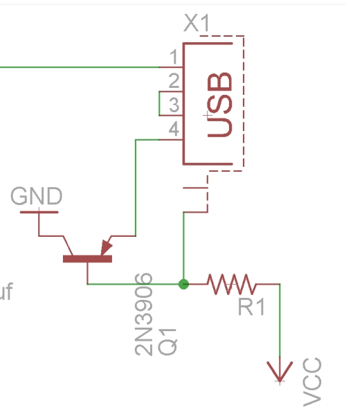

Hello all again im working on something yet again. Its has to do with USB but thats all i can say for now. Nothing serious. I made a schematic and wanted to know if its plausable. Im hoping since most devices included cell phones have usb connections and since they are most likely large companys they ground the USB connector to the board.
Hoping that the connector is grounded. I was going to use a 100k or more pullup on the casing on my USB connector to detect when its grounded so i can tell when a USB device is inserted. Do you think this will work?

Where does your detector circuit go? Inside the host (computer) or in the slave?
The device im making will connect to a cell phone or camera ... the CELL OR CAM will connect to my device via USB cable ... now the cable plugs into my device which i want to detect when it does.

ok a simpler question would be are most USB connector chasis grounded?

I want to detect the cable being inserted into my device NOTHING ELSE. just when its plugged in... DONT CARE ABOUT USB PROTOCOL.
USB has a 5V and GND pin, as well as the shield. Never used the shield, I just presume its grounded PC end, and I dont want any currents flowing in the shield due to any ground potential differences (bad for EMC).
Why not just detect 5V from the host?
my device powers the OTHER device. I want to simply have it turn on or off automatically when wire is inserted. I think most devices have a grounded chasis and if thats true this should work. Ill make a test run on it... something small and inexpensive like a cheap MP3 player.
Sorry I misunderstood the problem :), your idea works as long as the far end shield is grounded. If not you may have detect the increase of current due to the new device across a small valued resistor.
On a side note I thought shorting D+ and D- would be a bad idea. I have used 18F2550's and the USB PIC32's as of today, but never really looked into how USB really works the libraries are really good.
in all electronic devices i have seen that use USB, i.e Mobile phones, cameras, etc the shield on the usb connector is grounded. I belive it is done like this in case the +5v touches the casing of the connector it will not allow the device to power up. this is what i have found in my experience.

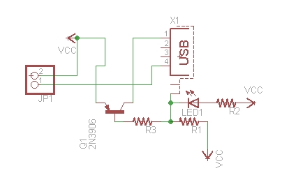

ok it wont work like that im making a new test now. I forgot i have to use the transistor to connect VCC not GND lol

ok it did work but i realized a simpler method to stay off untill connection... just connect ground to housing and when the wire is plugged it will short housing and ground on other side turning it on :D
