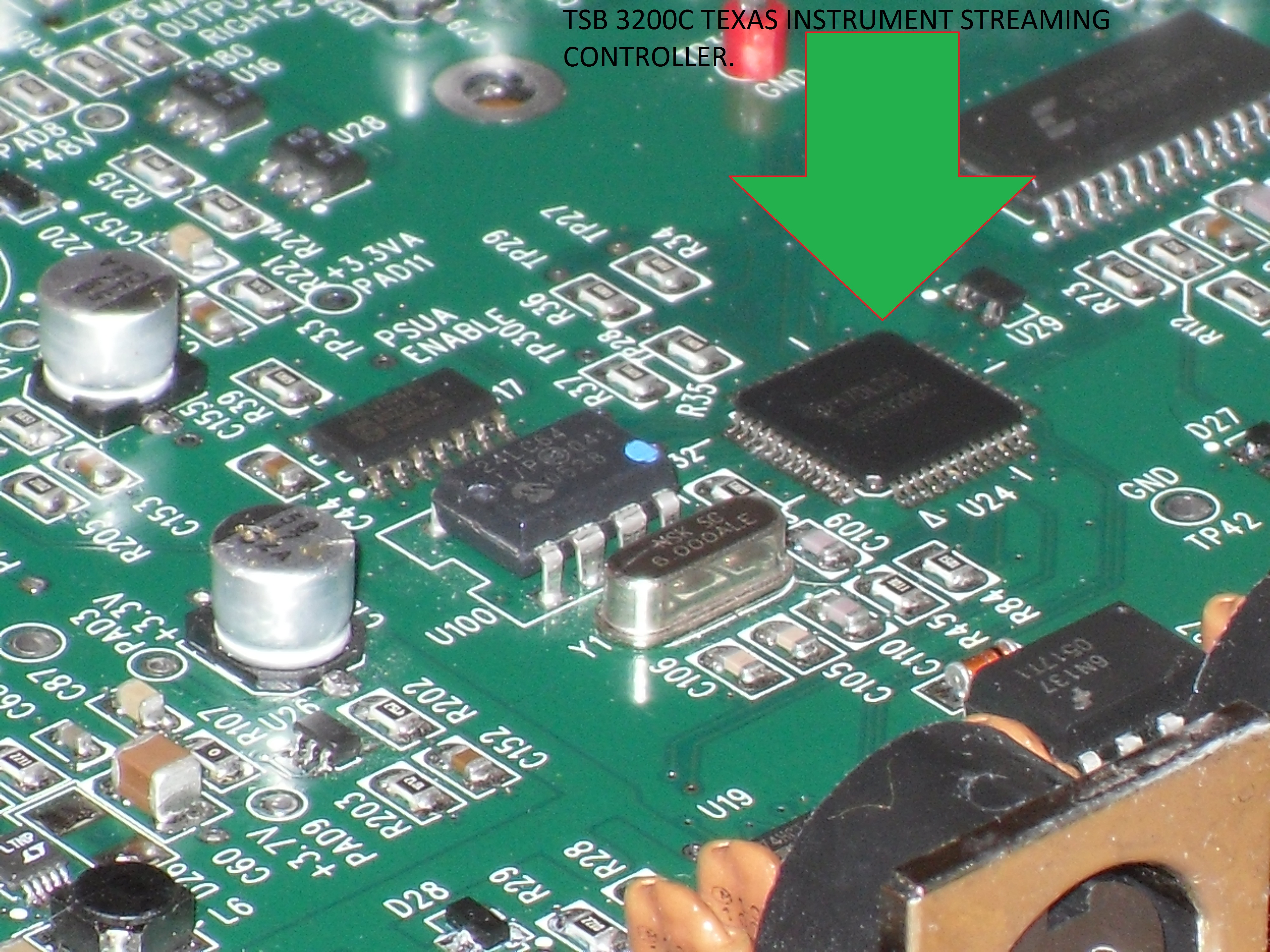

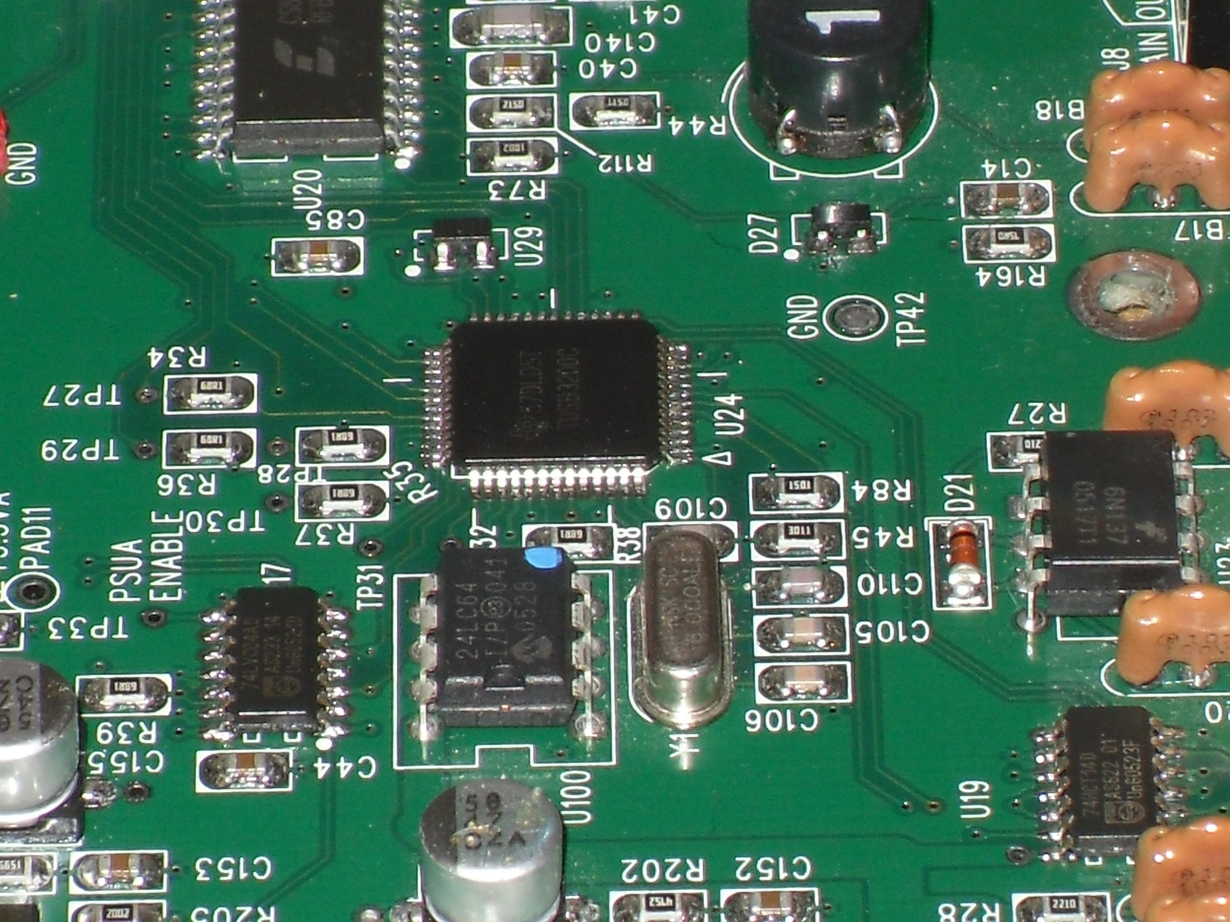

Hello everybody, I am working on a upgrade project, I have a peripheral that is implementing usb1.1, The problem is, is that this device is for high definition audio and 12mbps is just not cutting it ( Plus this controller is way outdated!) . I was wondering if anybody had any ideas on how I could mod this thing to where I could take advantage of 1394 or 2.0, I rather convert it using 2.0 because I would not have to change out the hub/interconnect. But if 1394 would be just as easy to do implement as the 2.0 I would have to go with 1394. I Know that I might have to change a few things around like the master clock and some other things, The current controller is a TUSB 3200c manufactured by Texas Instrument Inc, **broken link removed**, I need whatever controller(s) I am going to be using to do what the current streaming controller is doing but just alot faster. I know I am going to have some Issues with the Pin package, because the 3200c is a 52pin package and they don't make any new style controllers with that kinda layout.... But thats fine, I will find a way to connect it probably using a custom adapter.... anyways, any ideas would be awsome!
Thanks!!

Just looking at clock frequencies can be deceptive. On USB 2.0, if there is a 6 MHz crystal/oscillator then there must be a PLL to boost that to 12 MHz. because that is one of only three bit rates used in USB 2.0 The others of course are 1.5 MHz. and 480 MHz. These are the data rates on the USB channel only. They are not related to the audio data rates at all. The ability to stream requires that the data arrive on the USB channel faster than it goes out on the audio channel, or that you have sufficient buffering to allow the USB channel to run behind the audio channel, but catch up in the gaps. It is still unlikely that you can upgrade a USB 1.1 board to work at 12 MHz. if it won't do that already, and no chance to make it work at 480 MHz.
On our USB chip we use a 12 MHz. CVXO and our audio processing chain starts with much higher frequencies than any that you mentioned, so I'm pretty confident that 12 MHz. is more than suitable for streaming audio.
hmmmm,,,,, ok, so if i were to start over here what kind of usb controller should I use for streaming audio from the phy to the cpu? Is there any particular controller that works best for this type of application?
ok, ok I think I get what your saying now about the usb1.1 controller, Hmm. I'm kind of a newb at this so forgive me for being so unaware.... So what your saying is that since my board was based off a usb 1.1 controller, There is a 0% chance of me removing the old controller and replacing it with a high speed controller because....The traces from the usb controller to to the phy would have to be changed??, and the existing configuration could not be used.?? ...... What I was planning on trying to do was to remove the old 1.1 controller. Where the old 52 pin surface mounted 1.1 controller was in place, I was going to solder a 52 pin extension that would lead to a "Floating" board. On the "Floating board" then I would put my upgraded usb 2.0/3.0 or 1394 controller(s) thus creating my "upgraded network solution". The new controllers(s) would like I said all be mounted to my "floating" board and connected to the existing peripheral, through that 52 pin extension that lead from the old controller to the extension board.
After the "Floating board" was in place I was then going to remove the existing old 6mhz crystal and replace it with either a 24.5 mhz for Ilink 1394 or whatever freq I needed to Implement the Usb 2.0 controller... ... That was my master plan, I was going to try and implement..... You see, this is a mod and obviously I don't want to have to create and order a diffrent board for the mod, cause It's kind of a pain.... I mean if I would have to do that I would, Only if it was the last resort... I'm having an Identical board made for me with a blue solder mask and gold immersion because I think it will conduct alot better and be less noisy, I mean while im doing that like you said I could implement a new set up, but i'm kind of limited on space, It could be done, but like I said I only wanted to change the schem only as a last resort, the "Floating" set up would be the easiest and most cost effective... But Idk,,,,,,,
We do not explicitly use a CPU. For all I know there could be one inside the TE7022L. It is connected to a serial flash chip, but otherwise has no visible external memory.
I see what you are trying to do and why. My opinion is that you have very little chance of success, but never say never; at least check with the vendor of the USB1.1 controller and verify first what speed the USB channel is running on (I vote for 1.5 MHz., Could be 12 I'm not 100% sure) and second what upgrade path(s) is(are) available.
Last check out the TE7022L to see if it comes close for your application. Now you will be in a much better position to move forward.

We only need the one channel in our application. I looked at the ".pdf" datasheet from GFE on Thurdsday or Friday and saw nothing about a change in domain name. Apparently the USB 1.1 spec includes operation at full speed or 12 MHz., so I was mistaken about my earlier assumption. So we know this should work for a single channel at 24/96, but not for multiple channels which is where I think you are going. The idea which had not occurred to me was that a controller might have the ability to run at speeds other than the standard ones used for data transfer. In particular I'm not sure how that would work on the host controller side. In the physical layer ther are four wires, two are the power pair and two are the data pair. We know that in such a situation the data and clock are encoded on the same wires at the transmitter and decoded and separated at the receiver. Normally in this situation a receiver and a transmitter need to agree on the clock rate for this recovery to be robust and reliable. I'm not aware of how or why it might be the case that the data rate on a USB cable might vary over some range like 12-25 MHz. and have receivers track what transmitters are doing. There is an explanation here, but it is beyond my ability to discern.
I just went back to check USB 2.0 because something was nagging at me with respect to audio data and it is this. USB data uses NRZI encoding with bit stuffing. What this means is that extra bits are stuffed into the data stream to guarantee that there will be a sufficient number of transitions in the data stream by the transmitter, and they are removed by the receiver. This means that in the time domain USB data streams are non deterministic in length. Their actual length depends on the data; a zero is inserted by the transmitter and removed by the receiver for every 6 consecutive one bits. Audio data formats like S/PDIF use biphase mark encoding which does not require stuff bits. S/PDIF has a deterministic length in the time domain regardless of the contents of the data. This leads me to conclude that it would be difficult to predict how one should or could adjust the USB bit rate to "somehow" match some particular audio data format.
I go back to my earlier assertion that the USB channel must run significantly faster than the required audio data rate in order to avoid even the remote possibility of underflow, and furthermore it is in no way possible to match in any real sense a nondeterministic data stream like USB anything to a determiistic format like S/PDIF or I2S.
Have you identified any candidate controllers that may allow you to get to High-Speed operation (480 Mb/s)?

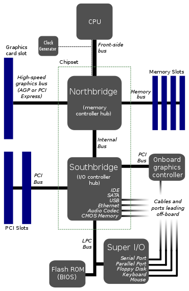

Something you may wish to keep in mind. Modern PCs have WAY more than a single USB host controller. The machine I'm using right now has 8. So as long as you use a different port for each device you have a lot less channel/bandwidth limitation than you might think. Especially considering all the ports on my machine are USB 2.0 Not as fast as 1394 individually but there are 8 ports. And also keep in mind if I'm not mistaken 1394 is not hot swappable, the entire bus needs to be reset if a single device is removed so adding or removing a single channel from a 1394 port would require all the other streams to be interrupted and the devices to be re-initialized. Even the oldest machine I currently own right now (about 6 years old) has 2 usb host controllers.
No, 1394 is hot swappable. The only way you have 8 usb 2.0 controllers, is if you have a really hybrid cpu. Like a really, really, really expensive server motherboard.Yes, you may have 8 nodes. But each node does not have an individual controller. A single controller can support multiple nodes. If you don't believe me, Open your computer and try to find 8 usb controllers on your mothreboard (That would be 8 diffrent chips) Because I can almost guarantee you you wont. Usb 1.1 - 2.0 are alot diffrent to 1394 in the way how they communicate with eachother. Usb uses a host controller (Like on a computer) to controll and communicate to a phy controller. 1394 Is an OHCI controller, Meaning that any controller can be host depending on how much bandwith a specific controller is requesting on the bus, Or something like that..... That's whats nice about 1394 because in a 1394 network, you can use 2 of the exact same controllers for whatever. 1 for the phy and one for the host(cpu) you don't have to go shop for a host controller and then try to find a phy controller......
BlueDragon, look it up, You can not remove a device from a 1394 chain without resetting the entire bus. That's not technically hot swapping by any way I look at it.
I do not have 8 nodes. I have 8 host controllers, as reported by the Device Manager, I have 1 1394 controller, each USB controller has a seperate I/O range. There does not have to be 8 different chips, you've obviously been absent from modern electronics for a number of years cause I only have 1 CPU unit, but there are 4 cores in it, multi host controllers are just as easy to make, in fact easier because the same major system bus.
The following Information was gathered from the 1394 trade association.
What is hot swapping?
Hot swapping is the connection and disconnection of computer peripherals or other components while a system is turned on, without interrupting system operation. 1394 enables hot swapping.dd.jpg
The picture I attached is a Usb host controller. These are the most common controllers/transceiver that are found on most Asus and Intel motherboards, If you take a look at your motherboard, you will most likely see you have this controller or a similar controller. This controller makes Usb possible, It is the heart and soul of all usb communication. Central processing units, do not have integrated usb host controllers, (Hence the name central PROCESSING unit) The C.P.U. Processes all the Information it receives from it's sub components. If a Central processing unit had the capabilities or were Inter graded with such controllers then Texas Instruments and all the other manufactures of semiconductors would be out of business because there would be no need to make that certain semi-conductor. If C.P.U's were intergraded with such semi-conductors they would be fairly large, probably about 4-8 x there size and conduct massive amounts of heat.
I am no guru at this but I'm pretty shure I am coming correct with this...... Also you have multiple usb controllers because 1 or more controllers support full/high speed operation and 1 or more controllers support low speeds.... 1.5 mbps..... Usb Transceivers/Host controllers are a Microprocessor within themselves, So you may not have 8 separate chips, I may be wrong on that, but depending on what kind of transceiver you have, it could have multiple controllers within that chip. yes you may have a quad core, but that does not mean that each core has it's own usb transceiver integrated within itself...... I don't think. And I'm pretty sure im right on that.
