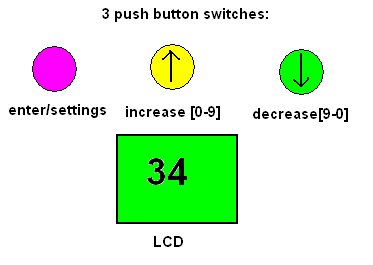

USER INTERFACE:1 enter/settings switch,2switches->2digit value,LCD
I want to create a user interface using C programming for a pic microcontroller-see attached picture.
It will have 3 pushbutton switches. It will allow the user to enter a 2 digit value:
1.enter/settings switch
2.increase digit from 0 to 9
3.decrease digit from 9 to 0
If the user pushes the settings button then the user will go to a settings screen. The user can then select a 2 digit value EG. 99 or 34. The user can use the increase button to increase the first digit from 0 to 9 and 0 to 9 again. The first digit will be displayed on the LCD whilst the user is increasing. Thereafter the user can use the decrease button to decrease the second digit from 9 to 0 and 9 to 0 again. The second digit will be displayed on the LCD whilst the user is decreasing. So now the user has decided on a 2 digit value and wants to use this value in another function so the user presses ENTER and leaves the Settings screen.
Any1 with any useful ideas to approach this.

how do i combine those digits to use in another function, shud i use a concatination function?

Select Case Statement is maybe the best way to go
case1
do this till it's true if true goto case 2
case1
next thing to do
Some thing like this

Heh i made a menu for my clock and i have to warn you this might get messy!
The switch function is a life saver! Make sure you use different functions and you can access variables across the code if needed. Im like 35% done with my clock and im at around 20 pages of code. Of course a few pages are just images for LCD but thats maybe 2-4 pages. So ive still got 16 pages of code :D
So what im saying as a tip is... document or PLAN it out well. If needed make a flow chart (not flow code) so you can picture out how the menus will operate. Once done with chart code just the menu stuff then code the actual work or things you need to be done.
As a example this is the code i have so far and i only have done the settings menu and the set time function. I still need Set Date, Alarm 1 and Alarm 2. The neat thing is i have 4 check boxes in my settings menu and when you press up or down it will check [X] the next box and clear the rest, this makes the user see whats being selected.

Messy right?
Now since i know its ugly and hard to see what menu is selected i cut the code into pieces... now my menu code looks like:

Yeah thanks guys. Ill definitely use that approach. Neat:)
after i got the two single digits which the user selects by pushing a button,
how do i combine them into a single digit
. and display it onto a LCD???Im using a pic 16f690 and programming in C
EG
1st single digit=3 (this means user pushed button 3 times)
2nd single digit=5 (this means user pushed button 5 times)
2digit number=35 (i want to use this number to do mathematical calculations in the calc_distance function)
Any useful links?is this basically Converting a two-byte BCD into a single byte???
you want 3 and 5 to be 0x35 or decimal 35(0x23)? its easy here is how:
Leave the singles number aka 5.
You then use a 10 for the tens position so you would 10 * the 3
then add the singles to it aka 5
so:
Var1 = 3
Var2 = 5
var3 = 10*var1+var2
var3 = 35
i just reread your question. To place 2 digits on a LCD is easy. Can you write strings? How are you sending data to lcd. Can you post your char code ?
You can create a 2 byte var
MyNum[2] (2 bytes aka 0 and 1)
MyNum[0] = var1 (aka 3)
MyNum[1] = var2 (aka 5)
since these are decimals you need ascii so you would do:
MyNum[0] = var1 + 0x30
MyNum[1] = var2 + 0x30
Then a 2 byte loop to send it to LCD:
for(x=0;x<2;x++){
  LCDchar(MyNum[x]);
Ok so once i get the 2digit ascii onto the LCD, i need to use this 2digit ascii "number" to do mathematical calculations in another function??? so do i need to convert string to float now??
Thanks for your input AtomSoft...I saw your the video of your "clock menu" -Very Cool:)
Here is a simple solution...

Ok so the VAR1 and VAR2 will appear as 35 in ascii and be displayed on the LCD.
Now the 2nd part:
I will need to read this value into the micro from the LCD???Right
I will read the high byte 3 and low byte 5 and i want the 2byte BCD to become a single byte which i can use for mathematical calculations.
I found this code, i think it would be applicable but 8052 and asm :( uhmmm confuses me, Any suggestions?
When the user select the numbers you should have that as a global variable. This way you can always edit it .
Here is code to turn 2 digits from user into a single number (decimal) like
Decimal 3 and 5 into 35(which is 0x23 in hex).
unsigned char Combine(unsigned char SinglePOS, unsigned char TenPOS){
   unsigned char wholeNum;
    wholeNum = SinglePOS + (TenPOS * 10);
    return wholeNum;
Something like that. Sorry i just redid my pc and need to install MPLAB and all
Here is a TIP:
1. Have a set of vars to use like...
unsigned char NumDec;
unsigned char NumSep[2];
Now you can use NumSep to store the user entered data and use NumDec to store the combined data. Like when a user enters the first digit save it in NumSep[0] and the second digit in NumSep[1]. Then you can use the Combine function like:
    NumDec = Combine(NumSep[0],NumSep[1]);
also you can use the LCD better like:
    ShowDigits(NumSep[0],NumSep[1]);

Wow thankx alot, thats real useful stuff to know. Im going to start coding and implementing your ideas.:). I need to get the user interface working. Keep you posted. Appreciate you taking time to assist a beginner.
Thanks. Your C18 tips and tricks are very handy. Im going to have to pay alot forward lol. Im still working on the code-drew a detailed flowchart as you suggested:), multitasking-learning for a superconductivity test as well for tomorrow.
I got some push button switches & resistors. Im going to wire it to the pic and run the code today. This is the relevent parts of the code for the user interface.

oooh i gota include this in the case statements if var1>9 then var1=0.... and if var2<0 var2=9...i'll do that when i get home.
Let me know what you think of this code....Thanks
