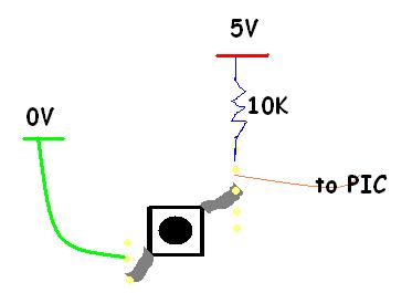

USER INTERFACE:1 enter/settings switch,2switches->2digit value,LCD
Oh No...:confused:
i added the switches but when i run the code nothing appears on the screen.
Am i supposed to configure the LCD to read??? At the moment its configured for write Only. The LCD is working when i COMMENT out //menu();. It displays infra red liquid level detector. However when i UNCOMMENT menu()...the lcd does not display anything:(. I connected switches to the PIC:
RC2 //HOME switch
RC3 //INCREASE switch
RC4 //DECREASE switch
RA4 //ENTERSETTINGS switch
The code compiles with menu uncommented out but it doesnt work in the circuit.
the new functions added (which might have problems i cant spot)are:
void init(void);
void read_input_sw(void);
void ShowDigits(unsigned char ,unsigned char );
unsigned char Combine(unsigned char , unsigned char );
int enter_settings(void);
void menu(void);
Here is the code:
Configuration switches

Wow the read switch stuff looks way to complicated. Are you using pic lines for each button? also...
Why not use a few simply ifs?

Uhmmm im working with push-buttons for the first time. Yeah each switch has its own line to the PIC. Well ill try out the ifs as well-thanks
