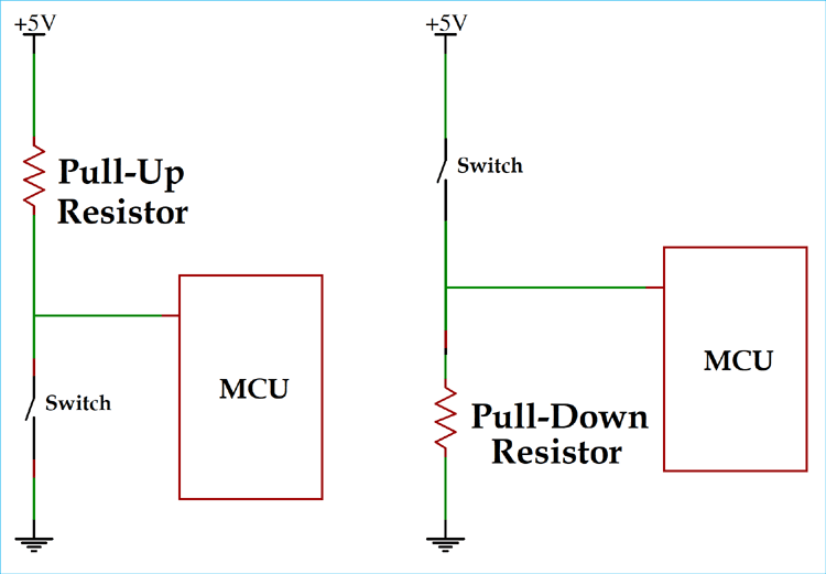

I soldered up a perf board, just need to install the Leds but here is my layout schematic.

Based on your schematic, I really don't think you understand the fundamentals of a pull-up vs. a pull-down resistor and I wonder if your continuous "missing the point" rhetoric is simply a means to test our sanity.
here maybe get the idea
I must admit I hadn't looked closely at that schematic (they rarely reflect reality anyway). As drawn, without anything connected to the micro connector, those floating inputs will sure lead to problems.
I must have grabbed the wrong schematic but this one is similar. Planning on having boards made.

Nothing at all. It looks like it was copied from a reliable source where you might actually learn something and understand what you're trying to do.
But it so frustrating trying to help you because when somebody points out errors in your schematic, rather than attempting to understand what they're talking about, you just copy&paste something different and throw it against the wall to see if it sticks this time.
An example: When your '595 test circuit didn't work, you blamed it first on bad parts, then on a bad breadboard. You didn't post a schematic of what you were doing (and if you were following the schematic you posted in #243, it's clear why it didn't work) and you ignored requests to explain what sequence you were pushing buttons. Random button presses will not make the circuit function.

No. The major difference is the schematic in post #243:has the pull-up/pull-down resistors wired incorrectly. They aren't pulling the data lines anywhere. See posts 244 – 246. If somebody says something is wrong, don't just blow them off. If you don't understand what they are saying, ask them to explain.
What is the voltage on the line highlighted in yellow when the button isn't pressed? Is the resustor circled in red connected to the highlighted line when the button IS NOT pressed. Compare it to the diagram be80be posted.

It's closer, but not correct yet.
In as much as you're just copying the schematic in post #247, you can compare trace by trace to find the issues.
You may consider me an a$$ for not just pointing out the error(s), and even explaining them, but that never proves effective. In this case, figuring it(them) out may be a learning experience. At any rate, I spotted an error at a quick glance. There may be others.
after redrawing the schematic, I discovered mistake Jon is referring to?
