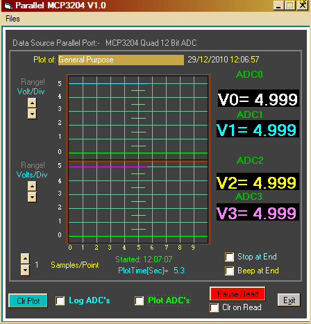

hi ,
As requested in your PM I have attached a zip file for a VB5 DVM module.
The program is used to control and read a MCP3204 4 channel 12bit ADC via the PC's parallel port.
It does work and is in regular use.
Extract the SPI subroutines to suit your application.
