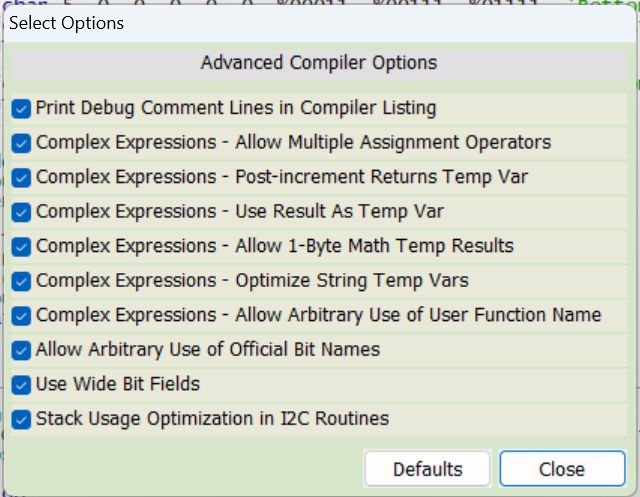

There are new improvements in the IDE for those using Pic Basic Compiler v9.84 (for PICs with eight stack levels). The driver has been optimized to control 1602/2004 displays via I2C using the PCF8574 I/O expander. It is now possible to make function calls within another function again.
I've attached the IDE configuration, although it should be enabled by default:
