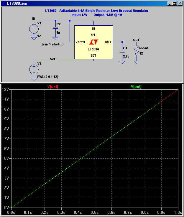

Looks like it makes a reasonable voltage follower, but still runs out of steam at about 10.6V

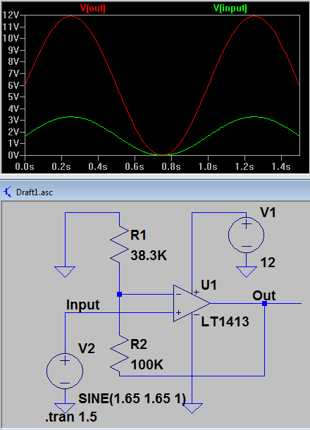

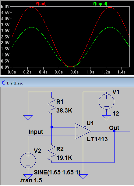

If I change the R2 with AD5293 ( variable digital potmeter ) using an LT1413 ( op amp - 12V ), the simulation shows that I'd get what I'm looking for. I also noticed, that the min.Vout is ~70mV, which I think is OK. Can you have a look at these please it this would really work? Thank you!

Your simulations have no load on the output (other than the feedback resistor). Try it when the opamp is driving a 12 Ohm load (to ground? or to +12V ?)
Yes, I've tried it with and seem to have worked with about 180 Ohm... May I ask where the 12 Ohm comes from? Why not some other number? I know I need to learn more and I really appreciate your advice. Thank you.
You started this thread saying that you wanted 1A at 12V. R = E/I = 12/1 = 12Ω
You are absolutely right, my apologies... How about the attached? Yes, it seems to "crap out" at around 10.5V, but until that it seems to hold quite well...
