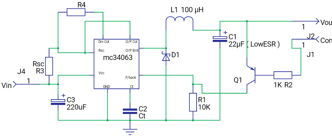

I seen a similar idea applied to another SMPS controller IC. Is there any reason why it won't work with an mc34063?

Please tell me what you are doing?
I do not know, why Q1 & R2.
If "Con" is grounded the PWM will regulate at 1.3 volts.
If "Con" is connected to "Vout" then Vout will be just below Vin. (not regulating)

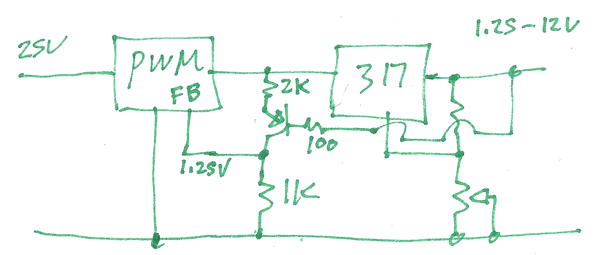

The idea is to use the mc34063 circuit as a preregulator for an lm317 based voltage regulator, the control voltage shall be the output voltage ( from the lm317 ) plus 3 or 4 volts to ensure that the lm317 will regulate properly.
Crude picture!
PWM is simple MC34063. Vin, Vout, ground, and FB shown. (some not shown)
The PWM will work hard of FB<1.25 volts.
The PWM will stop working if FB>1.25V.
To get 1.25V across the 1K resistor current must flow from the transistor. This same current will cause 2.50V across the 2K resistor.
To get the transistor turned on, the voltage across the LM317 must be about (2.50+0.65=3.15).
If you don't like the 3.15V number change either resistor.
The 100 ohms on the base is not critical. Could be 1k.
Thanks Ron, was lazy when drawing the schematic, hence no lm317! In the circuit that inspired this a P MOSFET was used where its gate threshold voltage determined the voltage across the regulator ( was LT3080 ) I was unsure if there'd be sufficient voltage difference for the lm317 to regulate properly using that method.
Spec: Thanks for the data sheet. You've been busy here I see with over 4K posts since joining last year, shortly before me. In contrast I have a paltry 226 posts ( well 227 now! )
I don't want to dig up the P-MOSFET data sheet. Look at gate turn on voltage. It varies from part to part and temperature and current level. I chose to use a method that used the "reference voltage" in the PWM. There is a 0.6V base-emitter in the formula but most of the voltage is from the 1.25V that we know is stable. The voltage across the LM317 is not critical. About any thing will work.
