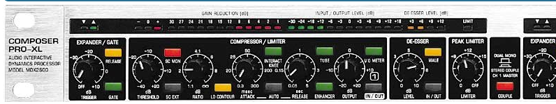

I have a love hate relationship with Behringer. The picture is the left half of a MDX2600. I have a rack full of these and the 4 channel MDX4400.
1) If I am using this ahead of a digital recorder:
I set the Peak Limiter to just turn on at the point where the recorder distorts. It is fast on/off and is also good for peak limiting for broadcast. Also good ahead of the power amplifiers. I have been asked many times why my amplifier/speakers don't distort and how I get so much power out of them.
1a)On the compressor limiter:
If I am truly using it for limiting then the Ratio is set to max. If I am trying to reduce dynamic range to make the music louder then the Ratio is set to 4:1 more or less.
1b)The attack and release time is very adjustable on this unite. I use auto most of the time. In this mode it has two attack and release times. The slow response tries to "ride the volume" over a time period like if a human turned the volume by hand. The fast response tries to catch fractions of a word and is limited to a small range. By running the fast and slow response at the same time you get the benefit of both.
1c)I like to use Interactive Knee which switches into gain reduction mode softly. Over 3bd range. Not as good for peak limiting but sounds better.
1d)The Expander/Gate is good for removing background noise. The Gate can cause bad effects of not used carefully. It just simply turns off the audio if there no volume. The Expander turns down the volume if there is no audio. Sounds better.
2)If I am live and don't know the program well I some times have one of these on every input.
2a)If some one drops a mic or yellows the limiter cuts in and turns down the volume before I could get there.
2b)The Expander might be set to reduce the volume if the mic is not in use.
2c)What I am doing is having the gain adjusted or each channel, just to get it close. Then mix everything together and pass through one last limiter to keep the power amps out of distortion.
3)For "mastering" a recording:
3a)I usually set the levels for the instruments to be as loud as possible with out distortion. Some time each group of instruments are set to this level by them selves. Then I set the vocals to as loud as possible with no instruments. In the Song, the instruments start out full level. When the voices are added in the total is too much. One option is have the limiter turn down the total. (simple) What I usually do is daisy chain the limiters. So then the vocals come in the instruments are reduced. This way the voices stand out over the background. Between the words the background pops back up and gives you the notes to follow.
3b)In some music you want the drums to shake the house but you need the rest of the instruments to be heard. So I set the limiters to "duck" down the instruments and let the drums come through. It sounds like the drums have the power to drive over the rest of the instruments.
3c)This effect works if you have two singers that sing solo and together. The limiter can force the two back to the solo level.
3d)Yes....probably it adds some bad effects. But the voices stand out and your are so custom to hearing this effect in recorded music that it seems normal.
Sorry I talked too much.

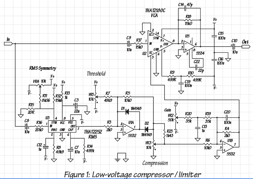

  • THAT_2180-Series_Datasheet.pdf

I have attached the data sheet.
  • BA6110-datasheet-with-SIP-9.pdf

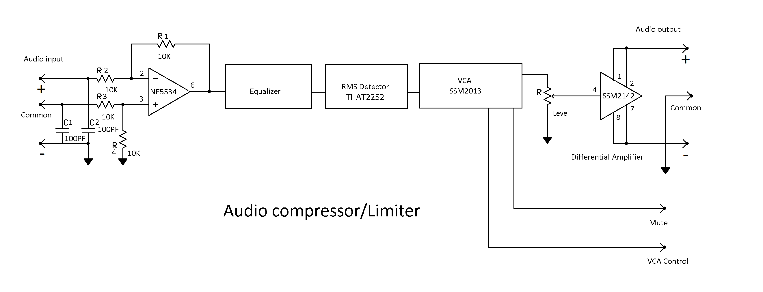

Ok now it's my turn :) : Here I attached a schematic of a professional audio compressor designed around late 90s. It was a gift for me by Elk Ebert (member here). I want to test the device first before experimenting other simpler limitters. Problem is its inputs and outputs audio connection. It has positive, negative and common (three connections) as input and output. I think it was designed for XLR connections.
From this device I want to record audios (Mic preamp> Compressor> Computer). And I want to compress audios and music for my home made toy FM Transmitter (Mic preamp or MP3 player> Compressor> FM transmitter). Then how to handle or what to add for the 3 audio connections (I think I just need two audio connection)? I don't want to poor solution, but want to simply and better solution. :) (I still have not got any chance to learn about 3 connection audios like in XLR, I don't know why they use such, curious)!

Willen, you have the input - and Common mixed up/backwards. The common is ground, the - input is not ground.
The compressor has balanced (differential) inputs and outputs. If an input or output does not have a DC voltage (measure them to see) then use the + input and ground as the input and use the + output and ground as the output.
A balanced microphone input on a preamp is commonly used so that any mains hum picked up by the cable gets cancelled. Maybe the compressor has a very sensitive input for a microphone?

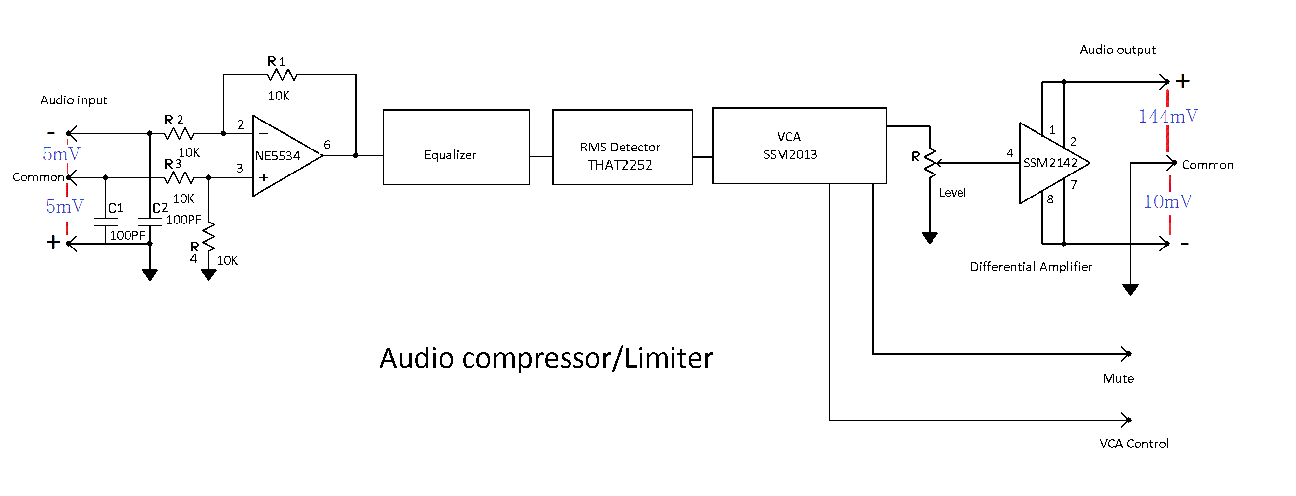

Hi AG,
I turned ON the compressor 1st time today and measured DC voltage around input and output audio with NO audio injected. Here's a diagram. I wrongly marked input audio polarity in previous same diagram. Here I corrected. You can see DC measurements across Common Vs - and common Vs +.
-Ok then what can I do? (description note has a sentence: "input and output are balanced at line level")
-Another: It operates from +15V to -15V dual supply. My SMPS has not good regulated output. Eg. I get +13.5V and -15V out. What happens if we get such different voltage from dual supply?
Hi Ron,
I just want to connect audio in and out with two wires as I am asking above. The device I got is little different than in the 'Design Notes' of THAT Corp. Thank you for the datasheet and design notre though.
The compressor does not have input or output coupling capacitors so its DC voltages near 0V might mess up your signal source and amplifier.
Now you wrongly show the (+) input connected to ground and the "Common" as a (+) input.
When the wiring is fixed then the (+) input and output can be the live audio signals and the commons are the shielded grounds of their cables.
Your SMPS probably is noisy but its different voltages will not matter.
