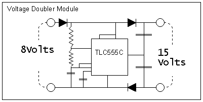

Hi, this might be a dumb question, but is there any way to get 15V out of a 8V supply without using a transformer?

Hmm, have you got any other solutions? I couldn't seem to get that one working in pspice. I need the 15V supply to power an opamp which is part of a circuit that must be very stable. so I need to get a constant and stable 15V out of an 8V supply.

sorry, take no note of the transformer comment. its DC, and Im having sever troubles trying to figure out how to give my opamp 15V off an 8V DC supply.

Maxim has some **broken link removed** that might work for you. They are very generous with samples.
Here goes something. If I were you I´d go for the swtching step up regulator, for a more professional solution. Any way, if you are itented to make a cheap, home made solution this could be good for you. It´s a 555 used in astable oeration followed by a rectifier that will produce -Vp. That´s very usefull in most situation but if you need 15V you could just take -V as you groun refecence and than you´d have 16V between +V and -V.
As I said, it´s not a solution that I´d take in a professional design it´s just a hint for a cheap, home made project.

Heres another hint....
Smitchell, if you think about it all we're really doing is converting DC to AC and back to DC again.
Heres a circuit that may look abit familiar.
