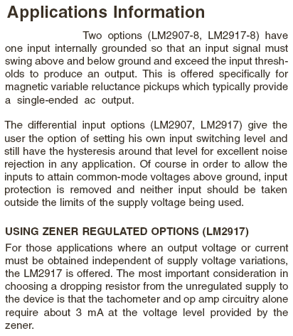

Hi, I'm an undergrad (junior-to-be) EE student with a research project this summer and I was wondering if anyone could help me out.
I am trying to convert the frequency signal of my anemometer to a
voltage signal, but my frequency to voltage chip (LM2907) requires a +/-
15mV swing on either side of the inverting input. My input voltage is
currently 0-5v. I think I need a voltage level shift circuit(?) to shift my input voltage slightly negative. Can anyone help me out with that? Or recommend good webpages (or another name I could look up in my textbooks?)
Thanks Very Much!
You have the 8-pins IC which has hysteresis and its input DC reference voltage is 0V. You could capacitor-couple the signal to the existing IC.
The 14-pins one can have its input DC reference voltage what ever you want.
Here are the notes from the datasheet:
Yes, except the 8-pin ICs were free, and the university beaurocracy didn't have to approve it first. I only have 2 weeks or so to finish what I have.
I'm not sure I understand capacitor coupling the anemometer signal. I wish I had a scanner to show my circuit layout for the chip. But I really just want to know about this "level-shift" ordeal. It's something with transistors to literally shift the voltage (0 = -1, 1 = 0, etc) but I can't find it in my books.
Like I said, use a coupling capacitor for your level shifting.
A coupling capacitor can couple an AC signal from one DC voltage to any other DC voltage.
