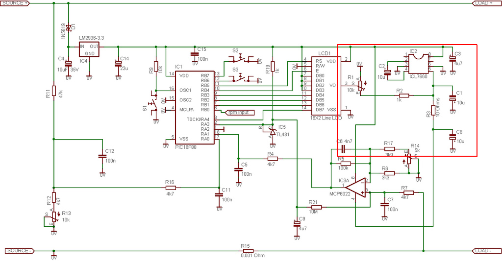

I was building a simple wattmeter using the schematic as shown here
And the ASM code for PIC16F88 here to drive the JHD162A LCD as well.
(The code is on 4 bits HD44780, but is compatible with KS0066 driver used here.)
However after I'd built the circuit, I found that LCD shows nothing.
And I wonder if I had done something wrong on my code or what, or maybe thay said I need some kind of driver "wake-up" for the LCD module?
Thanks if you can help.

Have you selected a PIC type for this conditional compile..??
Also
Have you adjusted R1 the 'VO' contrast pot so that the pixel blocks are just visible.

Thanks for your reply....
May i know what do you mean by PIC type?
I am using MPLAB IDE to compile and burn it to PIC....

hi
As you are using a 16F88 , then remove the semi-colon from the start of processor PIC16F88
; processor PIC16f870
processor PIC16F88
I have tried to compile your code using Oshonsoft, it reports it cannot find the
include LCD.asm file
Have downloaded this from the wattmeter site.??:)

A quick look at the circuit shows that the VO contrast line is connected to a -V supply.!!
I assume that the LCD is HD44780 compatible, if yes, the VO should be settable to 0V thru to +5V.

Please confirm the type of the LCD.
Also what the Source and Load lines are connected too.?
you mean connecting the VO to the +5V instead of 0V?

The LCD i use is JHD 162A with 16 pins...
i'd searched thru the internet that its controller is KS0066 driven ..
Well for the source, I use the 9V battery and the load can be anything resistance ...
P/S: The source "-" and 0V is connecting to the same rail at the negative terminal of the source.
I have looked at this JHD pdf.
What I was concerned about was the fact that the PIC is running from 3.3V and I am not 100% sure if the JHD will work at 3.3V.???
Did the code that you posted compile without errors.?

Been looking at the JHD specs, it has a Samsung KS0070B controller, which suggests a +5V nominal supply voltage.??
EDIT:
Using the posted assembler code for the wattmeter and lcd in MPLAB for a 16F88 produces 240 ERRORS.!
Did you say you have compiled this code.?

Well, yes, i tried to measure the voltage.
I use 9V source supply and I measured the voltage at the Vdd as 1V, Vout around 0.2V.
By the way, I compiled the code using MPLAB IDE and i get this:

I guess there is the problem with the voltage..
but using the pre-existing schematic...
i wonder how can i up the voltage to 5V... sigh..
The KS0066 datasheet shows low voltage operation.!!!!
Why dont you write a simple LCD driver diagnostic program and debug that.:)

may i know the function of the contrast ? using potentiometer?
The contrast setting varies the intensity [light/dark] of the LCD pixels, from OFF [invisible] to full ON [all black blocks].
Set it to give the best viewing contrast for your application.
Well, as you suggest, I tried to diagnostic my PIC and LCD module,
by referring to **broken link removed**.
I am using the PCWH to compile and get the HEX file.

I am using the LM2936-3.3V to drive both the LCD and the PIC.
The connection like this:
From PIC -> LCD
RB0 (6) - DB4 (11)
RB1 (7) - DB5 (12)
RB2 (8) - DB6 (13)
RB3 (9) - DB7 (14)
RB4 (10) - RS (4)
RB5 (11) - RW (5)
RB6 (12) - E (6)
PIC: pin 5 to 0V and pin 14 to 3.3V
LCD: pin 1 to 0V, pin 2 to 3.3V, pin 3 to contrast 10K
However i also see nothing... i just able to contrast at line two. :confused:
