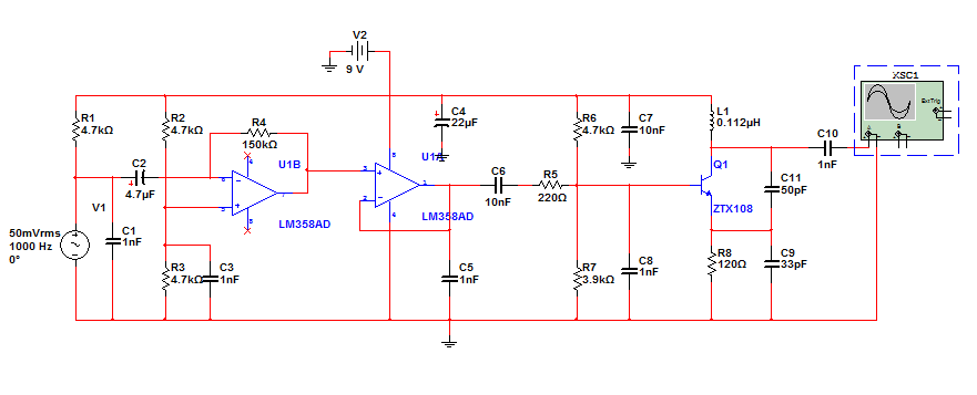

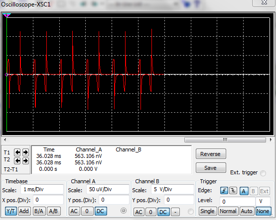

want help in FM transmitter project
maggiemhanna
i have this FM transmitter circuit **broken link removed**
i tried to simulate it on multisim but it's not working
can anybody tell me where am i going wrong

Multisim does not know much about electronics and knows NOTHING about radio circuits.
Maybe you must kick a transient into the circuit to get it oscillating.
Most simple FM transmitters use a Colpitts oscillator circuit, not the Clapp circuit shown here.
Please check if B+ from the battery connects to C4. I can not see the connection.
