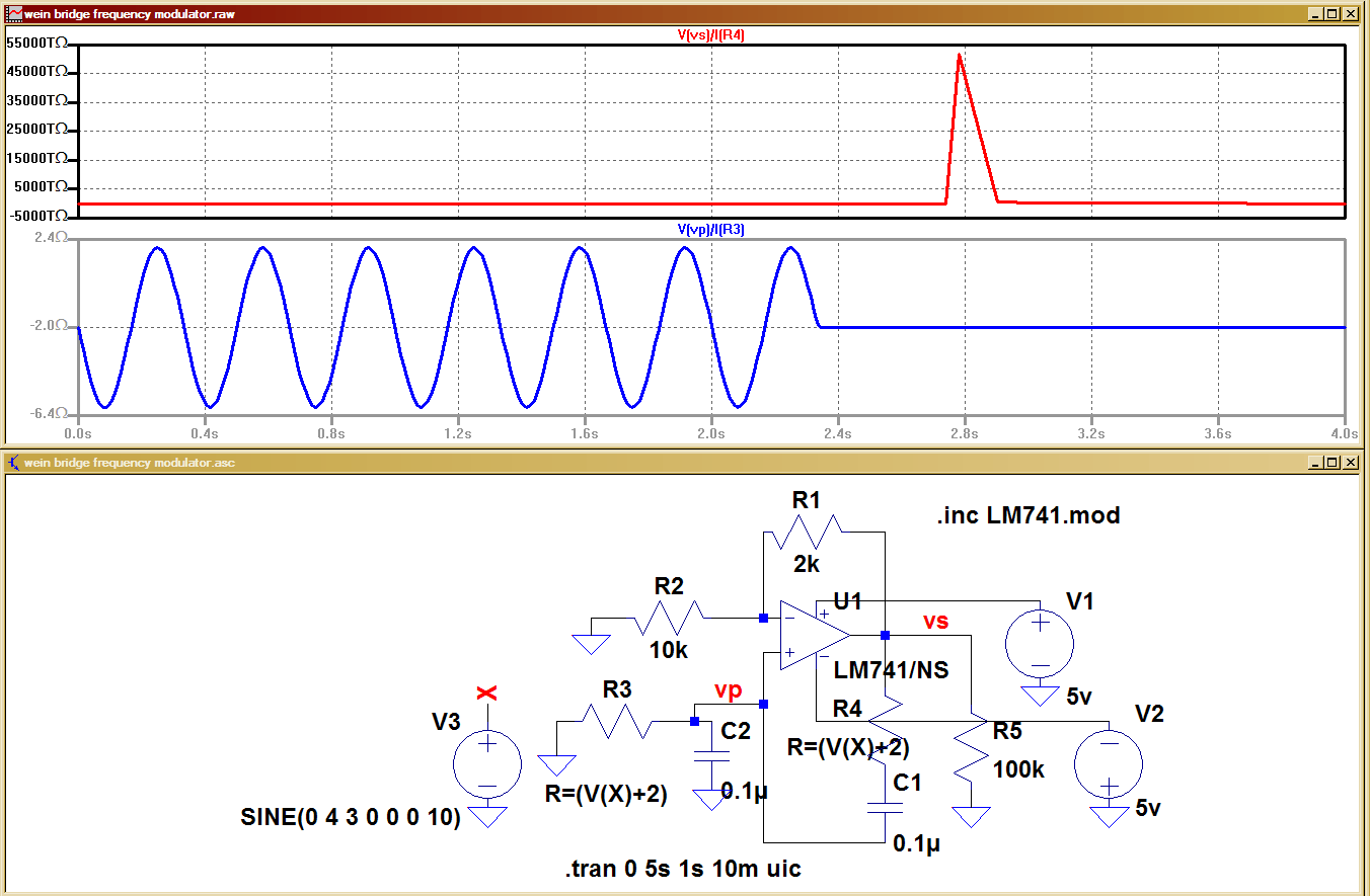

wein bridge with the help of op amp741
how can i make this potentiometer swipe at some freq. it only permits 0 to 100% or 0 to 50% etc...
should i replace VARIAC with some current dependent voltage source.

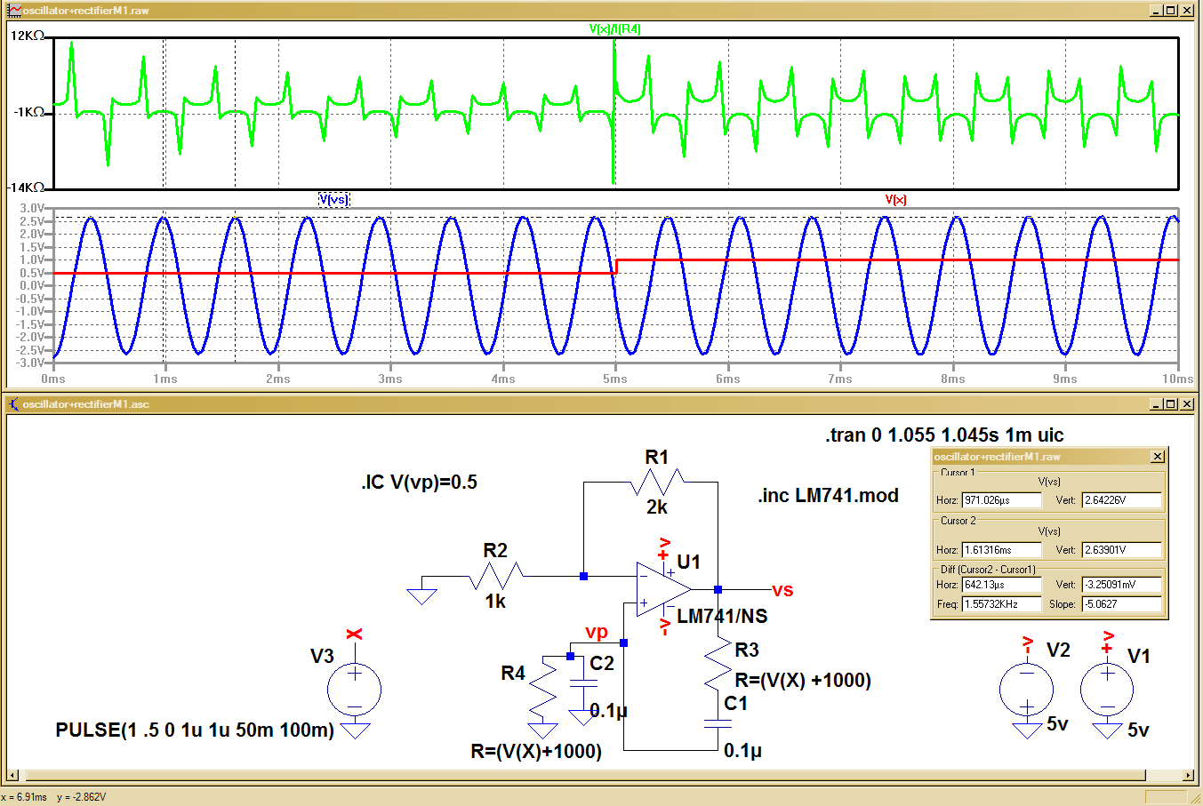

Note your original Wien has 1K resistors at those two points in the circuit.
Change the settings to the ones shown here to give a resistor change of 0.5K to 1.5K
Your value of 2R is too low
Experiment with 1000 and the Sine wave drive offset and amplitude

I did say that due its operating principle, a Wien will be slow to respond to changes in frequency.
I will run your asc file.
EDIT:
As I said the change in frequency is so slow you cannot see it over the plotted period.
Look at these results.

I wanted to build frequency modulator with the help of wein bridge oscillator or any RC oscillator
so we should change op amp to faster LM324.
what is that green graph spikes in your pic.
Its the resistance of R4.... V(x)/I[R4]
