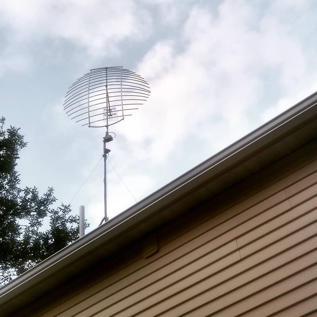

This TV antenna claims -20dB.
Hi. There is a chance that has a loss of 20dB at its back direction (-20dB) but appears more like the minus sign is another very frequent goof from the marketing genius that knows nothing about the product. The forward gain may be +20dB for that parabolic shown. Most of the energy radiated (or collected) is not wasted in other directions, like having a lens/mirror placed near a light bulb.

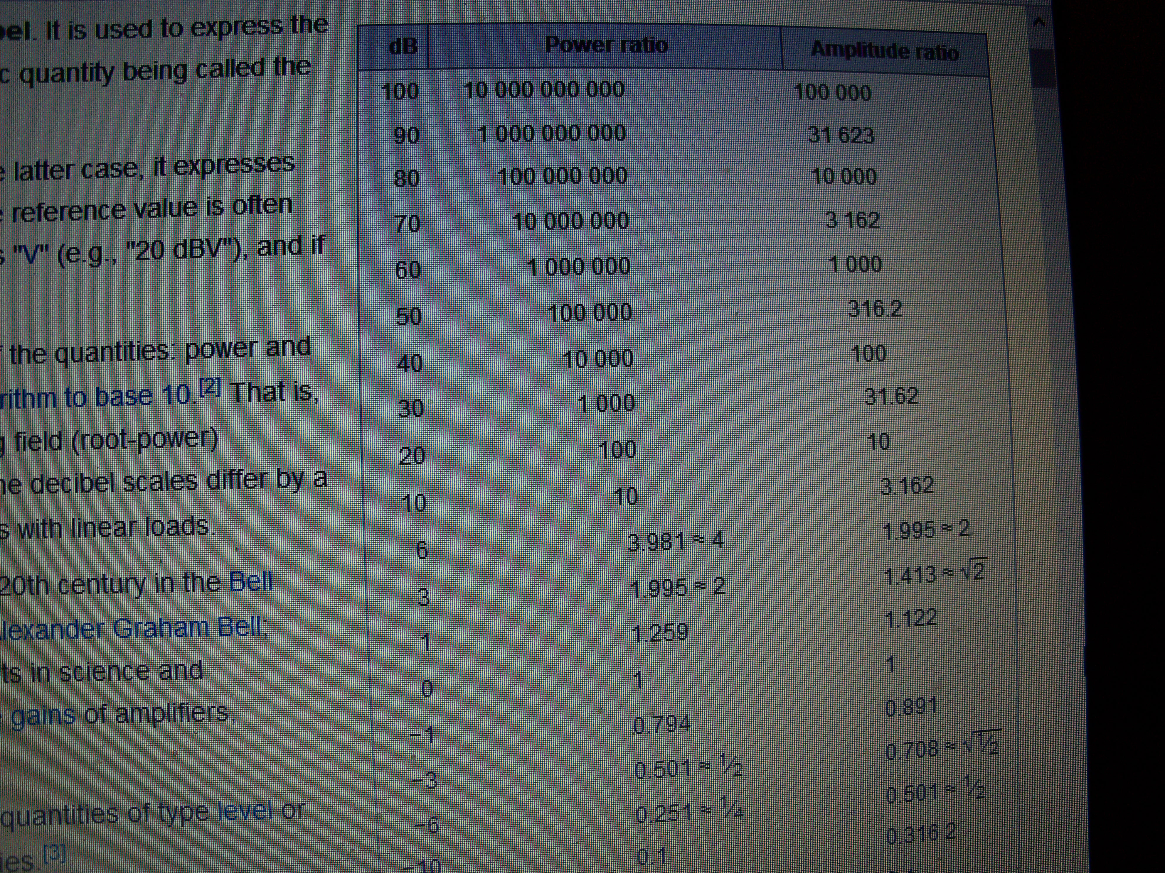

I understand this chart. Every time dB goes up by 10, power goes up by power of 10. 10 dB is 10 power ratio. What I don't understand is how an antenna manufacture can claim their antenna is, 5dB or 10dB or 20dB?

Be aware the chart you understand above shows that a 10 decibel step corresponds to a 10 times power ratio. But not for volts ratio.

Someone on the antenna forum said that the antenna in the photo is -20dB. I think that person made a mistake. He probably ment to say 20dB several people corrected him. So I edited this thread so it is no longer -20dB.
