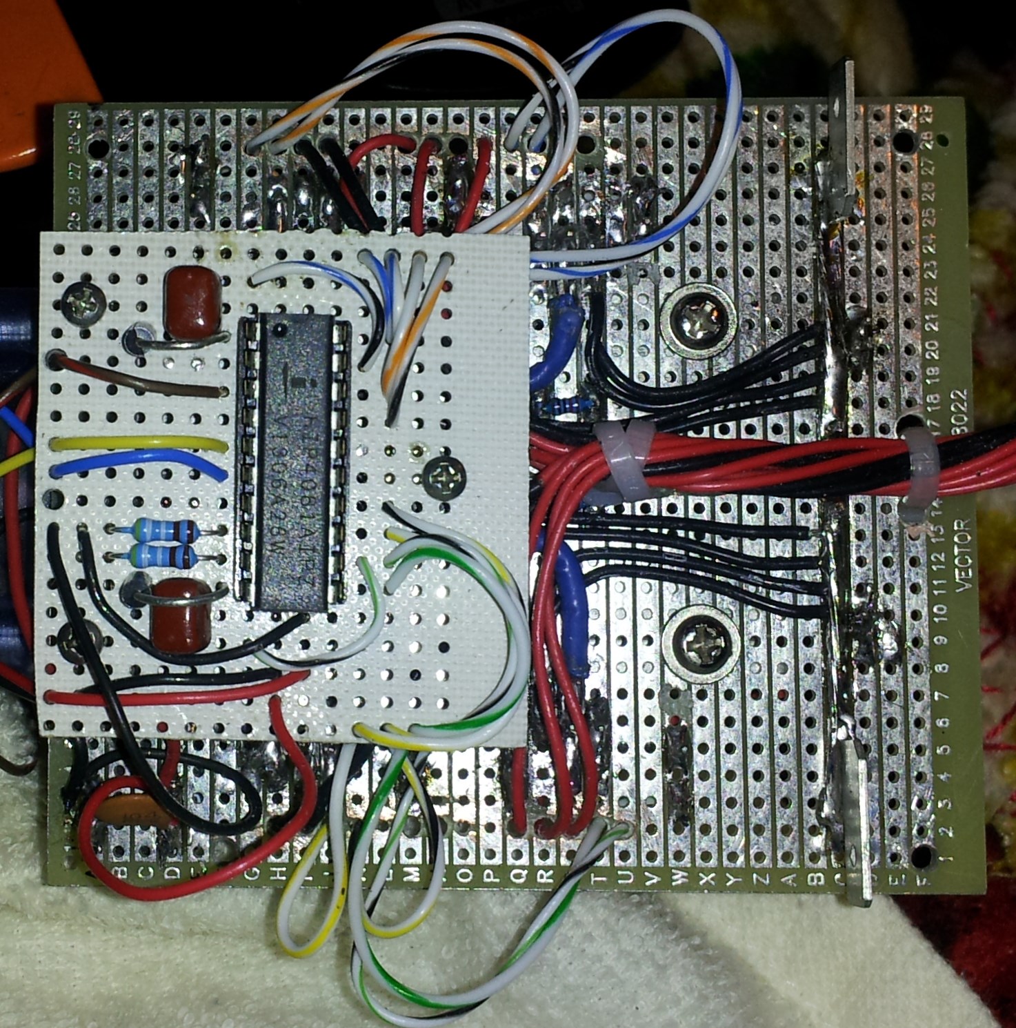

I debated with my self as to whether or not to make this post, I have redesigned, rebuilt and about to test my power steering controller and FET driver, I took so photos, but don't want to burden ETO with them yet, so I put them in dropbox for now, If anyone sees any possible problem, please let me know, I do plan to shorten the wires from circuit board to plug and plug to FETs. One app sheet I read suggested adding a ferrite beads to reduce parasitic oscillations, so I did and another on said to add a cap from drain to gate(I think) but I can't it right now, so I'm not doing that.

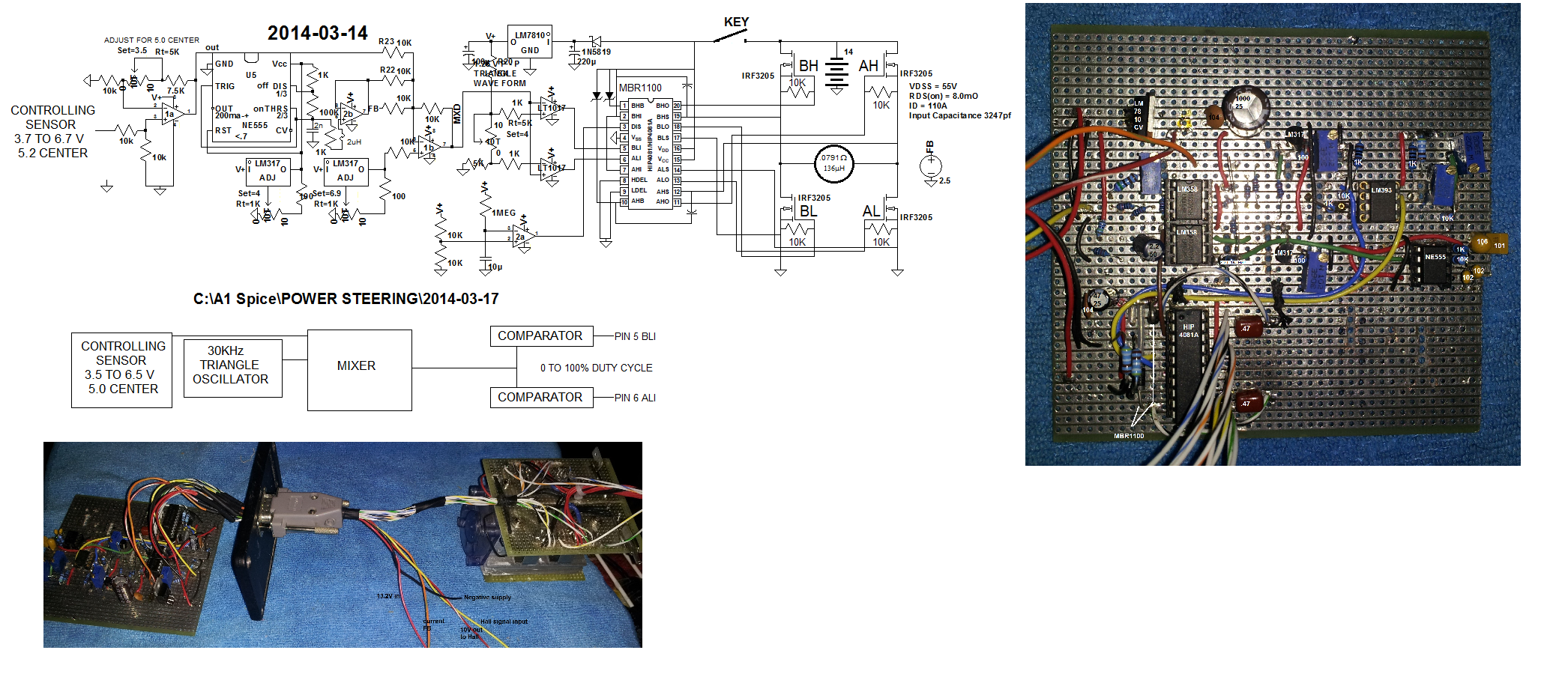

Here is a drawing and photos of what I have, I will take measurement again later with and without the chip.
The reason I think I need the Gate to Source resistor is that while I was working on one part of the circuit, I had the FETs sitting with power applied and notice the supply was starting to show current flow. One other consideration is that the FETs will have power applied all the time, but the rest of the circuit will only have power applied when driving.
cct ?
bridge rectifier is the diode across each FET to protect against inductive kick back.

It may be toast. But having said that. Als and Bls should not be at 10 volts since they should be tied to ground at the source of the lower transistors.
A couple of observations:
See fig. 32 for the power on reset. Or better yet use the 4080A

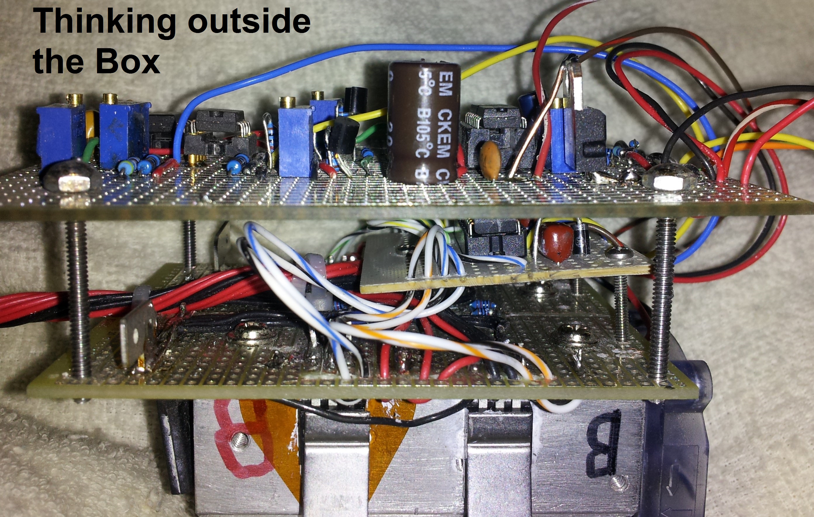

The long wires from the HIP board to the FETs probably won't work. I would build the HIP on the same board as the FETs and have the wires between the comparator and the input to the HIP.
Add a little gate resistance - maybe 12 ohms.
When things are working you won't need gate to source resistors. Maybe while you are debugging 250k so they will be off with the HIP disconnected.
Maybe put a resistor where the motor normally goes or a while.
What about the inputs, what I have is two separate signal that vary from 0 to 100% duty cycle. Both signal start at 0% , one goes up in duty cycle % and that drives my motor in one direction which pulls the signal back to 0% then the other can do the same or the first can repeat, but the signals always go back to 0% and must pass through 0% to reverse, and one of them is always at 0%
I did shorten my wires, BUT, I had to think outside the box, THAT's a PUN20140320_104756.jpg

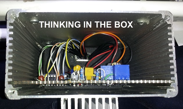

20140321_194540.jpg thinking out side the box.

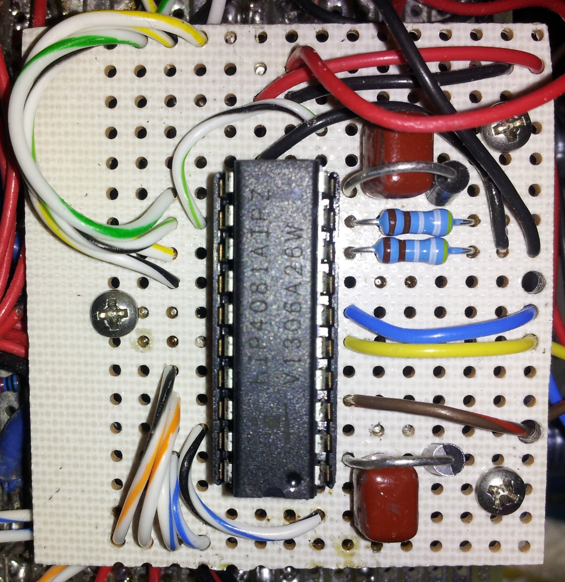

Still not working, but you may have pointed out my fault, using 2 power supplies, one to act as the KEY and one to act as the battery, I haven't tied the ground/negatives together, which could not happen with a vehicle. I checked the voltages again and they were the same +/- , and with out the chip , the 13s stayed 13+, inputs 5&6 stayed .202,4 stayed 0, 8, 9, 11 - 14 & 17-20 were 0.
That's much better. At least everything is off instead of everything being on. Lot less smoke.
The output should follow the inputs. In other words if BHI is high BOH should be high. Since AIH BIH are tied to +12 both AOH & BOH should be at the power supply voltage + about 10 or 12 volts.
Assuming you have a HIP4080A and not just a HIP4080. A couple of possibilities:
1-You have a HIP4080.
2- It may not like the 10K gate to source on the upper transistors. (The bottoms don't care)
3- Disable is low.
4- Something else.
It may work with those long wires, but there are a lot of warnings to keep them really short - like 1/2 inch.
So check disable one more time and remove the 10Ks on the top transistors. This is safe since even if they turn on with everything unplugged the bottoms should be off.
PS. what's the voltage on pin 1 now?
Definitely a HIP4081A

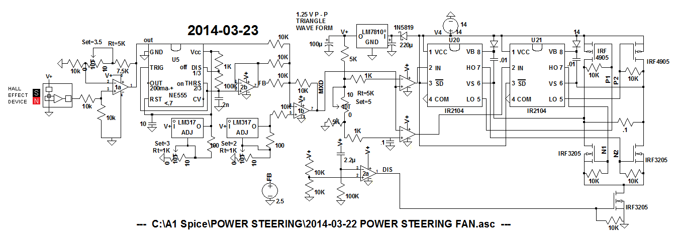

I simmed a IR2104 (because it's the only model I could find) as a FAN7842 and if they both work the same way, I should be good to go. The only difference I see is Pin3, the IR2104 has SD-not and the FAN7842 has LIN
The sim runs beautifully and does just what I want,

Something looks funny. The HO is going to the lower transistors and the top ones are PFETs. I suppose it's possible that works, but I think the gate voltage for the bottoms might be close to 24 volts?
What is the FB signal in the sim? Feedback from somewhere?

FB is the feed back from a LEM hx sp-2 current transducer, starts at 2.50v and goes up or down at 0.0125 volts per amp, instantaneously so it follows the 30KHz frequency and PWM%. Not sure just what I plan to do with it this time around.
