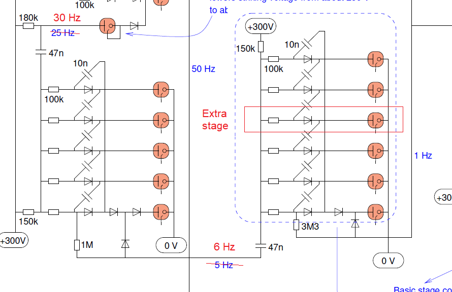

Here is one way of adding an extra stage to one of the divide by 5 counters.
I've added to the one on the right, but you could equally well modify the one on the left. The red box shows where the change is. I've shown the frequencies that you will get with a 60 Hz supply.
