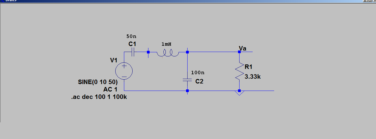

What is the cut off frequency of this LC and RC combination?

Hi Electrician, I knew why you took 0.707 or rather SquareRoot(1/2).. And no it isn't a homework problem..
Vout/Vin is my transfer function. I need the cut off frequency. The cut off frequency is the -3 dB point; In terms of voltage that is the point where the output is 70.7% of the input which means Vout = 0.707 Vin ;And 0.707= Squareroot(1/2)
So I can equate the transfer function like this Vout/Vin = Squareroot(1/2)

Collect terms and you will have:
V1*(s C1) + Vx*(-s C1) + Va*(0) = 1 The 1 here is the test current.
V1*(-s C1) + Vx*(s(C1+C2)+1/(s L1)) + Va*(-s C2) = 0
V1*(0) + Vx*(-s C2) + Va*(s C2 + 1/R1) = 0
Solve these equations for V1, Vx and Va using whatever method you like. I inverted the matrix of coefficients and the voltages V1, Vx and Va are the first column of the inverse; columns 2 and 3 are not needed. Form the expression Va/V1. Substitute numerical values and the rest follows.
I wasn't able to download mathematica, but wolfram alpha does have some features, so does anyone have an idea how I can input this matrix and find its inverse in wolfram alpha; if that is possible? I can't input the matrix like a normal one because it doesn't understand the term 's'.
You could try replacing the term 's' with 'jw' (i.e. j = i = sqrt(-1) and w = 2.pi.f)

Remember how I ended up with the equations in this form:
If the 3 nodes along the top of the circuit, left to right, are labeled V1, Vx, Va, you can write the 3 node equations with a TestCurrent of 1 amp applied to the input:
(V1-Vx)*(s C1) = TestCurrent
(Vx - V1)*(s C1) + Vx*(1/(s L1)) + (Vx - Va)*(s C2) = 0
(Va-Vx)*(s C2) + Va*(1/R1) = 0
They can be put into matrix form and then they look like this:
example1-png.74197
These equations could be solved by a linear equation solver, or by using Cramer's rule, or by brute force substitution and elimination; it's the student's choice. The result is then a column vector of the voltages at the three nodes when a current of 1 amp is injected at node V1:
result-png.74198
However you could just as well inject the current at node 2, and solving would give the voltages at node V1, Vx and Va. The setup would look like this:
example2-png.74199
If you were to do that you would get some voltages that are irrelevant to the problem at hand, but it could be done.
Now, with this next setup you are solving for all the voltages at the three nodes, with a 1 amp current injected into node V1, into node Vx and into node Va, all in one setup. The result is a 3x3 matrix; it's the same result you get if you just invert the admittance matrix:
example4-png.74200
The first column is the result of the injection of 1 amp into V1. The second column gives the result of the 1 amp applied to Vx, and the 3rd column gives the result of 1 amp into node Va. The second and third columns are superfluous to the problem at hand, and we ignore them. It's that first column that you want.
Now the (1,1) element of the inverse matrix is the voltage at V1 when 1 amp is injected at V1, and the (3,1) element of the inverse is the voltage at Va. The inverse is a Z matrix and the ratio Va/V1, the desired transfer function, is given by Z(3,1)/Z(1,1).
Some may argue that taking the inverse and getting two extra unneeded columns is overkill. This is the 21st century and computing power is everywhere. Even my HP50G calculator can invert the matrix in a second, using only a few milliwatt-seconds of energy. Formulating the problem as a matrix and taking the inverse to get the desired Z(1,1) and Z(3,1) elements allows a very compact, quick and elegant solution to the problem.

After trying much to get this data fit into wolfram; I got this f~= -3.30566-1.90852i and more solutions in this wolfram link:
Have I made any errors and how do i proceed to get my frequency 3300 Hz??
You don't want to do that. You want a numerical solution not involving the roots of polynomials.
If you go to Wolfram Alpha home and type in "find roots", then click on where it says "use as a general topic instead", you'll get some description of what you have to do to get a numerical solution.
I tried to make it work with Newton's method using this:
"using Newton's method solve |((8*i*C1*C2*f^3*L1*Pi^3*R1)/(1 - 4*C1*f^2*L1*Pi^2 - 4*C2*f^2*L1*Pi^2 + 2*i*C2*f*Pi*R1 - 8*i*C1*C2*f^3*L1*Pi^3*R1))| = .707"
which becomes "using Newton's method solve |(363*f^3*i* Pi^3)/(625000000000000*(1 + (363*f*i*Pi)/2500000 - (f^2*Pi^2)/ 78125000 - (363*f^3*i*Pi^3)/625000000000000))| = .707"
when numerical values are substituted.
This should work, and it did find a solution of f = 1954.22266 + 1670.835 i
This is indeed a solution, but we want a solution where f is a pure real number; no imaginary part allowed!
I'm going to leave it up to you to flog Wolfram Alpha and see if you can make it work.

I know why it doesn't work anymore, and so does the OP. It's not the same circuit he was asking about; that's why it doesn't "work" anymore. The method I described was for his circuit, not for any circuit in general.
He already knew, as did I, that the response at very high frequencies was unity. He even included a plot in the first post. Therefore, it was clear that the 3 dB down point was where the voltage was .707*unity = .707
For your new example of a voltage divider on the output, then clearly we would need to multiply the gain at very high frequencies (which is not unity anymore, of course) by .707 to get the cutoff gain. But that's not what the OP had.
I don't deny that there are circuits where the method to find the cutoff would not be to solve the equation Vout/Vin = .707. In the general case of a simple high pass like the OP has, but where the gain at very high frequencies is not unity, but something else, call it A[sub]∞[/sub], then the equation to be solved would be Vout/Vin = .707*A[sub]∞[/sub].
You keep bringing up examples that are different from the circuit the OP wanted to analyze. For his circuit, the reason for and use of the factor sqrt(1/2) was understood by the OP, and I knew this and saw no need to digress from the answer to his specific question.
