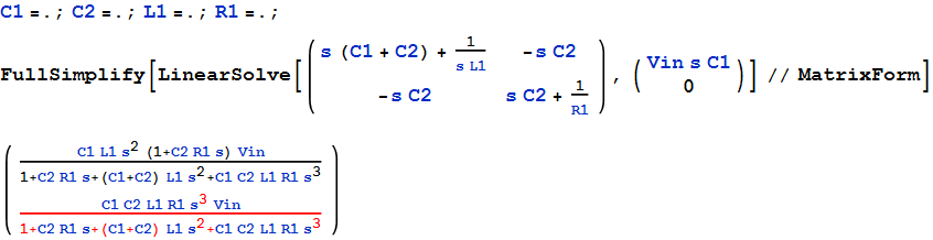

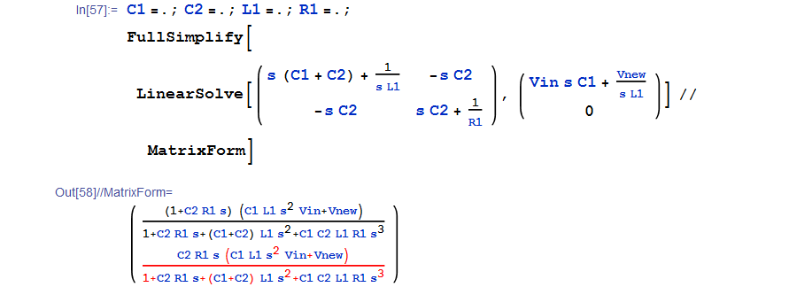

Hi Electrician,
Regarding your matrix formation, I have one clarification. What if I had a voltage source Vnew in the Leg with the inductor as well? What will I equate this to - (Vx - V1)*(s C1) + Vx*(1/(s L1)) + (Vx - Va)*(s C2) = ??? Should I look into per unit values and stuff?
And this term: Vx*(1/(s L1)) will change to (Vx-Vnew)*(1/(s L1)) right ?
Are you saying you want a transfer function involving the old input (which was V1) plus a new Vnew at the same time? If so, this complicates things somewhat.
The best thing might be to use a linear solver instead of inverting matrices. This technique could also be used to get the transfer function of your original problem like this. The original Y matrix is changed by removing the first row and column. This is equivalent to grounding what was the V1 node. Let's use Vin to represent the old input voltage. We inject a current into the Vx node equal to the voltage Vin divided by the impedance of C1; that current will be Vin/(1/(s C1)), or Vin*s*c1. If we do this, we get the same transfer function as before. The desired result is the (2,1) element of the result vector; I've added some red to help identify it.
show1-png.74292
Now, to have both inputs at the same time we add another current to the injected current. This current will be a current equal to Vnew divided by the impedance of L1; this will be Vnew/(s L1). Then we get this result:
show2-png.74295
