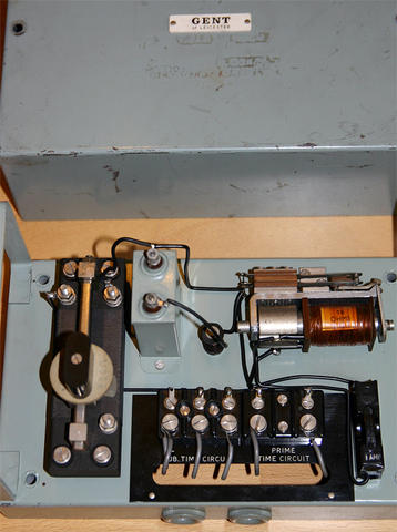

All I wanted to do is sort of replicate a Gent relay box 'see photo' these are 24 supply 250ma but with a variable rheostat for adding and taking away slaves do this x 3.

The Gent Relay box!!

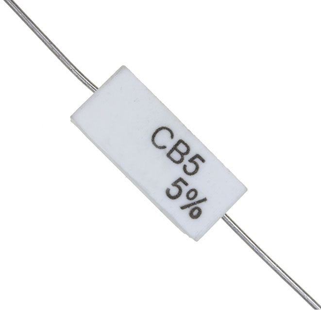

The Maplin R's are 3 Watts ideally you should get 5 Watt R's
They look like a rectangular white ceramic ( I see if i can find a web photo or i make one for you )
Nice relay box, have never seen one of these before.

The ceramic 5 Watt resistor looks like this.

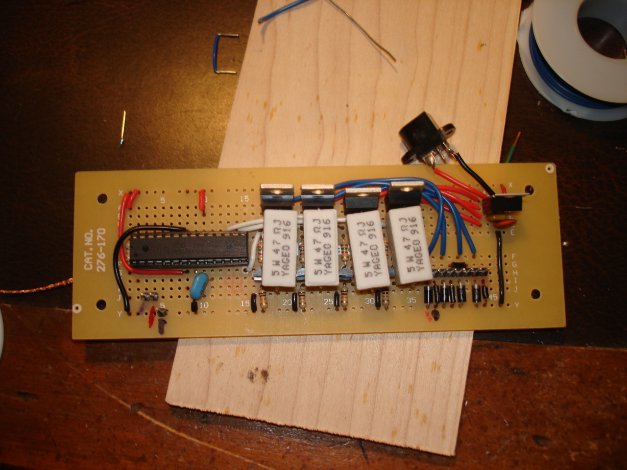

Gent Relay box is quite std equipment but mainly used in a changeover circuit.My seconds Gent master ought to have one for the slaves to operate from their own supply but me being me and like most other I adapted a gpo. 3000 relays and it works a treat.
