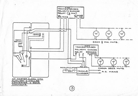

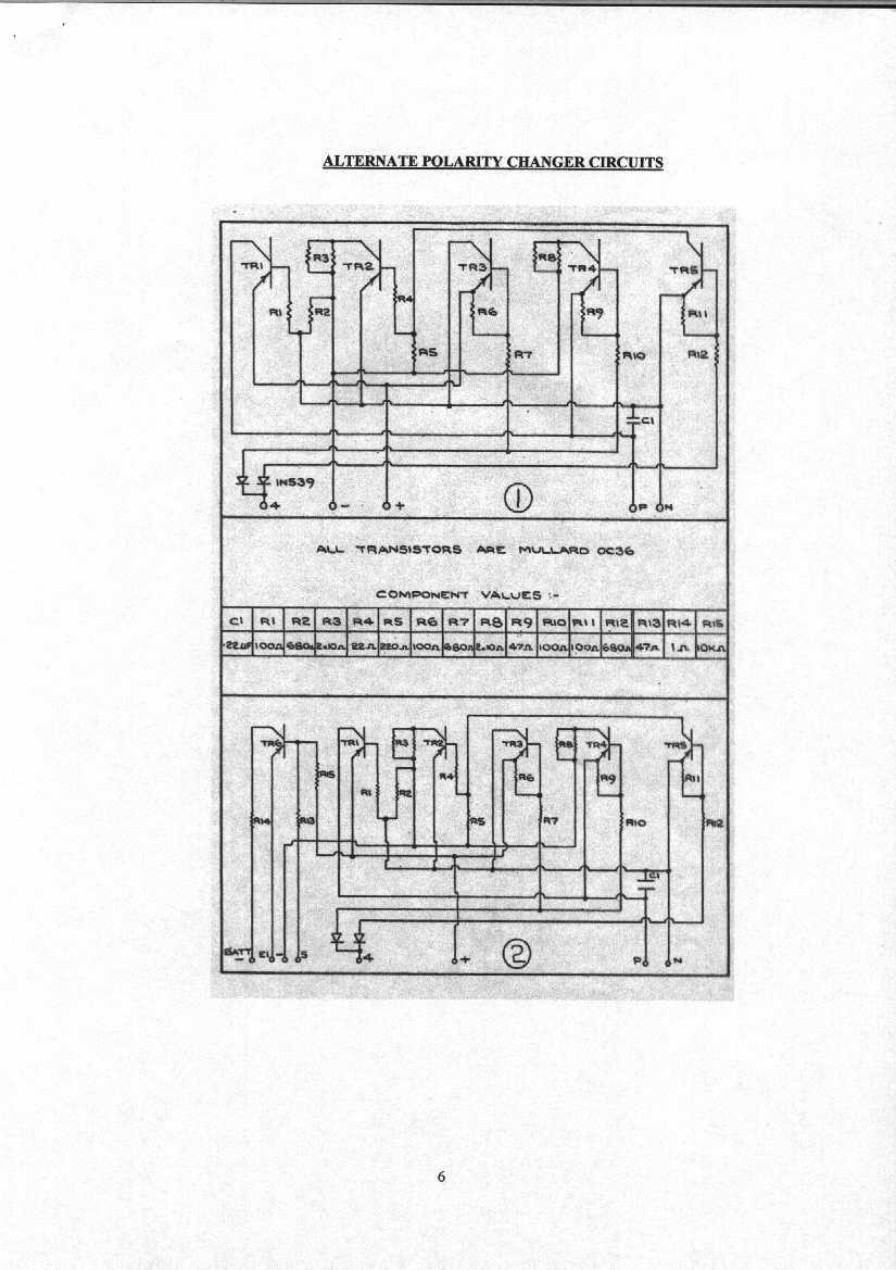

What about the 5 transistor circuits each need 24v to run? see attachment for circuit 5 circuits liker this in the panel (no1)
Not forgetting all of these have one supply terminal at the very bottom of the panel.
See other dwg. for how these are wired in.
Total V's to supply the whole unti?

Interesting hadn't seen the second drawing in our prvious correspondence.
That indicates that the seconds slave clocks are in parrallel.
I doubt it that those clocks are 4 Ohms and 250 mA ( definitely not on 24Volts )
I will have a close look at those drawings, hope they print out to full A 4 size.
Hi Mark, can you please email me the second drawing on as big size as possible please, pref. A4
My eyes aren't what they used to be so I can work the connection drawing it out.
Cheers
Raymond

Circuit analysis
Hi Mark,
I did manage to get the drawing bigger in paint, and work out a possible option as far it appears logic to me.
From the transistorised polarity changer:
Terminal 4 appears to be a control terminal from the Gents GPO and receives 30 seconds or 1 second impulses ( upper or lower schema )
The negative is connected to the negative of the 24V accumulator, direct for the seconds clocks and via the GPO for the 30 seconds clocks.
The positive is connected to the positive of the 24V accu, direct for the seconds clocks and via GPO for the 30 seconds clocks.
The P and N terminals are for the 24V slave clock string respectively
With your multiple clock controller which can control 10 independant clock strings of many slave clocks each, it looks that you have to jumper the terminals.
From left to right
1.--e.g. from master to the 4's
2.--negatives
3.--positives
4.--not jumpered and control one or two slaves for testing
5.--not jumpered and control one or two slaves for testing
Basically you can use one or two drivers to test matters out but can expand up to 10.
Ensure that the bipolar clocks are 24 Volts or at least have a 1 to 2 k.ohm coil value. Not 4 ohms which would yield in 6 Amps at 24 volts and probably burn someting out.
Hope it help,
Raymond

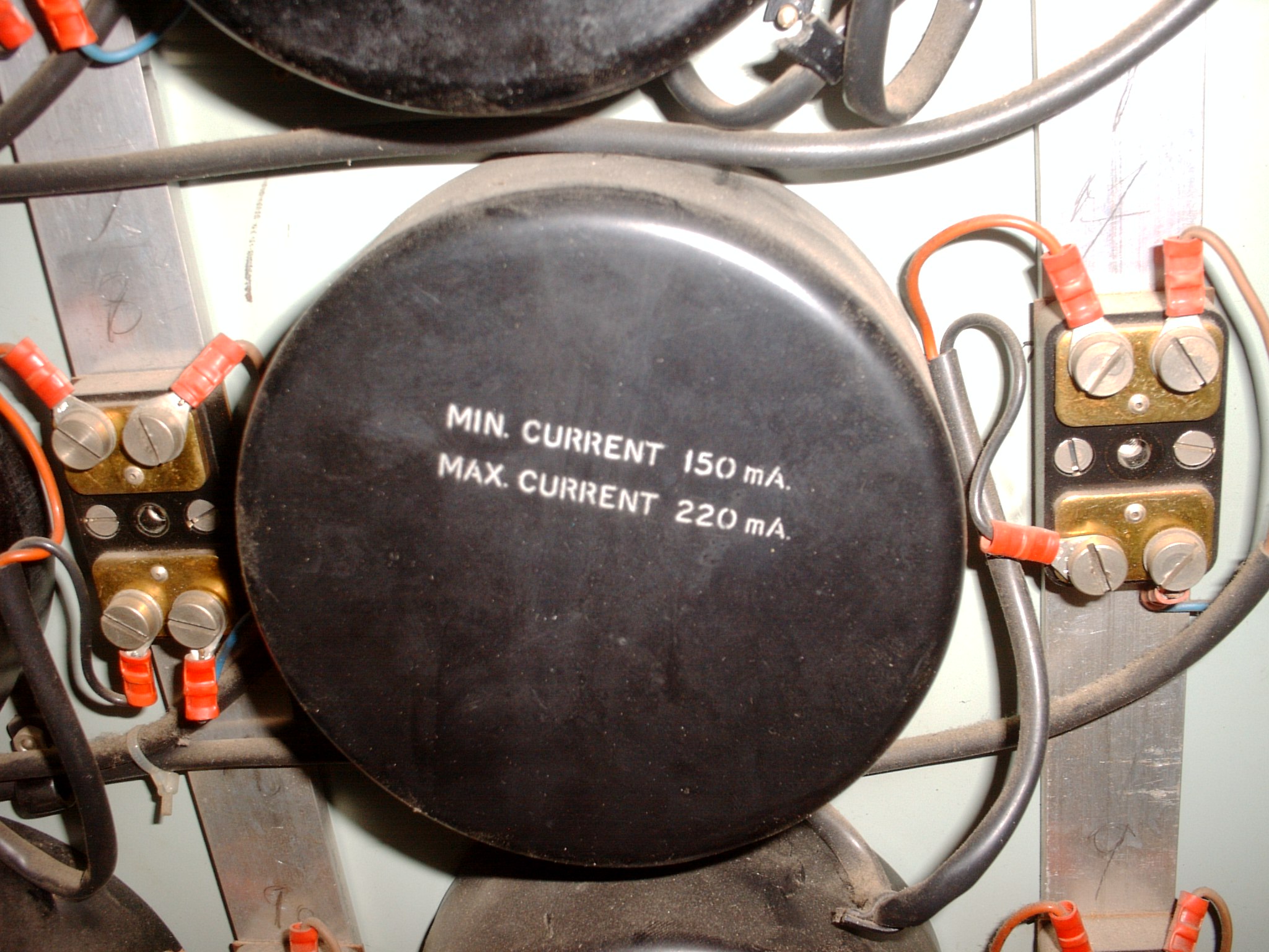

Hi Ray
Not tried anything yet,,, as had to do other tasks, I got in trouble from her indoors!!!
But are you saying that the pilot slave within the panel won't run without enough load on the external Parelle circuit???? As you will see on the VID. that the external (Aux) have a +/- terminals 12 of each... So are you saying connect a 150-180ohm R to each of those parallel outputs to draw more load????????
Brain freeze!!!
Mark
Hi Mark,
That is the way I look at the schematic, which indicates that the external slave clocks are run in parrallel on 24Volts.
There is nothing mentioned about the pilot dial, although it is current operated at between 150 and 220 mA.
What is the actual resistance of the pilot dials coil ?
The dummy R needs to be connected on the same terminals as where the slave clocks go. ( P and N )
Regards, Raymond

Hi Ray
Sat with laptop on knee and just got your reply..I think that Mother Nature will eventually have a PC. introduced into the Human body!!
I can see that the external slave are to be in Parallel!!! The very bottom terminals slave outputs although marked +/- will in fact come from P/N
I was disappointed about the detail on the Schematic and the fact no pilot dials were drawn in and this is why I was left confused...... Not hard!!!
The pilot coils It seems to me are series value coils at 4ohms usually Parallel are much bigger??????
I have to get some 5watt R's probs tomorrow then I will do the tests putting them.
Another point!! sorry!
You will also see another question on the vid. I had was about the pilot slaves about why the terminals has screw in washers that could be added thus bridgeing the terminals on each slave!! this now I think explains the reason..as these are in series with the external slaves removing one would render that supply line dead!! so the washer effectively bridged the contacts so the supply could flow...... am I right?????
Cheers!!
