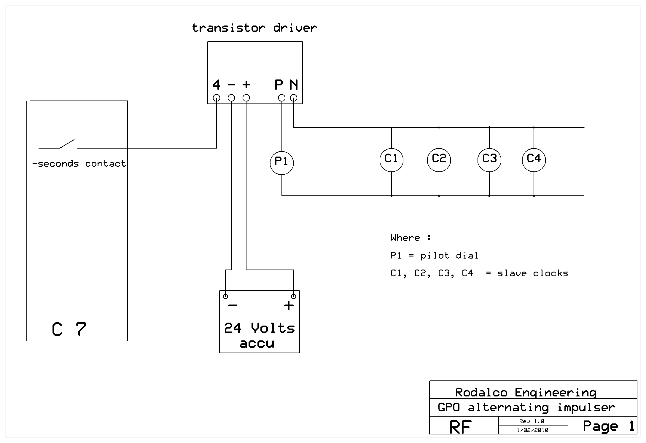

just have re-drawn the schematic for the seconds clocks with the pilot dial inserted.
This is for the seconds clocks, as for the half minute clocks the wires don't go straight to the accu but via the C 7 clock's contacts.
Hope it makes it a bit clearer.
The 150, 180 ohm dummy Resistor goes in parallel with the C1-C4 slave clocks.
Regards, Ray

Unfortunatly a my quick supply shop ....Maplins does not have your sugested R's Closet is 7w 220R
Cheers
7 Watt is 220R fine, current about 110 mA, just add a couple of 24 Volt slaves to get near the 150 mA's. or get two R's of 220 R in parrallel which give you 220 mA loading.

That makes perfect sence mate!!! why they couldn't show this I don't know!!
Cheers!!!!!
Hi Ray
You beauty!!!! :)
Just got the pilots running in the panel ;-)
I had to more of the 7w 220r in the terminals to get enough draw on the current.One line 3 I added a resistor and two 3000ohm slaves and they worked fine but nothing from the pilot.I added 6 more resistors to 6 more outputs but had to adjust the current and the Volt's to get a min. of 150ma. and Bingo it worked!! I got a response from the pilot and the aux. slaves..
