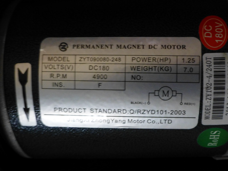

Edit: The motor is a PMDC 180v 1.25Hp motor from a treadmill that was working ok but the frame was broken so scrapped.

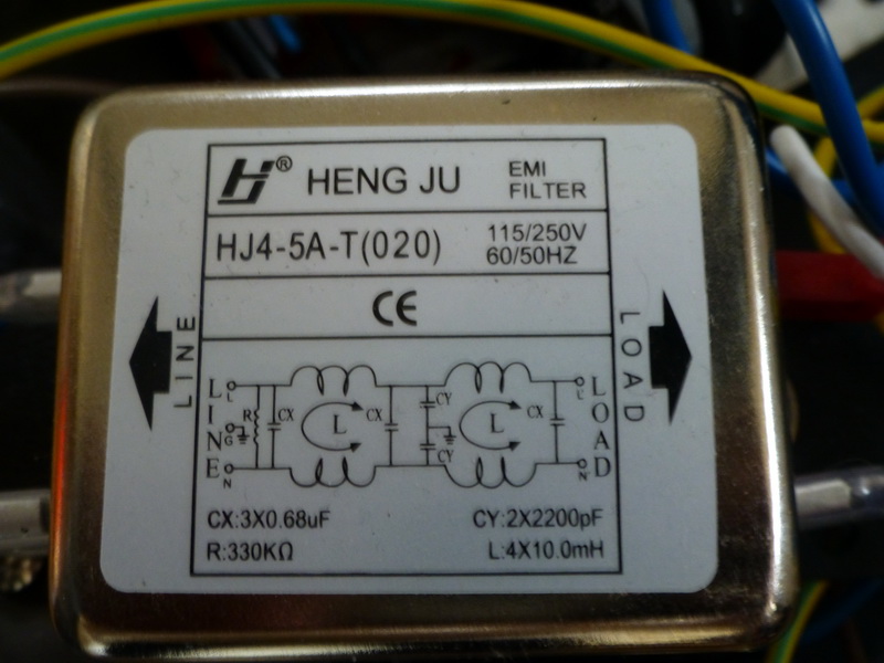

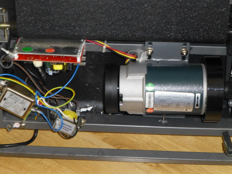

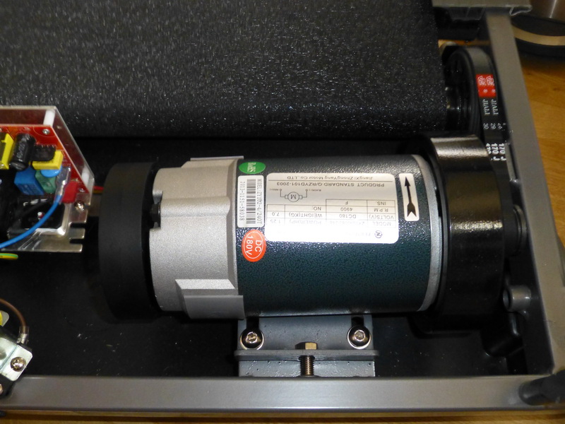

Here are some pics, the tin box is an EMI filter, I didn't notice it said that at first.
Al

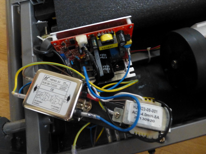

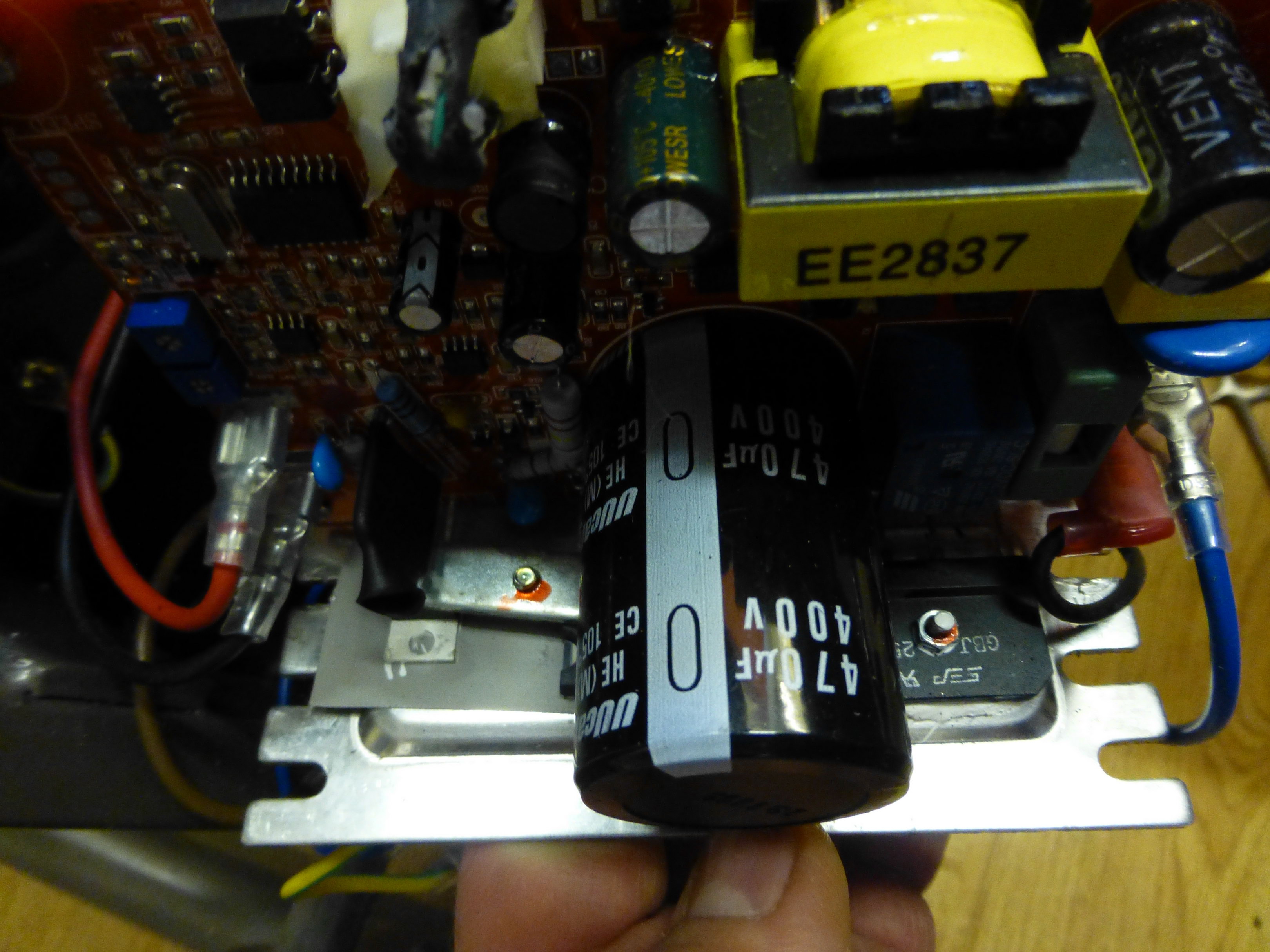

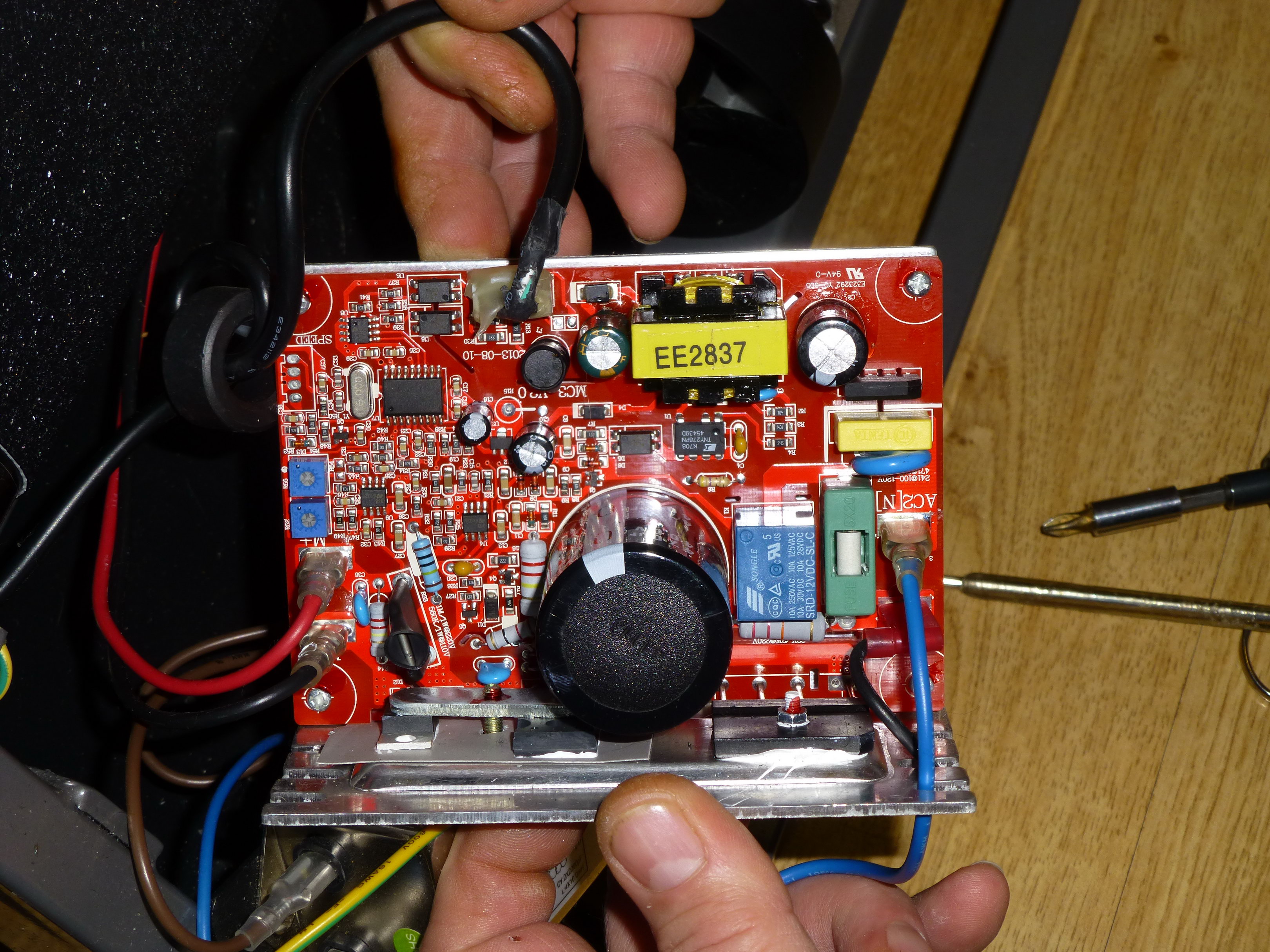

Make sure you mark all the wires and remember whats connected to what. You may want to make a diagram.

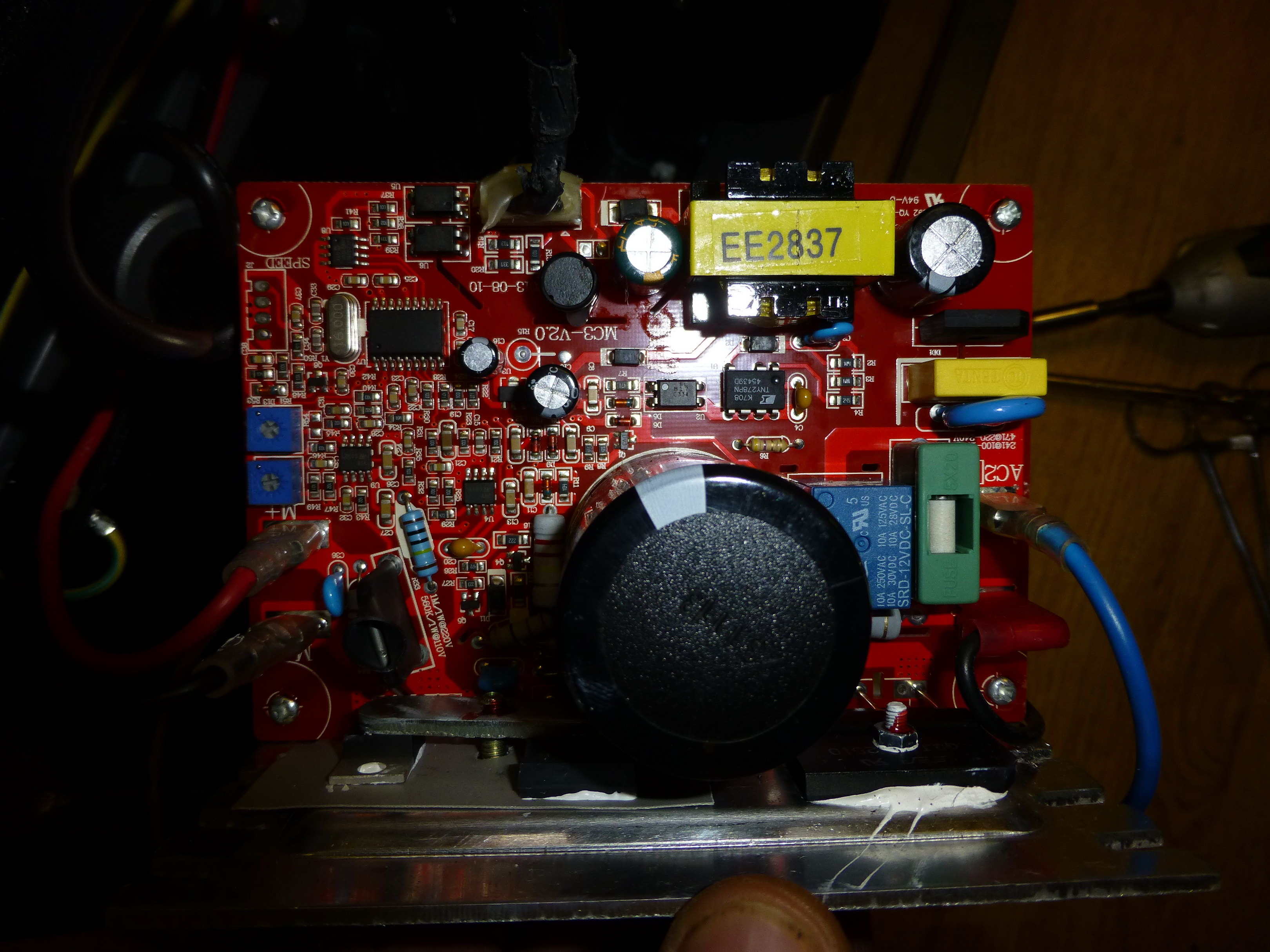

Hi 4pyros, here are some pics, left as big as possible for clarity.
Al

looks like a standard off the shelf motor controller.
Are there any other markings on it, part numbers or manufacturer?
Hi Mate, do you mean on the board or the machine itself?
The machine is dynamix but it seems like a generic model just badged for them to me. Probably loads more with the same innards.
Al
Either on the board or the metal around it. Its called an open frame motor controller.
I've been searching for numbers and only found the actual model of the treadmill - YT-3134 on the main body tag. The board only has the legend E323292 YQ-005 in the corner above the standard 94V-0.
On looking for clues from the components I see what appears to be an 18pin Soic that I assume to be a Microcontroller of some kind running at 16Mh, maybe a PIC, it has a regular old memory chip connected to it (24lc02b). The u-controller itself has absolutely no numbers on it as I have seen in other commercial designs just to make the design a little safer.
It seems to me that there is a whole lot of components on the board for the relatively small number of things it does but then again I have little to no experience of these large motor drive circuits so I could be way wrong in my thinking.
I can't find anything on the web about the board or the treadmill (other than ones on ebay) so I am stuck now. Does anyone think it feasible to use this controller for my project? BTW I have tried moving the trimpots full scale and they have an effect on the soft start and stop, to a small degree, but not enough to make any difference to my needs especially since the mill has a 3 second countdown even before the start or stop process begins so the possibility of using the board unchanged seems very unlikely to me.
PS I looked at the IGBT that drives the motor and it is a 40N60A rated at 600v 75A and 3v vce(sat) so it seems that it would be the ideal thing to drive from microcontroller voltages. I could understand a couple of opto isolators and the odd components needed for the micro but the many components on board baffle me somewhat.
Any further thoughts please, Al
Yes use the board. the pots should be acceleration and deceleration. thats what you want.
You will need to experiment with them.
Can you tell from the existing wiring how the speed control pot was hooked up?

Hi Mate, I have played with the trimpots and got the softstart a bit quicker but even then there is the 3 second run up and run down times that I can't change.
As for the speed control, maybe I didn't realise I didn't mention that there is no pot but only buttons to change the speed or select 3, 6, 9 or 12 kph so I cant really use them for a lathe. Something else I forgot is that I would also like an emergency stop that braked the motor if possible? You never know if something is going to get caught or even start a massive wobble with an uneven blank!
