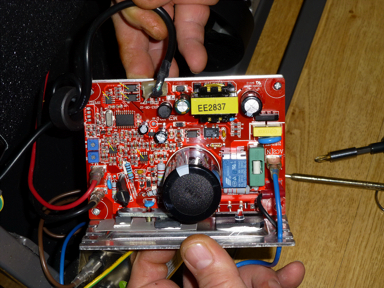

Hi Ron, the very top two 4 legged ones are EL817c 334 that google as opto isolators or photo couplers. All the others are on post #40.
Should I try a pot across the speed pins and if so which way? The centre pin is at 0v with the outer two at about 0.6v.

Strange, I don't see a driver IC.
I'm kind of out of ideas. If I remember correctly you said there were up down buttons for speed, not a pot.
Maybe 4pyros has some ideas.
Be careful working on the board. I think the whole thing may be floating at line voltage.
Hi Ron, I assumed that the Megawin IC was the driver (programmable) on the control board and if the other board has a driver it would be the un-named IC which is also programmable, maybe a PIC or Arduino, both have a memory IC beside them so its a safe bet that they are microcontrollers and surely one of them has to be dedicated to driving the motor?

Your probably right. The problem is understanding how they talk to each other, then to modify that process. Hard to do I think.
Hi Ron, so failing any workable means of using the original board/s what is the best way of doing the job?
I did think at first it would be easy but every time I think I have the solution there is a problem.
For a start I intended just to make a similar circuit to the one posted earlier in the thread but then I realised I would not get any soft start to speak of. So next I thought of using a microcontroller and that does seem to get over most of the obstacles, soft start, A to D conversion from the speed pot and even a number of fixed speeds if I wanted them. Then I began to think that the motor has a largish flywheel and would tend to run on when I turn off, so what about braking?
Thats where I am stumped with how the original board brakes the motor. With the setup and parts as they are how can the circuit accomplish braking?
Can braking be done without some kind of H-Bridge setup to short the motor terminals?
Any thoughts? Al

It is just a fast opto coupler and FET driver in one package. Pretty fancy. :D
Let's check one more thing. What is the other part on the heat sink. I was thinking it was a diode, but it may be the driver.
Hi Ron, The silkscreen says D1 and it does have only two legs so I assumed a fast diode but the markings on it come up blank in google NFC25G 560.
I even tried transposing the 5s with Ss but no joy!
Al

I just found some MOSFET Driver ICs in my parts! I have some MAX626, 627 and 628's and also some MAX4426 and 4429's. Hope they are useful.
PS just wondered would ramping down the PWM before off, have a similar slowing effect as shorting the motor? I mean like a reverse soft start.

We can make one of those work with one of the opto couplers.
The switch like in post 22 might be the easiest for a brake. It could also serve as the on off switch with one more set of contacts. Or maybe a relay.
It might be a good idea to have some resistance in the brake circuit. Lets think about that one.

BTW been tampering with the controls and the speed 3 pin connector does change the speed with ANY pot across it but only at full scale either way and then the speed goes up as it would when holding the +speed button down, and same full scale turn starts the motor slowing, so I am tending to think its just a spare connector for a different but still button controlled machine. The pot certainly seems to act like a switch anyway.
Edit: it is a switch. Touching centre pin to either side momentarily changes the speed by .1kph on the display so the pot idea is off! doh!
Also I think the brake is essential. With all the load on a treadmill it stops nearly instantly but in the outside world this beast takes about 30 seconds to spin down from full (or full on the controller anyway). double doh!! Al ;)
Hi Ron, Just did a brake experiment with some resistors. You were spot on that it would need some mate! From full speed a 5w 10r ceramic judders and knocks the motor to a halt in about a second. After more cautious experimenting I think the value needs to be about 50r and a good few watts, maybe 10 or more.
Anyway its a bit less for you to think about mate, at least the braking resistance is sorted roughly.
Al
