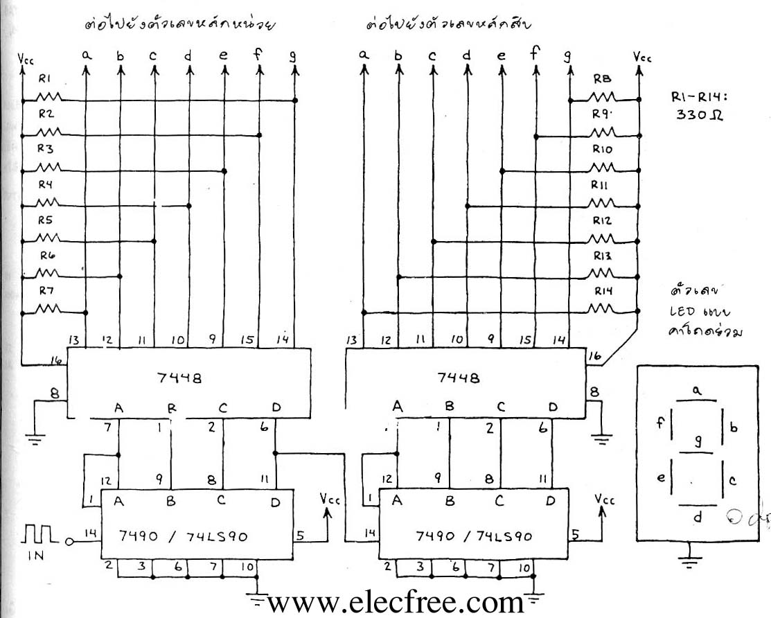

can somebody teach me how can I reset this to 0 when i open it is always start on tt or sometime 88.This is the diagram

Do you want a button to push to clear the counters, or do you want an automatic zero just by applying power?
To reset the 74LS90 you must connect pins 2 and 3 (MR1, MR2) to VCC.
For a power on reset use an RC circuit.
