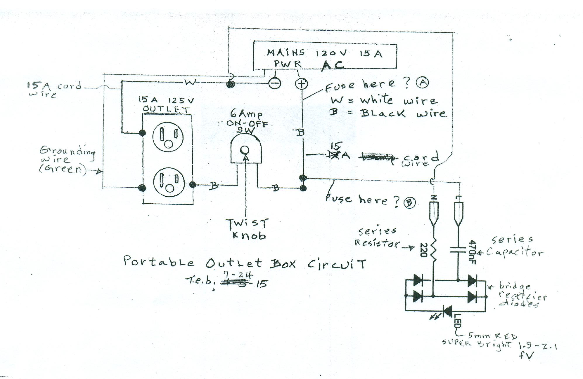

If you are familiar with this thread, you know I'm designing a circuit for a 5mm Super-Bright Red LED. The primary power source will be 120V, 15A , 60 Hz, full-wave AC current, changed to DC for the LED, using a bridge rectifier, with a resistor in series with the neutral circuit wire and a capacitor in series with the hot wire and both of these components connected ahead of (prior to) the bridge rectifier. The LED is in the bridge rectifier circuit of course.
In addition, this led circuit will be protected by a 'Fast-Acting' glass fuse rated for 1 Amp connected in series on the hot wire side, but where exactly in the LED circuit should the fuse be connected ? I know the fuse should go on the hot side, but ahead of (prior to) the capacitor, after the cap or somewhere else in the hot line.......dunno ! :confused:

Misterbenn,
Thanks for your reply re where to put the fuse in my circuit.
Attached is my latest circuit drawing below.
Note, I have indicated two possibilities, i.e. A and B within circles, that I think you mean, but not sure which one.
Please advise.
Thanks,
ToddB74

Hi Todd,
I've not simulated your circuit to check the current ratings and such but from looking at your updated post I have the following comments:
  • Position B is good for the fuse, this will protect the LED circuit. If you were to install it at A it would limit the current of your outlet box to 1A
  • The diodes 1N4007 are fine, probably slightly overkill as you could get away with a lower reverse voltage value, 1N4004 would be fine but doesn't really offer any benefits. With the 1N4007 you'll have more headroom for inductive voltage spikes. So what i'm saying is 1N4007 is fine but if you cant get it anything down to 1N4004 would be ok.
    • the diode has a fuse rating of 3.7 A^2S, this is a measure of the power required to kill the diode in the event of a short circuit for example. You want the fuse's fuse rating to be lower than this so it blows first! You haven't specified the exact fuse your using but looking at other fast acting 1A fuses they have an fuse energy around 1.4 A^2S so this is good.
    • The fuse will increase in temperature by 50 degrees for every watt of energy dissipated. You should check that this is acceptable. Calculate the energy dissipated by the diodes using the forward voltage drop 1.1V multiplied by the expected RMS current (lets assume 1A as thats the fuse rating, although if your circuit works correctly the current will be much less) so 1.1 x 1 =1.1W. Divide this by two as each diode only conducts for half an AC cycle. So each diode will have a temperature rise of 0.55 x 50 = 27.5 degrees. This is absolutely fine but diodes may feel slightly warm to the touch, but only touch them if you've removed the power!
  • We need more details about the capacitor, like the type of capacitor (should be a film type), voltage rating, current rating, frequency response. If you give us a part number we can go through all this. If you are still looking then i suggest searching for X capacitors, these are designed for mains use.
Good luck
**Edit, a few additional thoughts:**
Marc on this page http://www.marcspages.co.uk/tech/6103.htm also notes
There have been reports of people getting a rather large 'sting' from this circuit when used as a 'night light' (not its intended purpose!) when uplugging it from the mains. Reason is, the capacitor remains charged and their hand completes the circuit. The cure is to take two 470k resistors in series (so as to form one 940k resistor) and place this across the cap. This will discharge the cap within a short space of time thus removing its sting.
I just noticed that the values you are using match the ones on Marc's page. I need to point out that his values are intended for 50Hz 230Vac operation so wont translate across. Using these values you can expect about half the current (16mA rms, 23mApk) luckily for you this is almost perfect for the LED you selected.
A further benefit of this is that your resistor will have plenty of power headroom as the resistor power dissipation is related to the square of the current. But still, make sure you get a wire wound type.

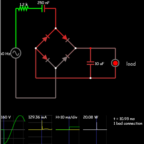

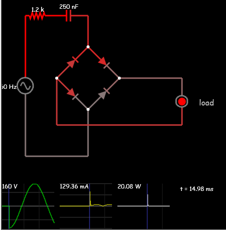

Many "super bright" LEDs are ordinary dim LEDs in a case that focusses the light into a narrow angle. Then it cannot be seen unless it points directly towards you. So you should use an LED with a wide angle.
Unfortunately the series cap alone can cause large currents thru the LED if power is turned on at the negative peak -160Vp of the 120V AC line.
It would be random , but one time it will blow the LED with a spike of 160V/220Ohm or almost an Amp.
You must lower the current and reduce C by 50% and raise R to limit the charge current for worst case turn on. 160V/1k2 = 133 mA peak is still too high for most 5mm LEDs
upload_2015-7-17_18-53-13-png.93351
SHown above is the peak Vin , Peak current to LED and peak power in the resistor.
Note also the Resistor must be WW to handle these peaks not film R and the cap must be X1 rated plastic.
