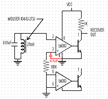

do u all remember this circuit?
at
https://www.electro-tech-online.com/threads/assembly-and-c-language.20867/
this circuit works well.. from the CRO.
when the "antenna" goes near to the LC, the output gives squre wave like what i mentioned on top around 3V. when the "antanna" goes further, the output gives a DC around 0.6v.
i've tried to connected the output straight away to the input of my microcontroller (with common ground!!) but my microcontroller keeps responding to it. my microcontroller is too sensitive.. the input can only be 1 or 0. if it is connected to nothing, maybe the floating voltage causes it to respond.
so, i plan to use a relay because NC gives 0 and NO gives 1 to my microcontroller.
before that i was told to control my microcontroller by counting the on time of the square wave in a certain time. but i can't do it..
sorry for not telling the details.. thanks for helping :D
The output of the receiver should be Vcc without a signal, depending on its input offset voltages. It has a gain of a few hundred thousand which is so high that it probably amplifies its own noise and any noise that is around. It might even oscillate.
If you add a 0.01uF capacitor to ground at pin 3 then it won't oscillate.
When the signal is received then the output of the receiver should alternate between 0V and Vcc at the frequency of the input.
you're right.. when there is no signal.. it gives a very high frequency square wave output. i don't want that squarewave..
is it will be constant if i add the 0.01uF capacitor at that pin and GND?? that's great if yes.

D
But if you connected receiver out directly to your microcontroller, it never sees a floating input. It is pulled up by the 1k to VCC and if the output is low, it is driven to 0.6 volts (also low impedance). No floating input! you dont need a relay as already talked about.
The 0V of the receiver and the 0V of the microcontroller must be connected together. Both should have the same +5V supply.
yes.. they will be common grounded...
i thought, if i connect a capacitor to pin3 and GND, the capacitor will charge and discharge and become a saw tooth wave?? :roll:
Right now, pin 3 has capacitive-coupling from the output pin1. The very high gain causes the circuit to oscillate due to the positive feedback.
A capacitor from pin 3 to ground will ground pin 3 to AC signals.
Use a 0.1uF ceramic disk capacitor with short wires to make sure.
yes, i just tried to connect the 0.01uF capacitor from pin3 to the GND. but it gives nothing at the output., and.. the transistor is build-in in the LM393 right? is there any different if i use a 0.01uF and the 0.1uF??
It is good if the capacitor stops the circuit from oscillating without having an input signal, but it is bad if the capacitor stops the circuit from detecting the transmitter. What is it?
Yes. The transistor doesn't have much power so has difficulty driving a resistor as low a value as 1k at a supply voltage higher than 6V. Maybe a 10k resistor is best.
A 0.1uF capacitor provides better filtering.
