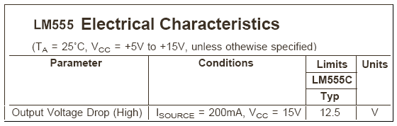

how to calculate that? what is the output if 15V is supplied?
You can't read the datasheet and make a simple Ohm's Law calculation?
The output will go to 12.5V with a 15V supply and 200mA of load. Therefore the total load resistance = 12.5V/200mA= 62.5 ohms. If the wire's resistance is 0.5 ohms then a 62 ohm resistor could be used in series with it. The power rating of the resistor should be 2.5W.
f i drive it in maximum (200mA), like what u have mentioned, the high power will cause heat. will it burn the resistor or wire?
A 2.5W resistor will get hot but still survive. A small resistor will burn out. Extremely thin wire will burn out.

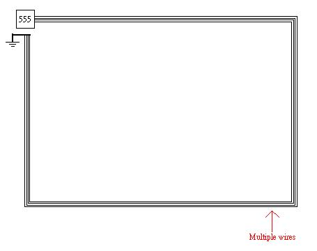

i thought the CAT has many wires inside, and connect them to the output of 555 as shown in figure below :roll:
No, that wouldn't help, wire it so they are all in series, effectively giving a number of turns to the coil.
sorry, i really don't get it. if i connect them in series, that means there is only one wire connect from the output to the GND. can u show me in picture?

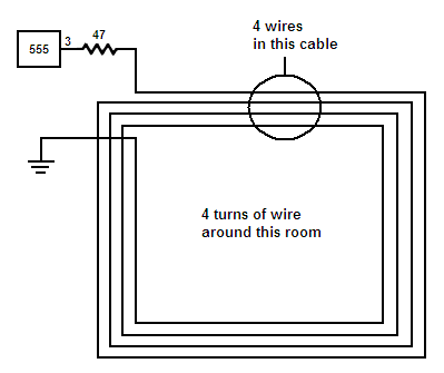

Connect the wires in the cable in series, then the magnetic field from the cable is increased.
thanks!! i understand already. :wink: so i can use only the single core wire to turn for a few round, right?

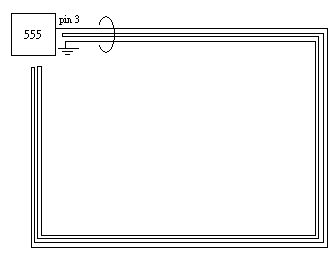

oh.. i found the CAT5 already, actually is CAT6 (that's what available at my place). can i connect as shown in below? just a little bit different.
NO! - that will cancel itself out, wire it as you've already been shown!.
oh! luckily u told me, otherwise i will wire them like what i thought can be done. thanks! :D
Your sketch is missing the current-limiting resistor that should be in series with the loop of wire. The 555 will melt without the resistor because its max current rating is only 200mA, and a loop of wire could be a dead short to it.
yup, i have forgotten to include it.. hehe.
the 555 timer will melt!?!? i didn't know that, it is so serious!! but i will remain the 100R to limit the current, in case the wire cannot support it. since the multiple loop can increase the electromagnetic field :D

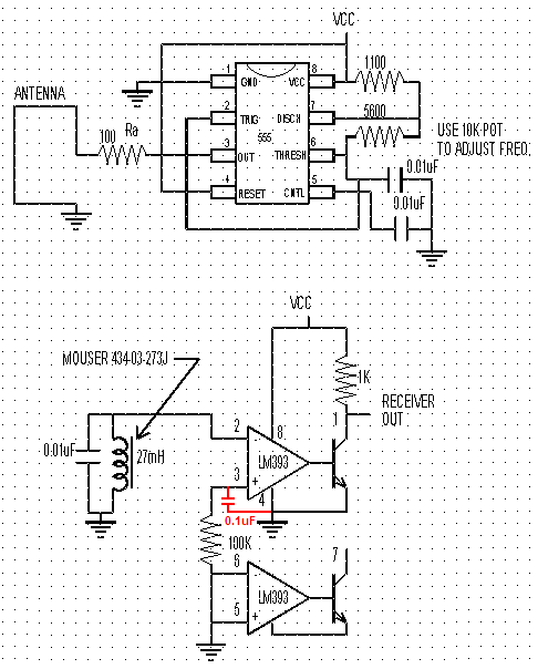

my explaination
hi all,
i'm going to do presentation with this circuit 2 weeks later. if anything goes wrong, correct me ok?
The 555 timer produces a 10kHz(approximately) squarewave output at pin 3 with the combination of R1, R2 and C1. The 'antenna' will produce electromagnetic field on and off in 10kHz.
the resonant frequency of the tank circuit is 10kHz. the 100K resistor creates a gain of a few hundred thousand which is so high that it probably amplifies its own noise and any noise that is around. It might even oscillate.
If a 0.1uF capacitor is added to ground at pin 3 then it won't oscillate. When the signal is received then the output of the receiver should alternate between 0V and Vcc at the frequency of the input. With a 5V supply then the output's min current of only 6mA should be able to saturate good with 5mA from a 1k load.
are these correct? i copied them from urs explaination. is there anything to be explained with this circuit?
edit:
1. what is the purpose of the 0.01uF capacitor from pin5 to GND of the 555?
2. why the 0.1uF capacitor from pin3 to GND at the LM393 can stop it to amplify other noise and its own noise and stop oscilating?
3. what's the different between a comparator and operational amplifier? can a comparator be an op-amp and vice versa?
thanks for helping..
