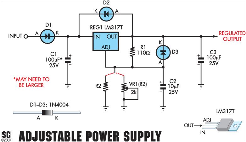

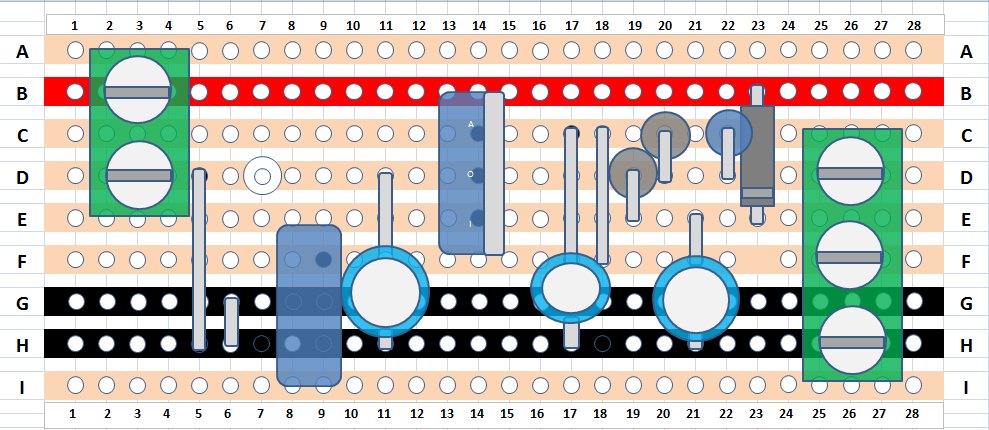

Why can I not get this simple circuit to work?
I am a build by numbers guy who build the most basic of stuff as the rest has me snookered.
For some reason I cannot get this circuit to deliver less than about 10V and I need 9V. Input on the left and the diodes have the strip away from the board. This is the second time I have built the strip board from scratch (differently) with the same result?

What is the input voltage?
What is the output voltage? 10V?
Is the Input-Output = 0.7V? or 3V?
What is the voltage on the "ADJ" pin?

The LM317 works very simply. It develops 1.25V across your 110 ohms resistor which causes a current of 1.25V/110 ohms= 11.36mA. The 1.25V will be part of the output voltage and you want an output of 9V so the pot will have 9V - 1.25V= 7.75V across it and will have 11.36mA in it then its value is 7.75V/11.36mA= 682 ohms. 680 is a standard value.
Your "pot" is 660 ohms so your output voltage should be 1.25V + (11.36mA x 660 ohms)= 8.75V.
Agree but the output is not 8.75V and therein lays the problem, either I have fried the LM317 or I need to check the circuit which I have done numerous time and simply cannot find the problem which I am sure is simply the translation to the strip board, will have to check again.

The voltage from OUT to ADJ should be 1.25. You have 2.25V. Why?
Just measured across OUT to ADJ and it is indeed 1.25V with the R660 / R110 resistor combo.
The regulator has only one purpose in life. It tries to make 1.25 volts across OUT to ADJ.
It sends power from IN to OUT until (OUT to ADJ) is 1.25V. If the voltage is above 1.25 it stop send power.
Your job is to find resistors that give you the right voltage.
You gave me the calculator, Audioguru confirmed it so the values are correct, I am getting the 1,25V.
I have tried from R10 and burnt my fingers to 10k and I cannot get the voltage below 10.75V
There must be a fundamental problems on the strip board, will check in about 15min.
I hang my head in shame:oops:.
The eye loupe uncovered a poor joint on the R660 resistor, eyes not what they used to be, especially at night.
Many thanks for taking the time out to assist.
