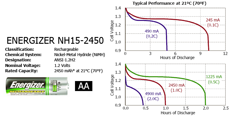

I have a portable LCD screen rated at 12VDC 8W. I measured the current with an amp meter and it came in at 400mA. I assumed I would be able to power the screen with 10 rechargeable AA 2400mAh batteries for about 5 hours.
Wrong! The batteries last no more than 40 minutes before the appliance switches off and the power supply is exhausted.
I then tried 12 AA batteries and measured the voltage at 16.4 volts. The appliance only lasted 50 minutes before switching off. Measuring the batteries afterwards I was still getting 14 volts but there still isn't enough power to switch the appliance back on.

I don't know how accurate the NIMH model I have is but when I simulated 12 cells in series in LTSpice and the run time with a 35ohm load which is about ~400ma continuous the battery doesn't drop bellow 12 volts for almost 5 hours. The current has to be going somewhere. Or they're not being charged fully, if anything else is going on I can't explain it. Are you absolutly sure the charger you're using is actually fully charging them? How are you measuring their charge state? No-load voltage is just about useless for NIMH capacity checks.
Simply look at the curves on the datasheet of the battery from a battery manufacturer.
Energizer's new AA NI-MH cell can supply 490mA for over 4.5 hours before its voltage drops below 1.2V. It can supply over 2A for almost 1 hour. It is rated at 2450mAh.
The "new" ones can hold a charge for months.
