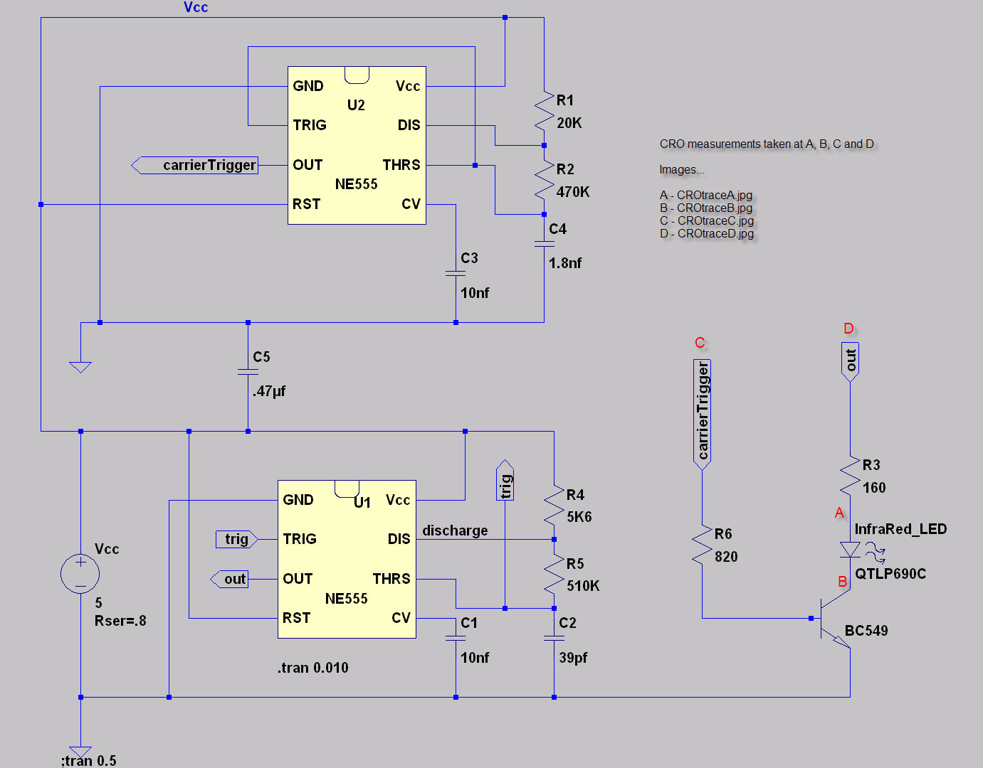

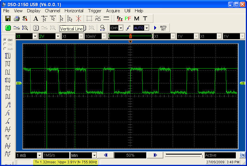

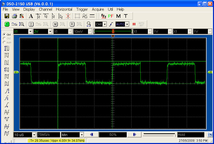

I've downloaded and installed LTSpice as per a previous members suggestion. I've uploaded a visual of the circuit, which now has 2 555 chips - the first just gives a frequency of around 36KHz, while the second one turns this on and off at a frequency of around 833Hz. If this signal is correctly generated, then I expect to see the ZD-1952 output go low....that's the theory anyhow.
The circuit diagram (with some comments) is Circuit.jpg. I also ran a simulation and by measuring at point A, got the output shown in SimulationTrace.jpg. Pretty cool, but only theoretical of course!!
So then I went and built my circuit using the same spec components I'd used in the model. The results are not too discouraging, but certainly not as accurate as those in the model.

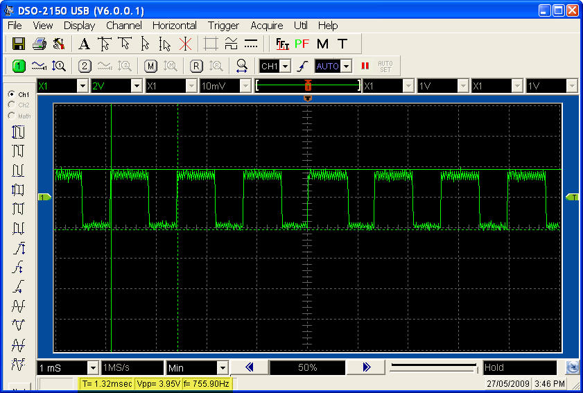

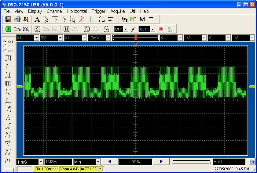

I measured the frequency output at 4 places as shown in the circuit diagram. The results of those measurements can be found in their respective jpeg files, e.g. CROTraceA, CROTraceB etc.
I guess the most obvious differences are
1) both frequencies are lower than expected. Instead of 833Hz, I am seeing around 755Hz, and the expected 36KHz is actually 34KHz. I suppose the latter is close enough though.
2) The duty cycle of the 833Hz frequency is nowhere near symetrical.
There is also quite a bit of frequency still coming through during the 'off' period - this can easily be seen in the screenshot signalTransition.jpg.
Anyhow, although I am still frustrated in my attempts to get the ZD-1952 recognise my signal, this has been an interesting learning experience.
I suppose the bit I find most challenging/frustrating, is that I don't know how to easily vary the frequency...at least, not without going through another calculation for R1, R2 and C1...which takes me way too long. I have experimented with a variable cap, but this resulted in the frequency changing in one direction, only to come down and go in the other, and only slightly. Apart from getting hold of a sophisticated signal generator, I'd appreciate any advice on how to 'tune' my circuit so that it emits the signal carrier expected by the ZD-1952.
I guess you have used a lousy qualitity cap. :)
I agree, some cheap ceramic capacitors can have a huge voltage coefficient.
Try replacing the capacitor with a higher quality film capacitor and it should be more stable.
